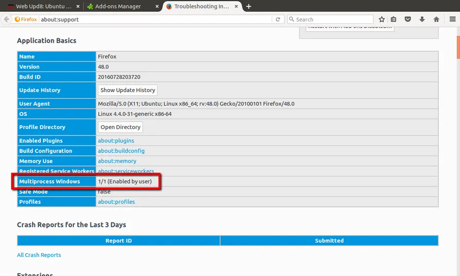

New releases of Firefox comes with the setting where we can enable multi-process windows for the browsers. See the following screenshot:
492_1_image001

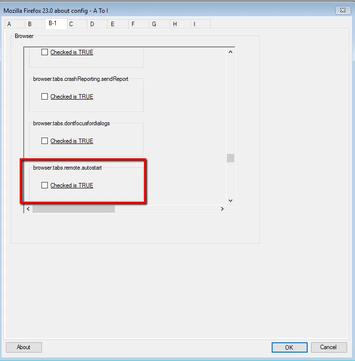

The above screenshot means that its enabled and you should expect the Endpoint Policy Manager Browser Router will have problem in routing. To make it working please disable the setting using Endpoint Policy Manager's pre-configured Pak for Firefox about:config as illustrated in the screenshot:
492_2_image002

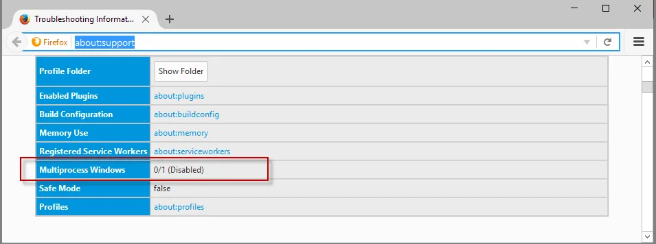

So once you check and uncheck the above option it will set the value as false like shown in below screenshot:
492_3_image003
You should be all set for now with Endpoint Policy Manager Browser Router. Let us know if otherwise.
