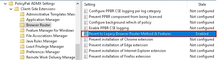

Step 1 – Step 1. ONLY if using the following PolicyPak Client-Side Extensions ADMX setting set to Enabled, (aka Legacy Browser Router mode), OR if Client-Side Extensions version 2535 or older was ever installed on the machine.
141_4_image-20210104150503-1

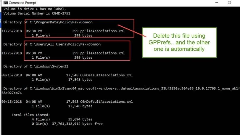

You have to delete this file first…as a one time action using GPPPrefs if
141_5_img-04

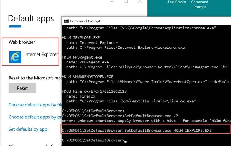

To do this.. we found a utility, which you can likely DEPLOY ONCE via Endpoint Policy Manager SCRIPTS on the USER side .. (we didn't test that, and only tested it manually on the user side)…
http://kolbi.cz/blog/2017/11/10/setdefaultbrowser-set-the-default-browser-per-user-on-windows-10-and-server-2016-build-1607/
(Endpoint Policy Manager makes no warranties about this tool.)
When it runs.. it works instantly.. and sets the default browser. In this example, we set it to IE.
And then it was later changeable by the user.
141_6_img-05
