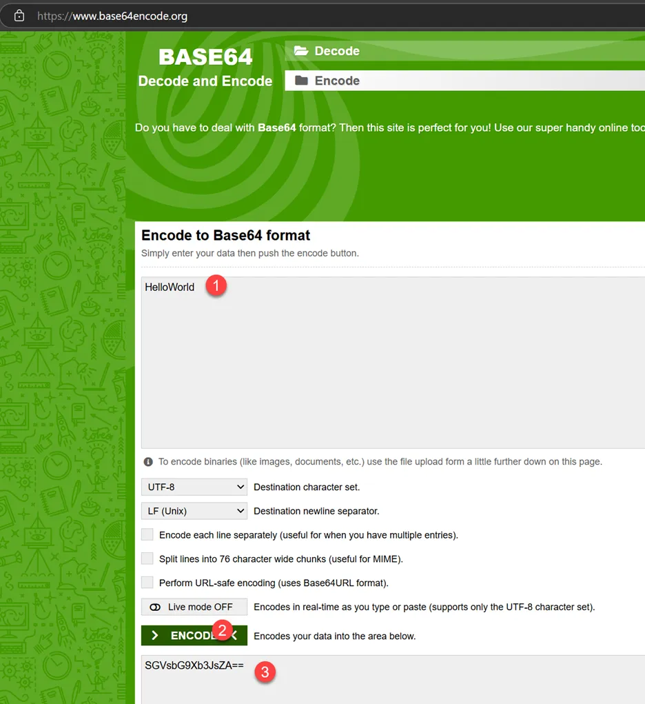

Example Password
If you use the password “HelloWorld” and Base64 encrypt it, you will get SGVsbG9Xb3JsZA== as the result. You can use an encoder like Base64 Encode, shown below.
base64format

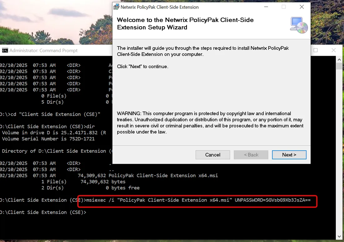

  • msiexec /i "PolicyPak Client-Side Extension x64.msi" UNPASSWORD=SGVsbG9Xb3JsZA==
  • The password must be provided as a Base64-encoded string
  • If a password is set, CSE cannot be uninstalled without providing the same password
See the interactive example shown in the screenshot.
csewizard

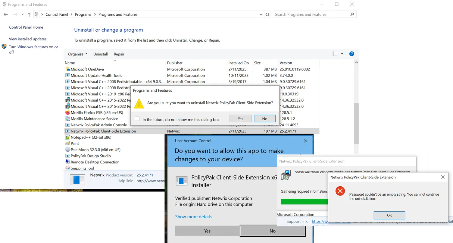

If you try to uninstall the CSE by hand without a password, the following error message is displayed.
cseuninstallpw
Uninstall CSE When a Password Is Set
If an uninstallation password was configured, it must be provided during the uninstall process.

  • If the correct password is provided, CSE is uninstalled successfully
  • If the wrong password is provided, the uninstallation fails with an error, and CSE remains installed
  • If no password was set originally, CSE can be uninstalled normally without requiring UNPASSWORD
  • If a password was set but UNPASSWORD is not provided in the command, the uninstallation fails with an error

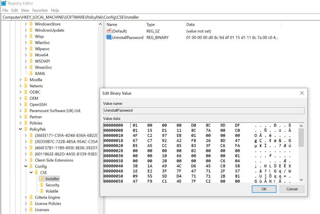

Storage and Security
The password is encrypted and stored in the Windows Registry at:
HKEY_LOCAL_MACHINE\SOFTWARE\PolicyPak\Config\CSE\Installer
Registry value details
  • Type — REG_BINARY
  • Name — UninstallPassword
The password is encrypted with the Windows Data Protection API (DAPI) and not in plain text.
editbinary
This registry key is protected and accessible only by Administrators and the Local System account. The password cannot be copied to another machine. If the registry value is transferred, CSE will not recognize it on a different system.

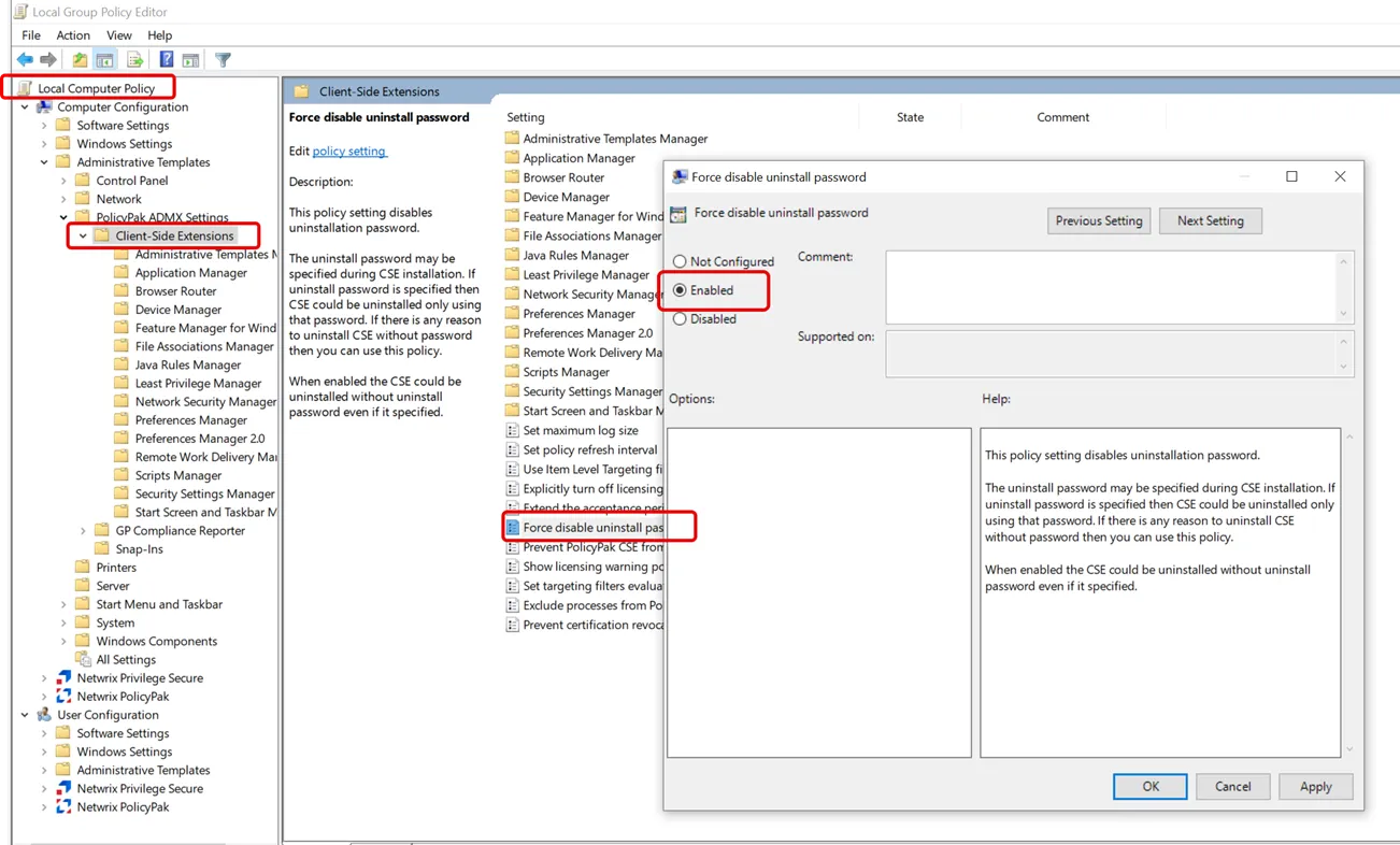

Emergency Uninstallation without Password
As an emergency method of uninstallation, you may use the Endpoint Policy Manager ADMX Troubleshooting files which contains a policy named “Force disable uninstall password”.
See the Troubleshooting with ADMX files topic for additional information about the ADMX troubleshooting files.
When this ADMX setting is set locally or targeted to a machine, the CSE will uninstall without a password.
disableuninstallpw
CAUTION: Again as stated in the introduction of this document, someone with access rights to change the KHLM part of the registry or use the Endpoint Policy Manager ADMX files could circumvent the password previously set earlier.
