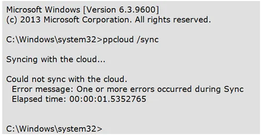

To test the connection between the client and service, start by entering the
PPCLOUD /SYNC
command from the command line. If the return message is Could not sync with cloud,
the Netwrix Endpoint Policy Manager (formerly PolicyPak) Cloud client cannot communicate with
Endpoint Policy Manager Cloud Server.
