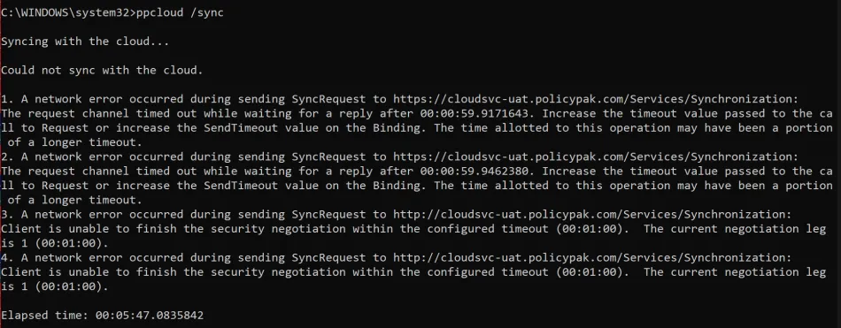

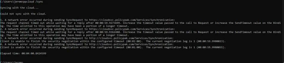

A manual sync with Cloud Client 23.5 might fail to operate and present errors like this:
A manual PPCLOUD /sync pre-23.5 might look like this on a failed manual sync attempt:

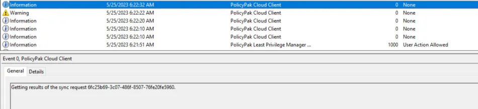

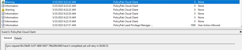

Checking Background Sync'ing for Endpoint Policy Manager Cloud 23.5 Client

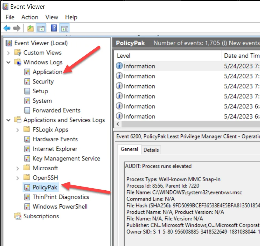

To verify for yourself that that background syncs are occurring, when using the Endpoint Policy Manager Cloud 23.5 or client, please turn to the APPLICATION or Endpoint Policy Manager logs where events will be for Endpoint Policy Manager Cloud.
NOTE: Future versions of Endpoint Policy Manager Cloud client are slated to have its own event log.

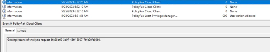

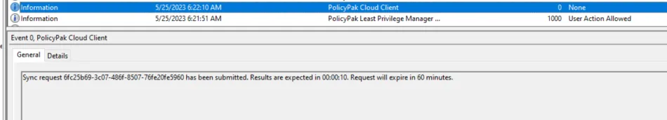

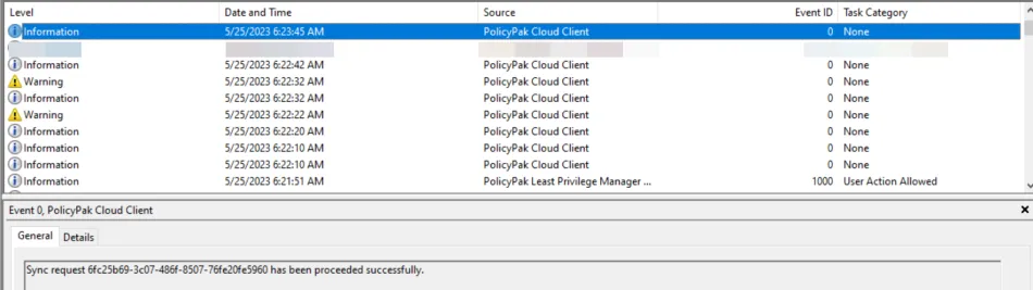

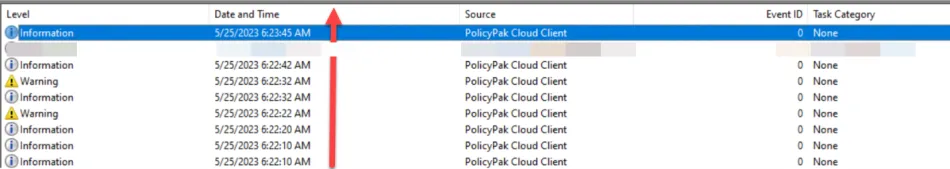

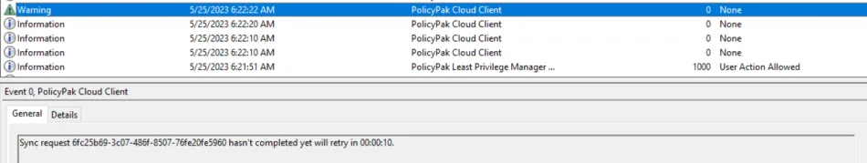

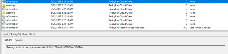

Here's an example of a machine when syncs happen in the background, across a few log events (from earliest to latest event on an automatic, background sync.)
To look at them in order we have…
NOTE: Only when you see the message "...has been proceeded successfully" is an indication of a truly successful sync and policy update.

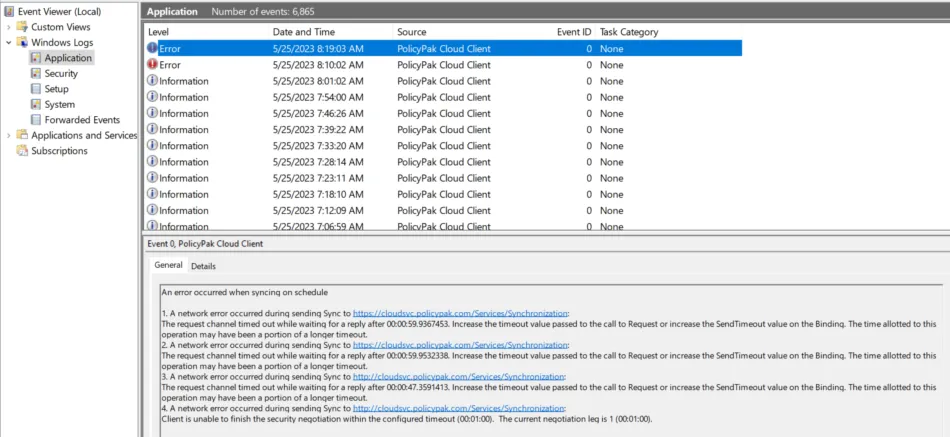

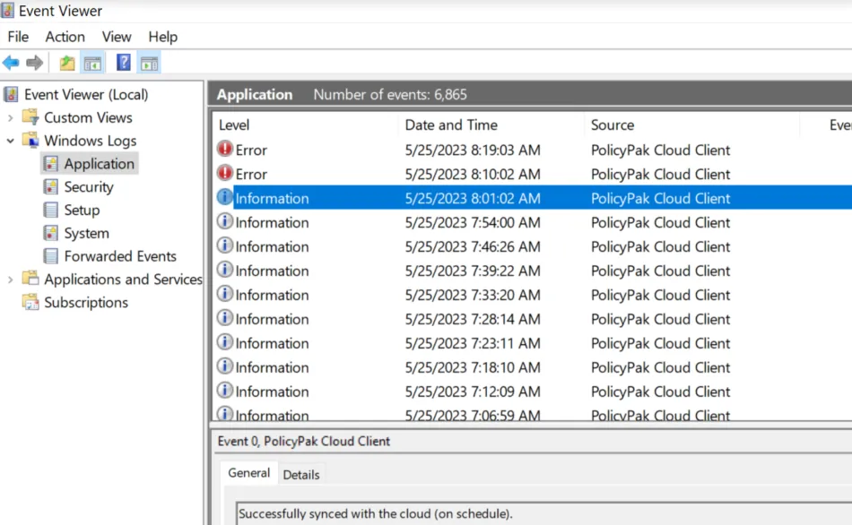

On Pre-23.5 machines, you can see similar events like this for success.
And like this for failure during a background sync.

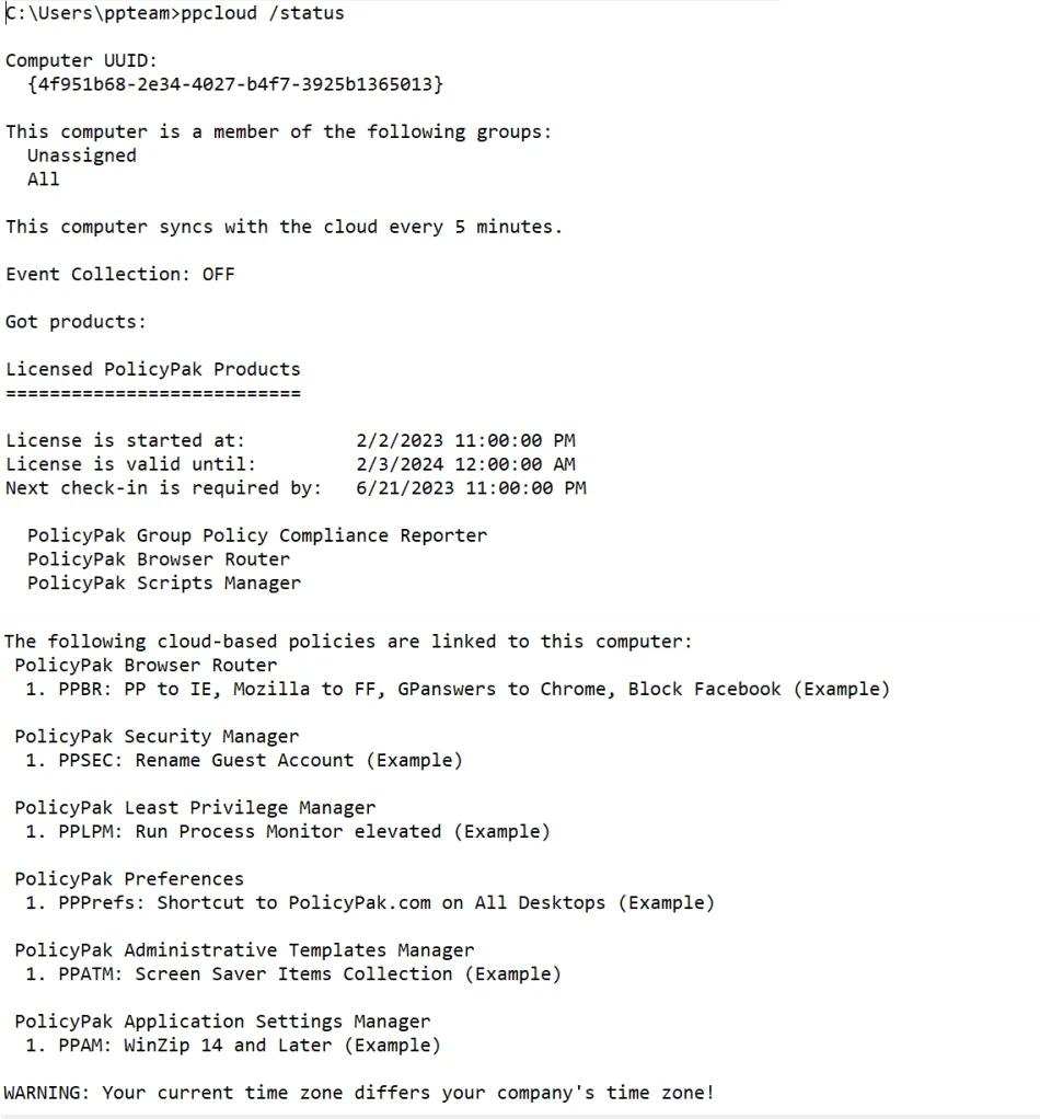

Final Thoughts: PPCLOUD /status
In all cases, using Endpoint Policy Manager CLOUD /status will NOT perform a sync but will tell you the final result of policies upon the machine. This is helpful so you can know what the machine's current state actually is. Example with some text removed to save space…
