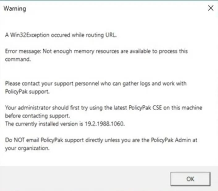

What does it mean when Endpoint Policy Manager Browser Router gives a pop-up saying to contact support to my end-users?
If you see a message like what's seen below…
"Please contact your support personnel who can gather logs and work with Netwrix Endpoint Policy Manager (formerly PolicyPak) support."
This could happen for a variety of reasons.
