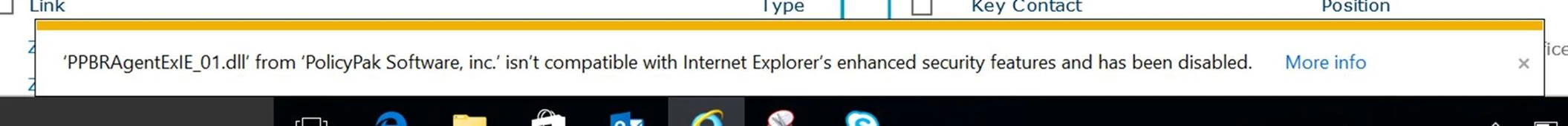

PPBRAgentExeIE_01.DLL error message occurs about Internet Explorer enhanced security. What should I do?
When running IE and Netwrix Endpoint Policy Manager (formerly PolicyPak) Browser Router, the following error could occur:
441_1_image004

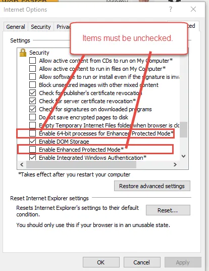

This message is caused by IE Enhanced Security mode. To get Endpoint Policy Manager Browser Router to work properly, set IE specifically to have these two checkboxes unchecked.
441_2_image0012
Then, restart IE (a reboot is not required).
Note also that if the top checkbox is checked, the error does not occur, but Endpoint Policy Manager
Browser Router still will not run.
