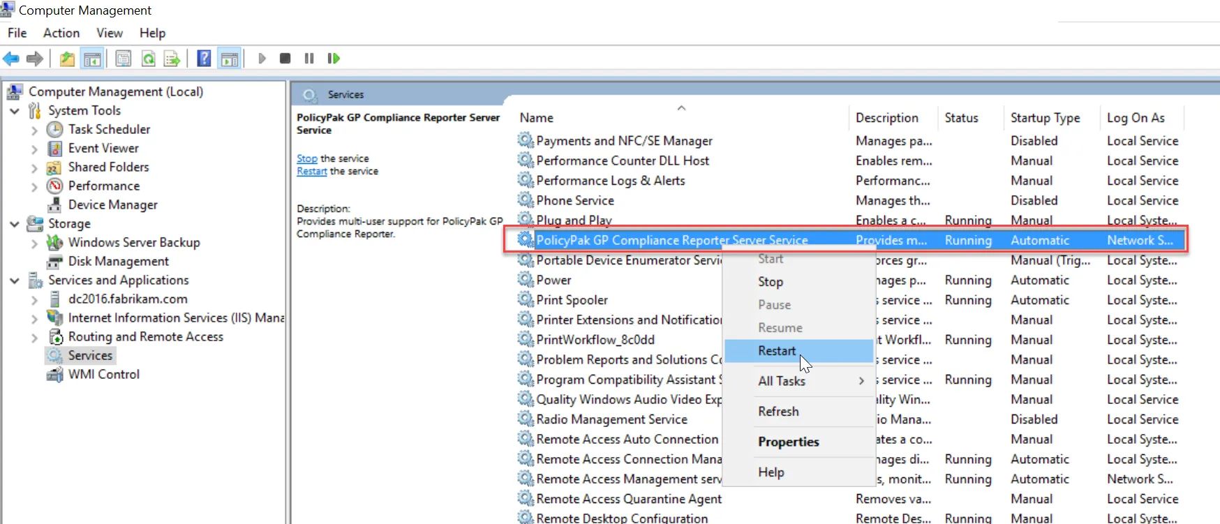

If you attempt to create a snapshot and you are unable to locate computers you expect, this does not necessarily mean that something is wrong. The Compliance Reporter server only checks where computers are in Active Directory once an hour. Therefore, if a computer is moved or renamed, PPGPCR won't know about it until the next hour. However, you can restart the Endpoint Policy Manager GPCR Server service as shown in Figure 60. Then the most recent Active Directory data will be pulled and used.
tuning_and_troubleshooting_2
Figure 60. Restarting the Endpoint Policy Manager GPCR server service.

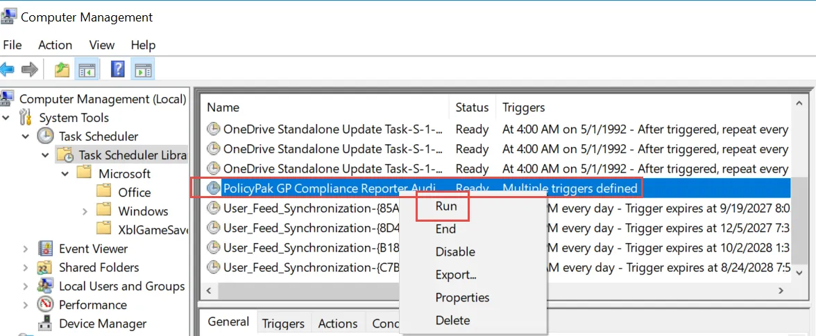

In order to see the scheduled task on an endpoint, you must be logged in as an admin or run Task Scheduler as an admin. Only then will you see the "Endpoint Policy Manager GP Compliance Reporter Auditor" task as shown below. To force it to run, right-click on the task, and select "Run," as shown in Figure 61. It will go from being queued to having a finished status.
tuning_and_troubleshooting_3
Figure 61. Running the scheduled task from the Task Scheduler.

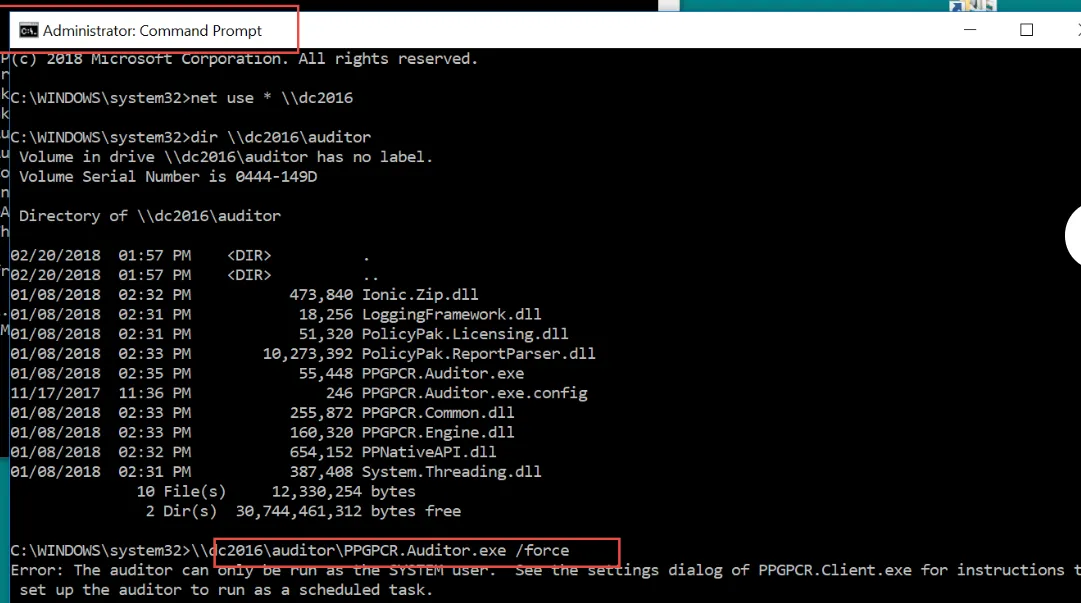

The second way to try to run the auditor is by hand, as SYSTEM. Local admin rights are not sufficient, and if you try to run the auditor as a user or admin, you will get an error, as shown in Figure 62.
tuning_and_troubleshooting_4
Figure 62. Running the auditor as a user or admin will result in an error.

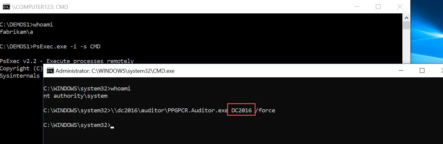

To run the auditor as SYSTEM, you need to open an admin command prompt, and download and run the PSEXEC tool from Microsoft. Run PsExec -i -s CMD, as shown in Figure 63. Then, to force the auditor to run, run \\server\share\PPGPCR.Auditor.exe TargetServer /force. You must specify the Endpoint Policy Manager GPCR server on the command line, as shown in Figure 63.
tuning_and_troubleshooting_5
Figure 63. Specifying the PPGPCR server on the command line.
The above steps will perform the same work as the Task Scheduler, and can be used if scheduled task is not operational.

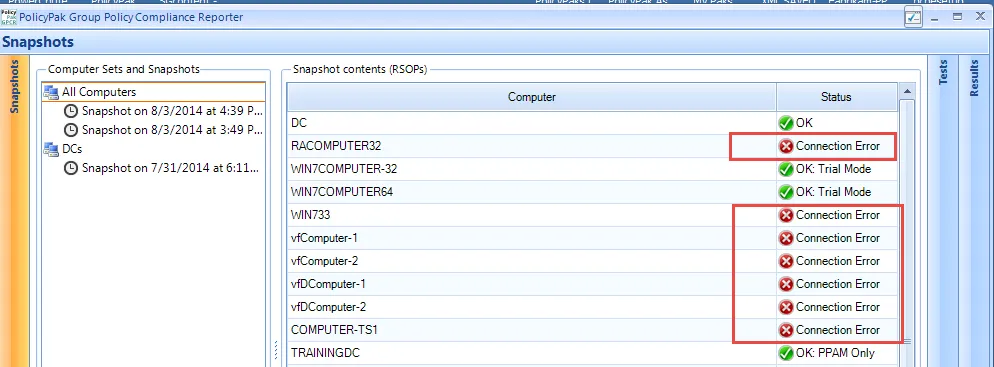

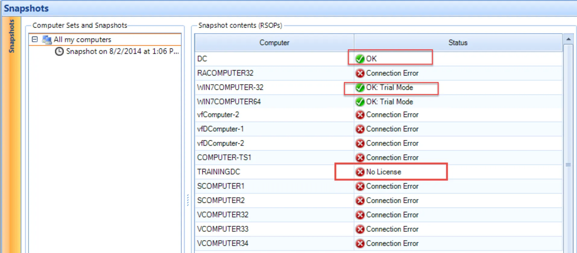

When making manual snapshots, if you see many machines reporting back "Connection Error," that means that there was a communication problem between the Endpoint Policy Manager GPCR client (admin console) and each target machine requesting RSOP. An example of these errors is shown in Figure 64.
NOTE: For a video addressing the opening of the firewall ports as described in this section, please go to the following link: Open required firewall ports.
tuning_and_troubleshooting_6
Figure 64. Connection errors indicating a communication problem.
When this occurs, it is almost always caused by one of the following issues:
  • The target machine is off.
  • The target machine has the Windows firewall turned on and is blocking the "Remote Admin" ports.
  • DNS is not functioning between the Endpoint Policy Manager GPCR client (admin console) and the target machine.
The Endpoint Policy Manager GPCR client (admin console) must be able to contact each target machine and request its RSOP. If any of the conditions above are true, you cannot receive that computer's data. Adjusting for DNS problems is beyond the scope of this manual. However, one problem we can address is opening the remote administration ports (ports 135 and 445) on the target machines. You can do this very easily by using Group Policy.

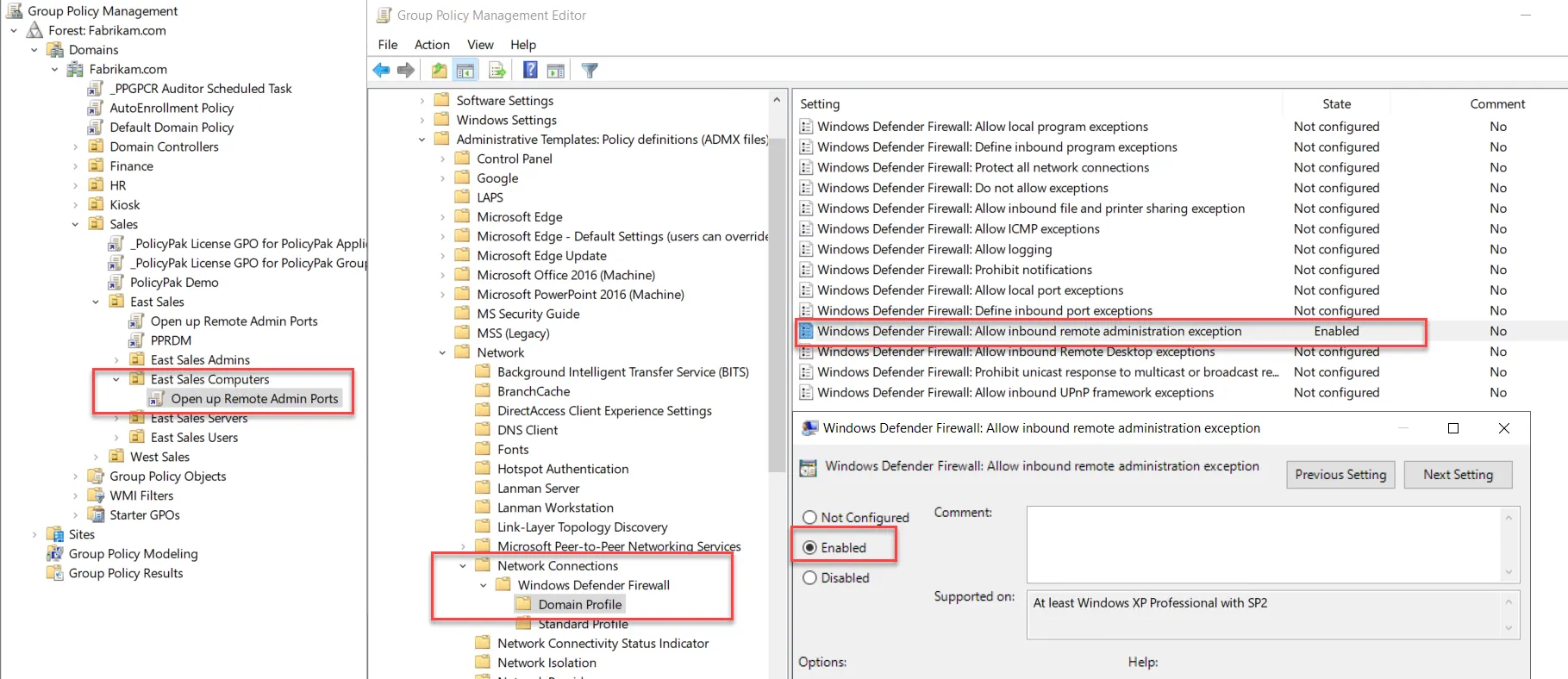

Create a Group Policy setting for your machines to open the required ports. In Figure 65, you can see an example of a GPO linked to "East Sales Desktops." The setting to open the ports is located at Computer Configuration | Admin Templates | Network | Network Connections | Windows Firewall | Domain Profile | Windows Firewall: Allow inbound remote administrative exception, as shown in Figure 65.
tuning_and_troubleshooting_7
Figure 65. Enabling the setting "WIndows Firewall: Allow inbound remote administrative exception."
When you do this, you will be able to remotely grab RSOP from target computers.
NOTE: After you make this change, it could take up to 120 minutes for all computers in the organizational unit (OU) to receive this signal. You can reboot them or manually run GPUpdate instead of waiting.
License Errors
When computers return "No License" in the snapshot status, this means a successful connection was established, but a Endpoint Policy Manager GPCR license was not found.
NOTE: Target machines must be licensed for Endpoint Policy Manager GPCR to return all data (Microsoft and Endpoint Policy Manager data).
When a machine is licensed for Endpoint Policy Manager GP Compliance Reporter, you should see its status shown as "OK," as shown in Figure 66. A status of "Connection Error" or "No License" indicates problems where this computer will not be able to be reported on.
tuning_and_troubleshooting_8
Figure 66. The license status of the machines.
