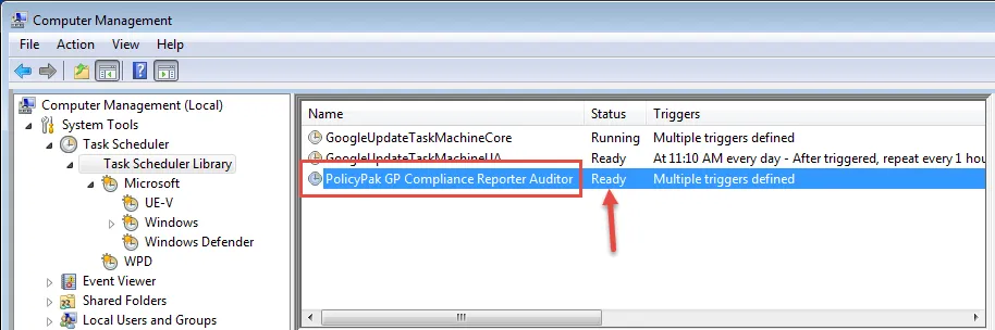

You can see the scheduled task on the endpoint, as shown in Figure 73.
tuning_and_troubleshooting_14
Figure 73. The endpoint scheduled task.

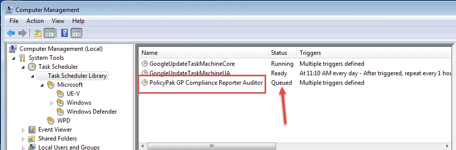

The ideal status is "Ready." When Group Policy triggers, it should change to "Queued," then to "Running," and then back to "Ready." However, sometimes the scheduled task can get stuck at "Queued," as shown in Figure 74.
tuning_and_troubleshooting_15
Figure 74. The scheduled task stuck in a queued state.

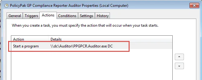

Sometimes endpoints require a reboot in order for data to start to flow to the Endpoint Policy Manager GPCR server. This is normal when the task is first installed via a Group Policy Preference scheduled task. If the task fires correctly, verify the action is set correctly so that PPGPCR.Auditor.exe will be started from the proper location and the information will be delivered to the target server (in this case DC), as shown in Figure 75.
tuning_and_troubleshooting_16
Figure 75. Verifying the action is set correctly.
