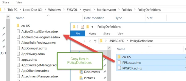

Inside the Endpoint Policy Manager GPCR download is the PPGPCR Diagnostics ADMX.ZIP. When unpacked from the ZIP file, you can use the ADMX files to manage and tune Endpoint Policy Manager GPCR or for troubleshooting if necessary. To use the ADMX files, do the following:
If you have a Group Policy Central store, copy the PolicyDefinitions folder into
\\<DC>\sysvol\<domain>\Policies
If you do not have a Group Policy Central store, copy the PolicyDefinitions folder to
c:\PolicyDefinitions
You can see what copying those files to a Group Policy Central store looks like in Figure 58.
Figure 58. Copying the ADMX files to the PolicyDefinitions folder.

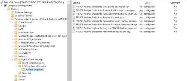

Now when you edit Group Policy Objects (GPOs), you will see Endpoint Policy Manager GPCR policy
settings under Computer Configuration\Policies\Administrative Templates\PolicyPak
. The settings to
tune PPGPCR.Auditor.exe
on endpoints can be seen in the Auditor Endpoints folder, as shown in
Figure 59.
Figure 59. The policy settings for endpoints.
The settings and their functions are each presented in the sections that follow. Note that they are not presented in the same order as found in the figure above.
