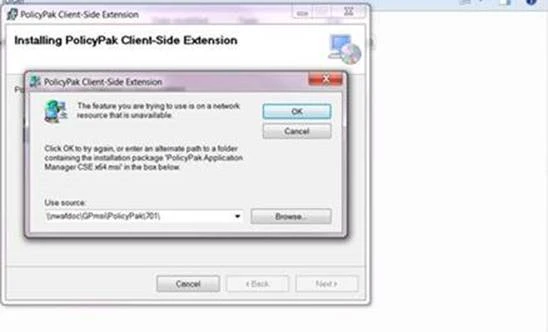

If that does not work, you might see a dialog similar to this when trying to install/uninstall. Even if you revert to a previous version, it is still likely that the CSE won't uninstall.

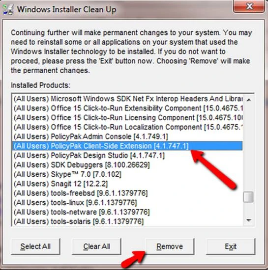

Step 1 – Remove existing CSE version to allow a re-installation of the newest CSE, download MSICUU from this link: https://www.endpointpolicymanager.com/pp-files/msicuu2.zip
Step 2 – Then launch it and select the CSE version and click Remove.
Step 3 – Manually install the latest Endpoint Policy Manager CSE, and verify it worked as expected.
