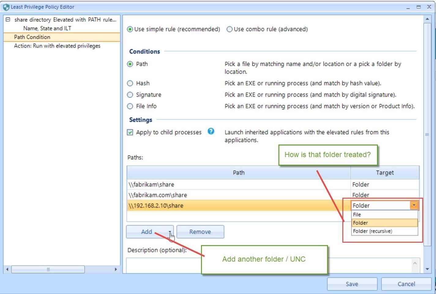

NOTE: If you want to elevate all files in \\SERVER\Share
you must use TARGET = FOLDER
(see
screenshot below.)
But if you want to elevate all files in \\Server\Share
AND all files in any subfolders
(\\Server\Share\Subfolder1, \\Server\Share\Subfolder2
, etc.) then you must specify
TARGET = FOLDER
(recursive) (see screenshot below.)

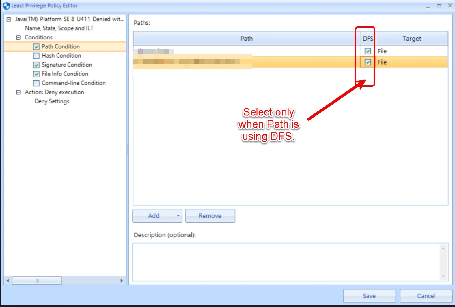

Add to configure the CSE to attempt to unwind a DFS share into its underlying servers and shares use the DFS checkbox seen below.
- CAUTION: Do not use the DFS checkbox if the path is not a DFS share.

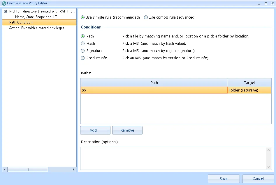

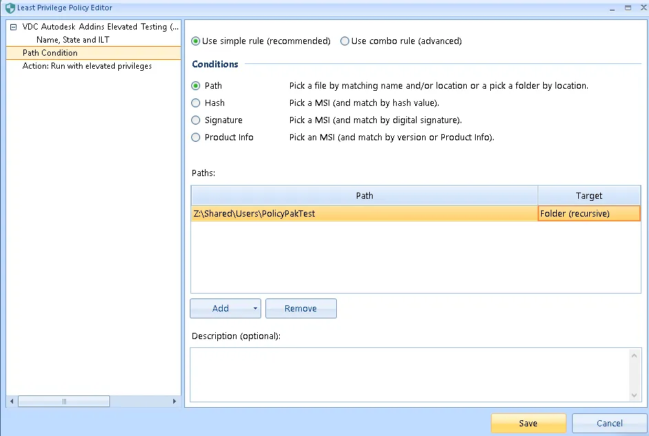

- Create the rules based on how the application is being accessed, in other words if the application will be accessed via a UNC path then create the rule using the UNC path. If the application will be accessed via a drive letter then create the rule based on the drive letter.
- So, for instance, if all of your Non-EXE applications reside in a folder normally accessed via the drive letter S: and you want to elevate all the Non-EXE files in S:
- You should create a Endpoint Policy Manager Least Privilege Manager rule to Elevate the path to the folder using the S: drive and then select Folder or Folder (Recursive) as shown below.

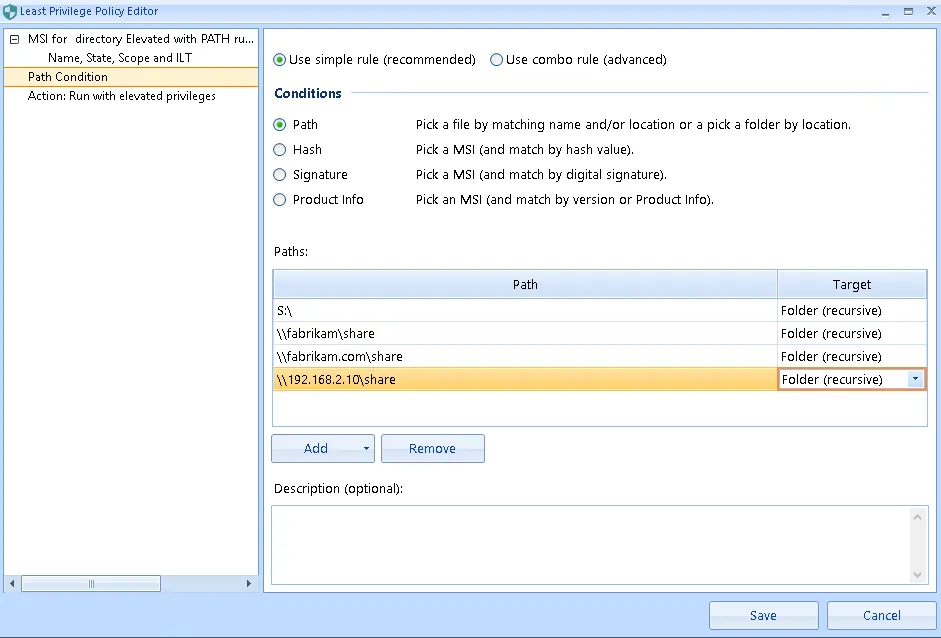

To cover all bases you can also create the rule with all possible paths:

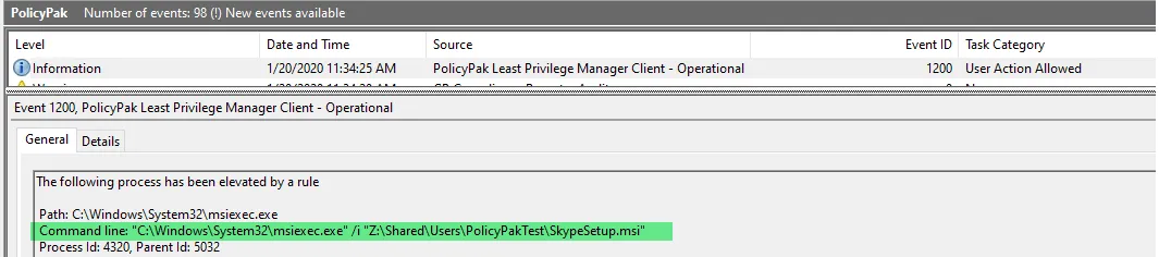

Troubleshooting Non-EXE rules:
- If an elevation rule does NOT work, you can create a simple path rule for any of the Non-EXE
files, (ie. MSI) using a wildcard, for example:
*\SkypeSetup.msi
then launch the MSI after runninggpupdate
on the target machine and then check the Endpoint Policy Manager event log to see which path was shown for the MSI (see screenshot below). Lastly, use that path for your Non-EXE rule:
