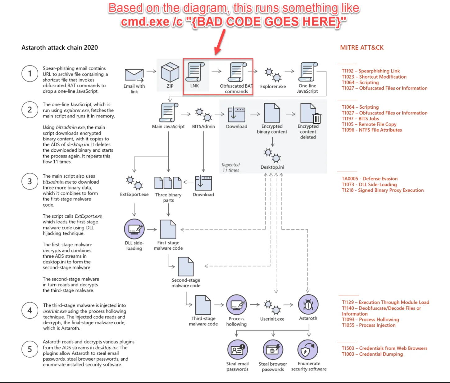

This technique is essentially what is used in much modern malware, as seen in this diagram.
538_2_image-20201215000203-2
When commands are run in this way, Endpoint Policy Manager SecureRun cannot know precisely what to do.
Remember that SecureRun's primary duty is to check "File Owner." And, since this inline command has no owner, Endpoint Policy Manager SecureRun cannot make a definitive determination of "Should it run or not?"

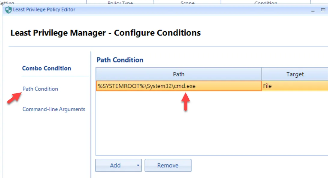

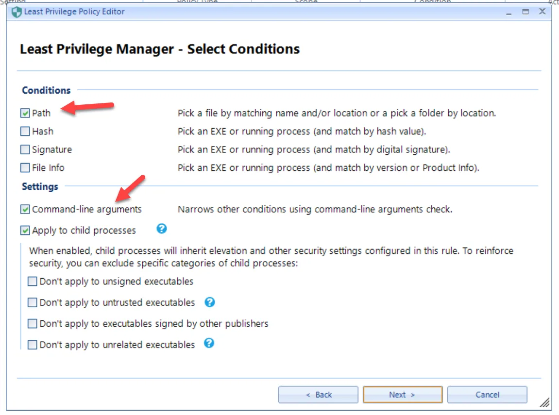

To overcome this, you would need to make an Executable rule (not a Script rule). You would specify a Combo rule, then specify Path and Command Line Arguments like what's seen here.
538_3_image-20201215000203-3
The Path Condition part would be CMD.EXE:

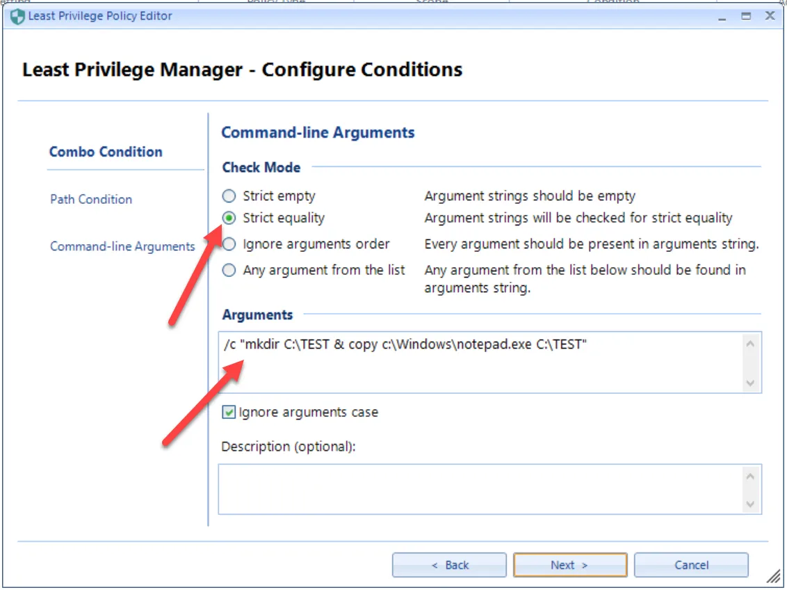

Then the most secure would be "Strict equality" and then specify the arguments which make up the remainder of the command.
Note that other configurations may work, but only "Strict equality" would be the most secure.
538_5_image-20201215000203-5

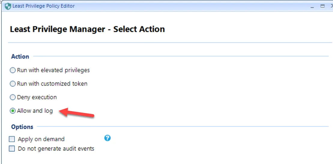

Finally, set Allow And Log.
538_6_image-20201215000203-6
Now you have a rule which is explicitly enabled to overcome a SecureRun block.

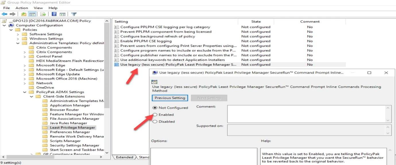

In Endpoint Policy Manager CSE build 2725 we have introduced an ADMX setting entitled "Use legacy (less secure) Endpoint Policy Manager Least Privilege Manager SecureRun Inline Processing Method."
When this value is set to Enabled, you are telling the Endpoint Policy Manager Least Privilege Manager that you want the SecureRun behavior to be reverted back to the original behavior.
In this method, the Endpoint Policy Manager Least Privilege Manager SecureRun commandline parser will ignore inline commands, and all processes like this will continue.
