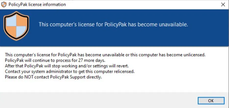

If your users are getting a pop-up saying “This computer’s license for Endpoint Policy Manager has become unavailable” like what’s seen here, this means that your license has either:
  • Expired
  • Been removed
  • Transitioned to a different / less-licensed configuration
However, there is a grace period put in place so policies don’t peel off and Endpoint Policy Manager stops working across any Endpoint Policy Manager component.
You need to resolve or understand your licensing issue.
NOTE: Please read this KB all the way through since the pop-up expression has changed in more recent versions of PolicyPak CSE.

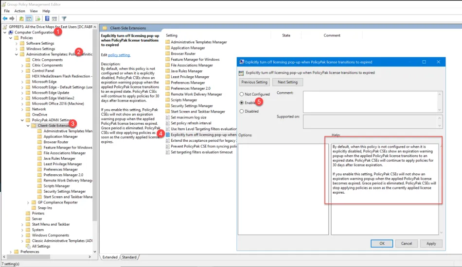

How to change Pop-Up Behavior (previous CSE versions before 24.4)
In previous versions of the Endpoint Policy Manager CSE, the pop-up occurs automatically for all the situations expressed earlier.
However, you can forcefully stop the pop-up from occurring with an ADMX setting which affects CSE before 24.4. That being said, when you use this ADMX setting you also FORGO / Eliminate the grace period for ALL UNLICENSED COMPONENTS.
Therefore you want to be sure a license file is in place, covers the time frame you expect, and all the components you expect to be licensed, before performing this step.
The ADMX setting which applies to CSE versions BEFORE 24.4 is named "Explicitly turn off licensing pop-up when Endpoint Policy Manager license transitions to expired."
NOTE: This will immediately stop Unlicensed components from operating in CSE versions 24.4 and earlier, thus forgoing the grace period for unlicensed components. For versions before 24.4 of the CSE, there is NO METHOD where the GRACE PERIOD will continue WHILE turning off the Grace Period NOTIFICATION.

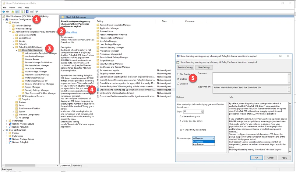

To configure the ADMX setting to ENABLE the broadcast of a pop-up, locate the “Show licensing warning pop-up when any/all Endpoint Policy Manager license transitions to expired” like what’s seen here.
1250_3_68f28861b1bed10b6c283416f9581bae
Then, once the policy setting is configured to Enabled (meaning that the Pop-Up is now possible to be shown), after that, your options are:
  • Days: How many days to show the pop-up before grace period ends. (Must be set to >=1 day to make pop-up possible.)
  • License Usage: When should the pop-up be shown?
    • If set to ALL LICENSES, the pop-up only appears when ALL the licenses have expired (and ALL components transition from LICENSED to UNLICENSED.)
    • If set to ANY LICENSES, the pop-up appears when there is a least ONE expired license among all other valid licenses (and a component transitions from LICENSED to UNLICENSED.)
NOTE: This setting doesn’t need to be configured for all end-computers if you don’t want to. You could craft delivery of the policy setting, for instance, such that only a sub-set of computers were enabled for a pop-up if desired. So instead of getting 100% of users informing you of a licensing concern, maybe you configure and target the Enable pop-up policy for 10% of your computers.

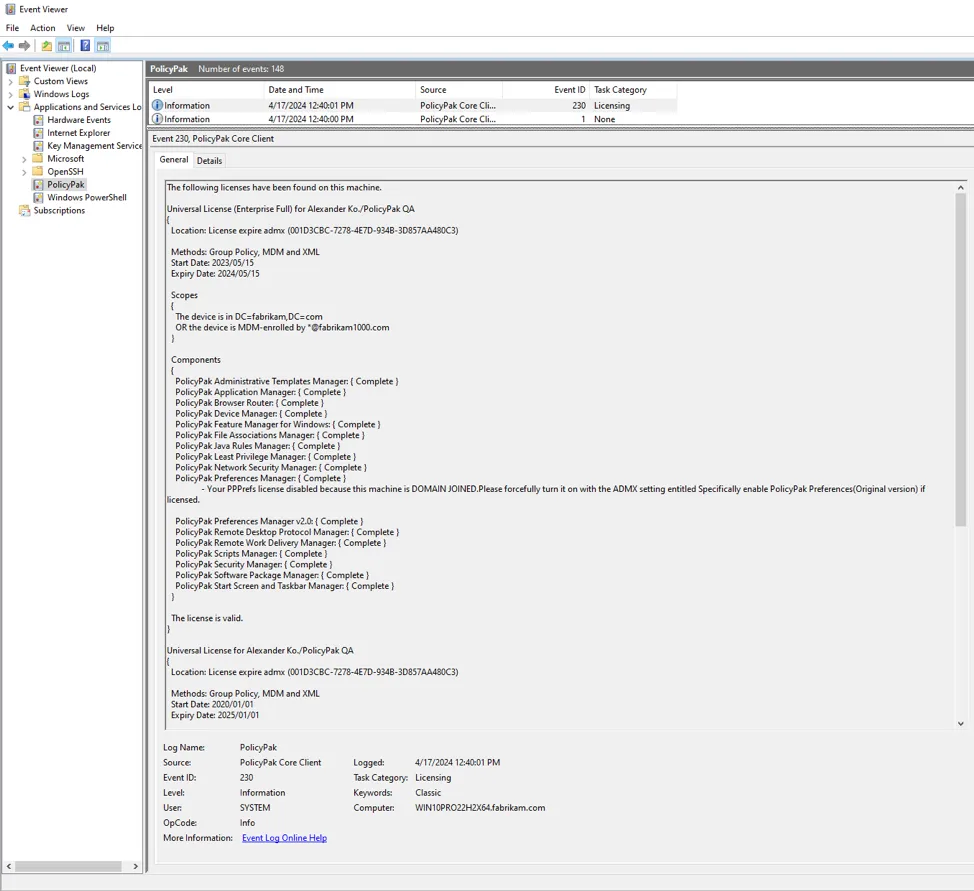

  • Event 230: Licenses found on the machine are all valid.

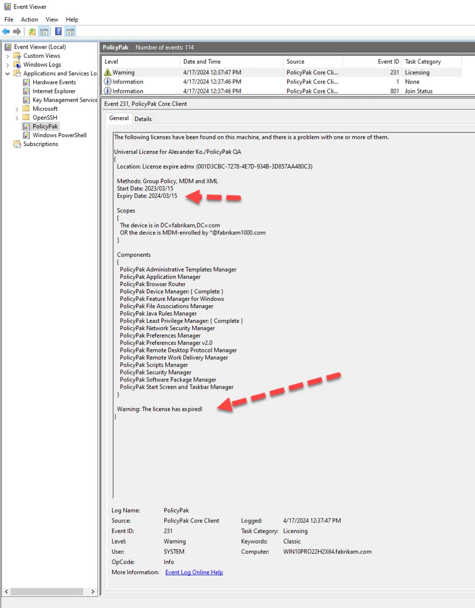

  • Event 231: Licenses found on the machine are not all valid.

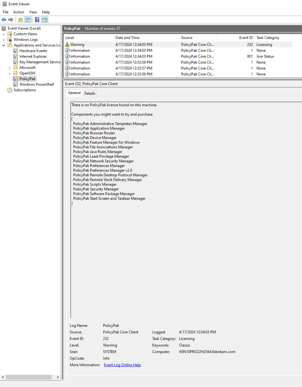

  • Event 232: There is No Endpoint Policy Manager license found on this machine

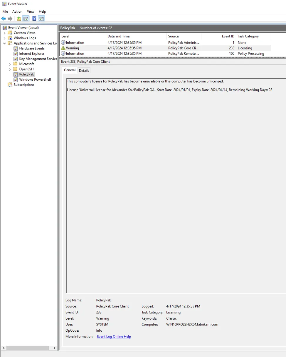

  • Event 233: License has become unavailable or has become unlicensed (only available in CSE versions equal or later to 24.4)
Therefore, a Endpoint Policy Manager admin must make a decision if to show the pop-up (automatic for older CSEs) or opt-in to a pop-up (for newer CSEs). Or you can rely only upon Events which you can forward to some kind of processing system and take action upon.
NOTE: There is not yet an Event ID specifically for when a machine transitions to a less-licensed state. That will be coming soon.
The event IDs to expect on end-point systems and specific examples can be seen here.

Event 232: There is No PolicyPak license found on this machine

Event 233: License has become unavailable or has become unlicensed (only available in in modern CSE versions equal or later to 24.4)
