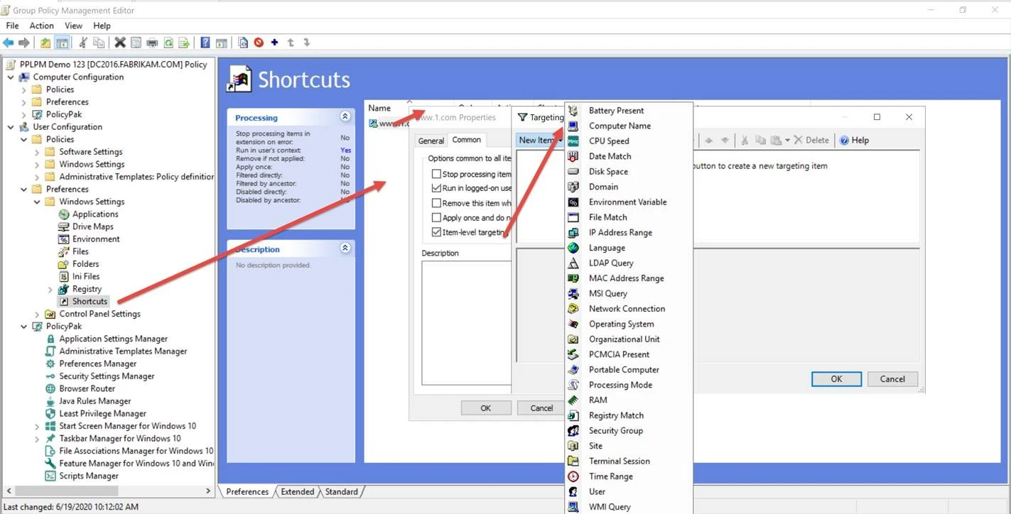

Netwrix Endpoint Policy Manager (formerly PolicyPak) Item Level Targeting is a function of Group Policy Preferences which is also incorporated into Endpoint Policy Manager. There are two pieces to ILT: The editor and the evaluation within the Client Side Extension.
The ILT editor in Group Policy Preferences can be seen in every Group Policy Preferences item, like what's seen here.
196_1_img-01
The ILT editor in Endpoint Policy Manager can be seen in nearly all Endpoint Policy Manager items, like what's seen here.
196_3_img-02

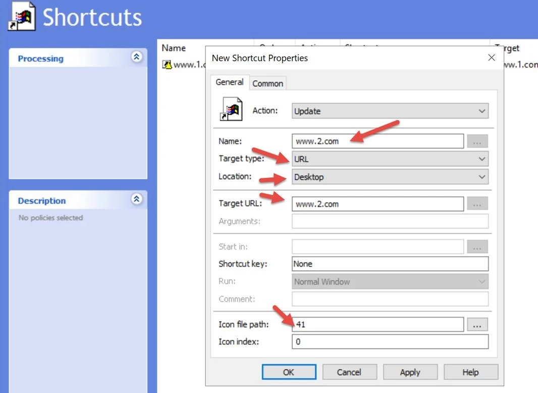

Part 2:

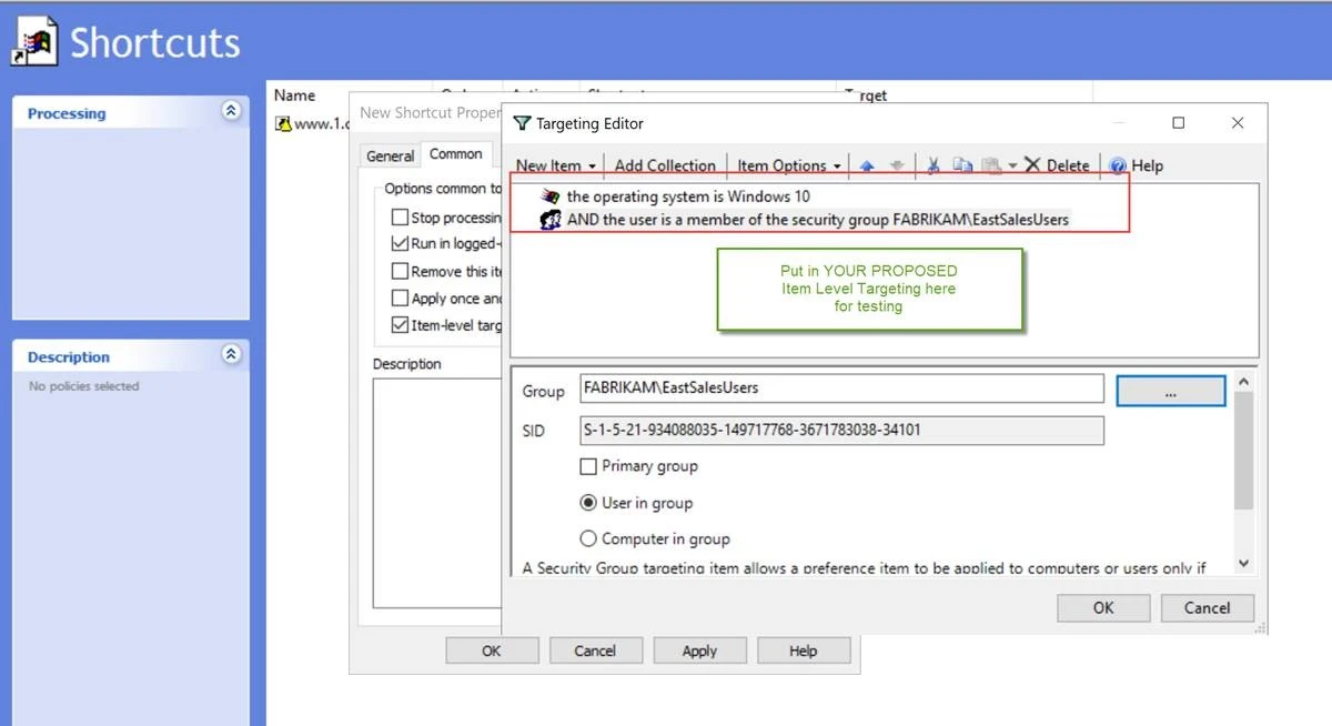

Use Group Policy Preferences to create a Group Policy Preferences shortcut to www.2.com, on the DESKTOP, with TARGET URL being www.2.com and pick any icon you want.. then click in the COMMON tab and select Item Level Targeting, and put in your proposed ILT.
196_7_img-04
196_9_img-05

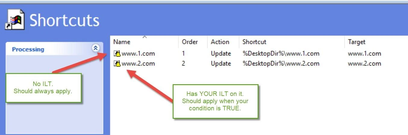

Before you test, let's make sure we fully understand the experiment…
196_11_img-06

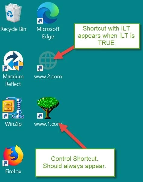

Then on the endpoint run GPupdate… Here is the result you should get:
196_13_img-07
So:
Step 1 – If you only see www.1.com and not www.2.com, then something is wrong with your ILT evaluation and it is evaluating to FALSE. This evaluation will also evaluate to FALSE in any Endpoint Policy Manager item.
Step 2 – If you BOTH www.1.com and www.2.com, then your ILT evaluation is evaluating to TRUE and should also work in any Endpoint Policy Manager item.
