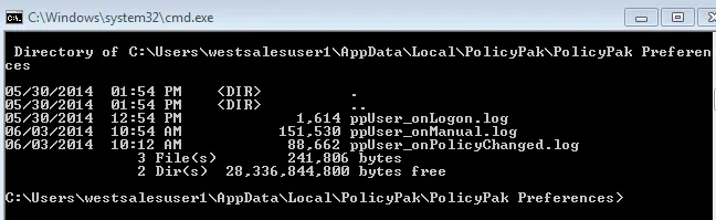

Endpoint Policy Manager Preferences Manager client-side extension (CSE) has several key log files. Endpoint Policy Manager Preferences Manager can affect the Computer side and User side. The computer-side log files can be seen in Figure 19, and the user-side log files can be seen in Figure 20.
Figure 19. Computer-side log files.
Figure 20. User-side log files.
If you want to look through the log files to help diagnose your problems, Table 1 shows the list of Endpoint Policy Manager Preferences Manager log files.
Table 1: Log files.

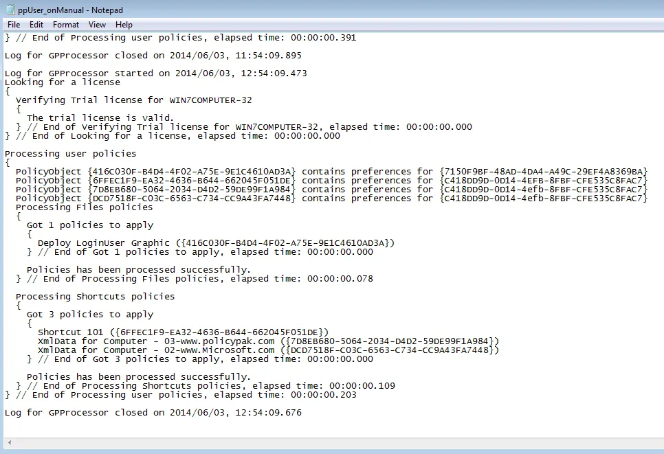

You can see an example of the contents of the logs in Figure 21.
Figure 21. The contents of the logs that are required for troubleshooting.
