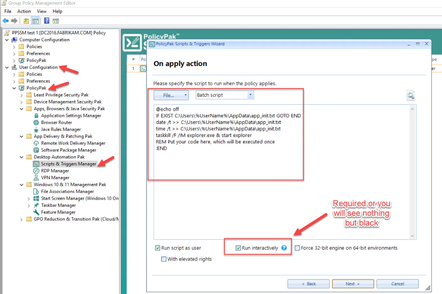

Step 1 – Create a new Endpoint Policy Manager Scripts and Triggers policy on either the computer side (in Switched mode) or on the user side.
Step 2 – Next set the apply action in the policy to run the following BATCH commands.
@echo off
IF EXIST C:\Users\%UserName%\AppData\app_init.txt GOTO END
date /t >> C:\Users\%UserName%\AppData\app_init.txt
time /t >> C:\Users\%UserName%\AppData\app_init.txt
taskkill /F /IM explorer.exe & start explorer
REM Put your code here, which will be executed once
:END
Your settings should look similar to the screenshot below:
929_1_image-20221021235430-1

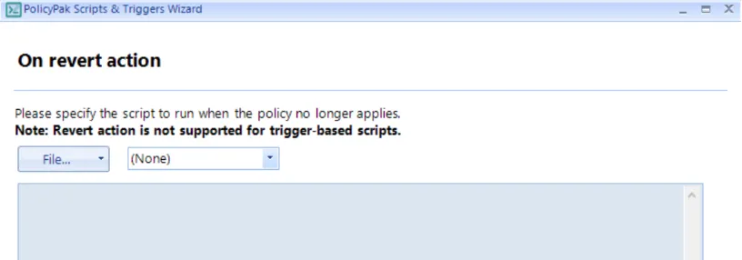

Step 3 – For the Revert action screen, click Next and do not set a revert action as Triggers do not support Revert actions.
929_2_image-20221021235430-2

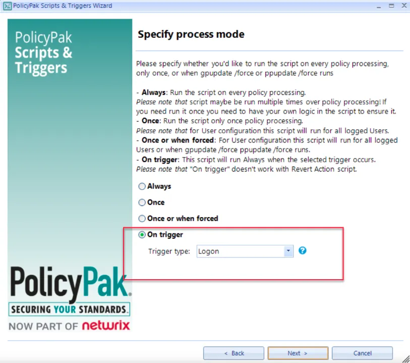

Step 4 – For the Trigger type setting choose "Logon"
929_3_image-20221021235430-3
