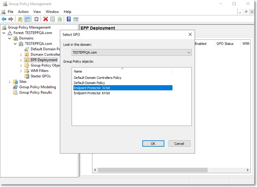

Linking the GPO to OU
Once you have created the GPOs, link them to any of your Organization Units (OU). To do so, follow these steps:
Step 1 – Right-click the OU and then select Link an Existing GPO;
Step 2 – From the Group Policy objects, select Endpoint Protector 32 bit and then click OK;
Step 3 – Repeat these steps and select the Endpoint Protector 64-bit.
NOTE: The new policies will be applied only when the target computers are rebooted.
Linking Group Policy Objects to Organization Units

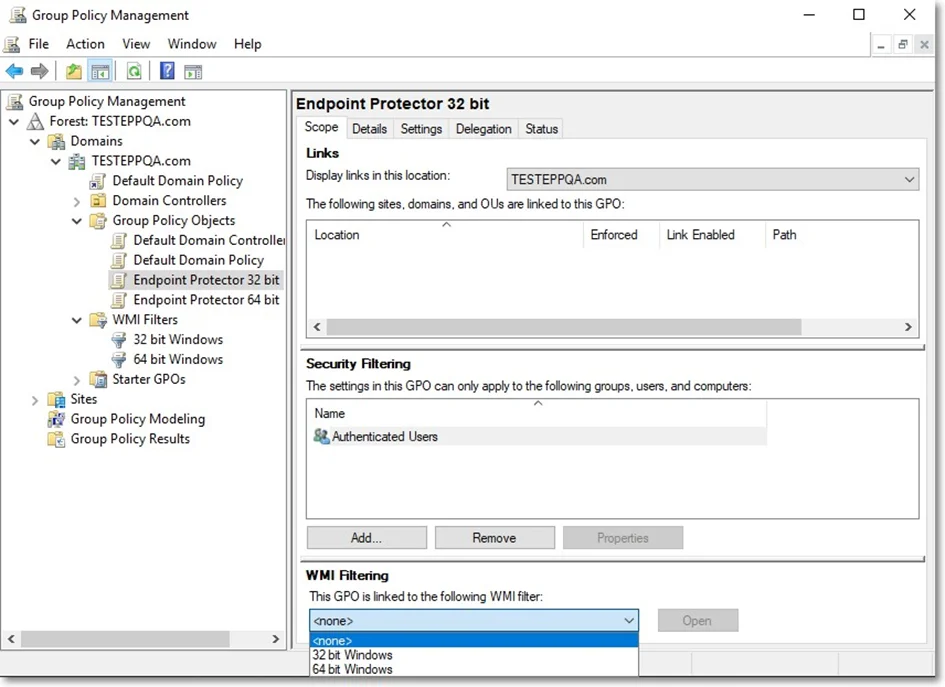

Linking the WMI to GPO
To link the WMI filters to each GPO, follow these steps:
Step 1 – Open the Group Policy Management console, select the Endpoint Protector 32-bit policy, and on the WMI Filtering section, select 32-bit Windows filter;
Step 2 – Repeat this step for Endpoint Protector 64-bit GPO.
Linking the Windows Management Instrument filters to Group Policy Objects
