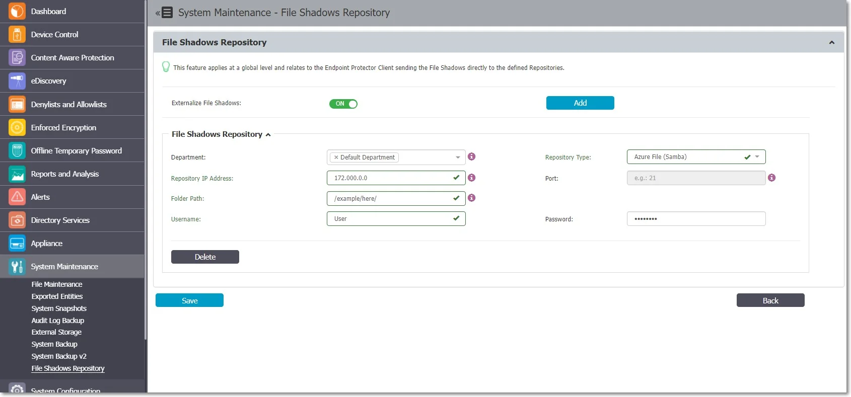

To create a File Shadow Repository, click Add and then provide the following information:
  • Department – assign one or more departments to the File Shadow Repository
  • Repository Type – select the type of repository, FTP, Samba (smbv1), Azure File Storage and Samba (smbv2) or S3 Bucket
NOTE: If you select S3 Bucket type, the information required to create a File Shadow Repository will differ. Read more on S3 Buckets File Shadow Repository in the following section.
NOTE: The minimum permissions required for Samba shares is 750 (case owner has full access and the Group has only Read and Execute).
  • Repository IP Address – add the File Shadow Repository IP address
  • Port – add the port used by the File Shadow Repository
NOTE: You are not required to define the port for Samba (smbv1) or Azure File Storage and Samba (smbv2) repositories.
  • Folder Path – add the folder path where File Shadows will be saved
  • Username and Password – add the repository credentials
NOTE: If you are using the Samba V1 protocol for File Shadows on Mac, make sure that NTLMv1 authorization is set on the Samba server.

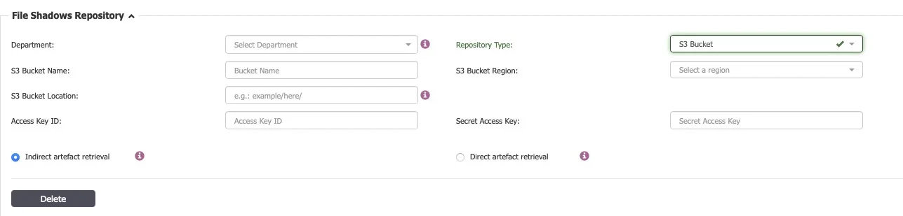

To create an S3 Bucket type File Shadow Repository on Endpoint Protector, provide the following information:
  • Repository Type – select S3 Bucket as the type of repository
  • S3 Bucket Region – depending on the artifacts retrieval method, select one of the options from the drop-down list or add a bucket region corresponding with the AWS S3 Bucket settings
  • S3 Bucket Name – add a name for the bucket repository corresponding with the AWS S3 Bucket settings
  • S3 Location – add a specific sub-folder location in the AWS S3 Bucket
  • Access Key ID – add the Key for S3 Bucket corresponding with the AWS S3 Bucket settings
  • Secret Access Key – add the Token Key generated for a user corresponding with the AWS S3 Bucket settings

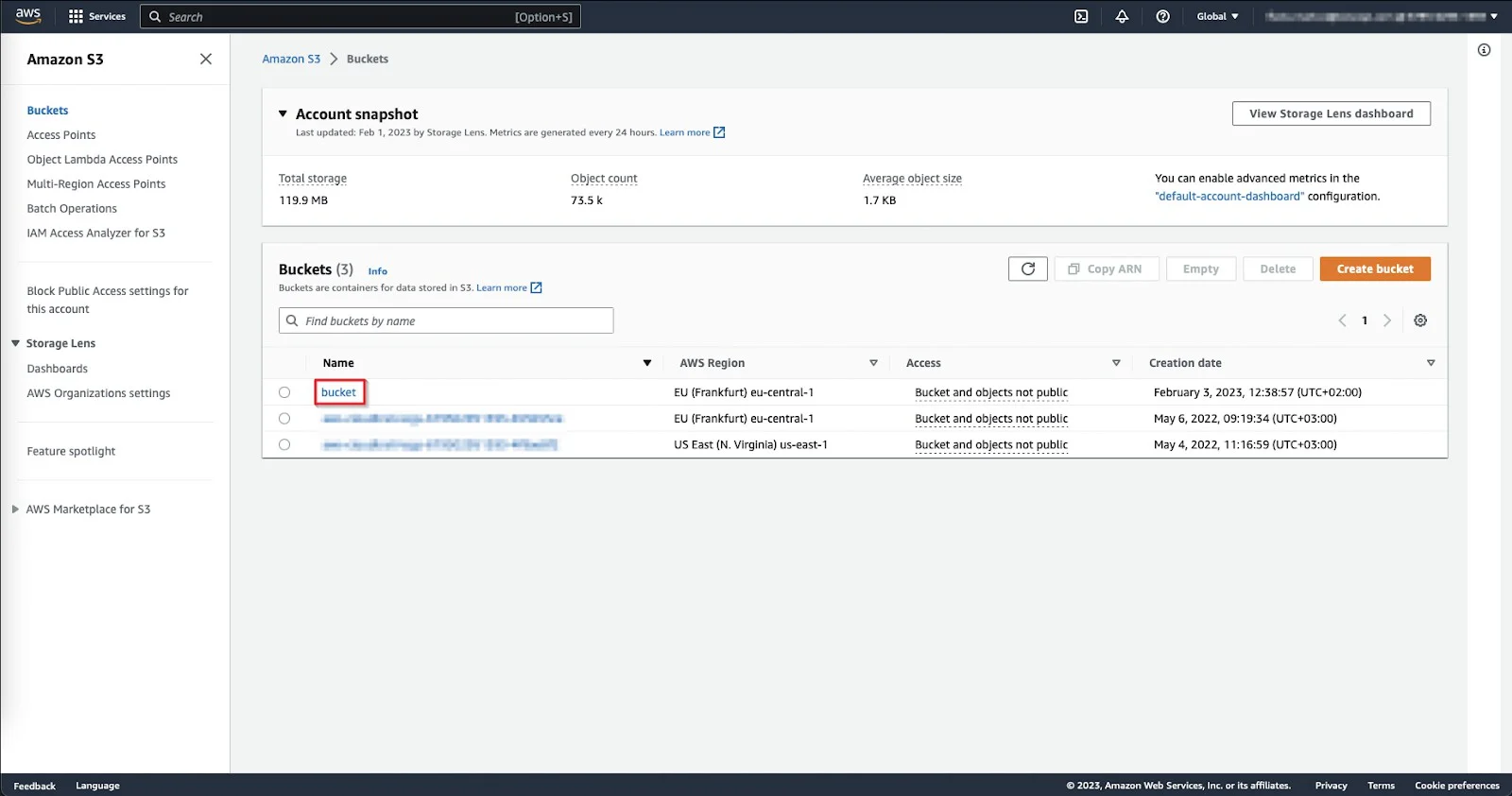

Step 1 – Log in to AWS.
Step 2 – Click on an entry from the S3 Bucket list.
Adding the Netwrix Endpoint Protector Server IP to the S3 Bucket whitelist

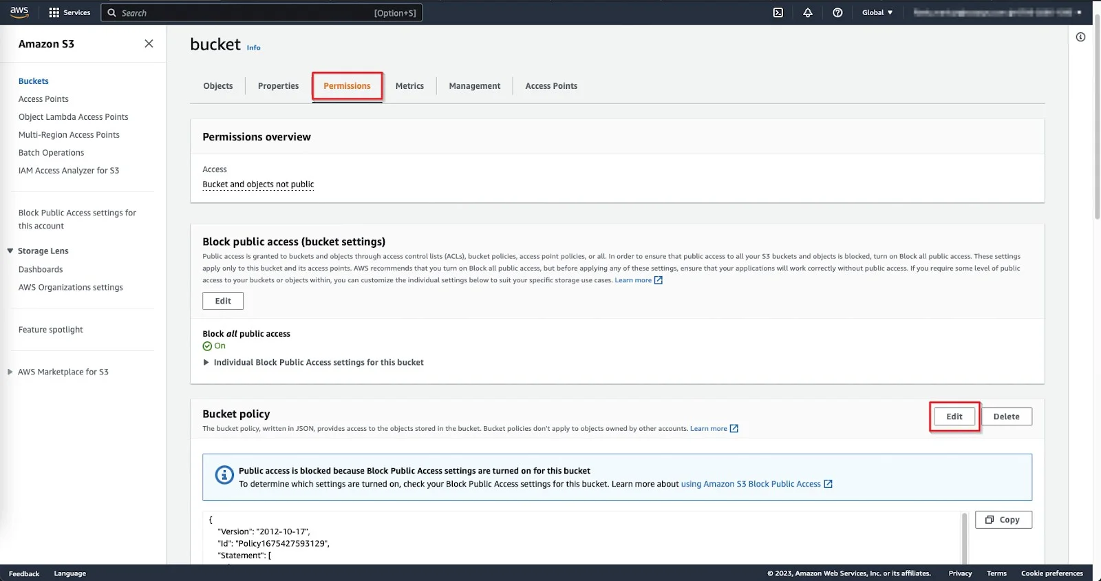

Step 3 – On the S3 Bucket, select the Permission tab, scroll down to the Bucket policy section, and then click Edit.

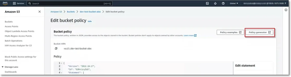

Step 5 – Use the Policy generator from the top-right corner to help you edit or create a new Bucket policy. This will open a new page with the AWS Policy Generator.

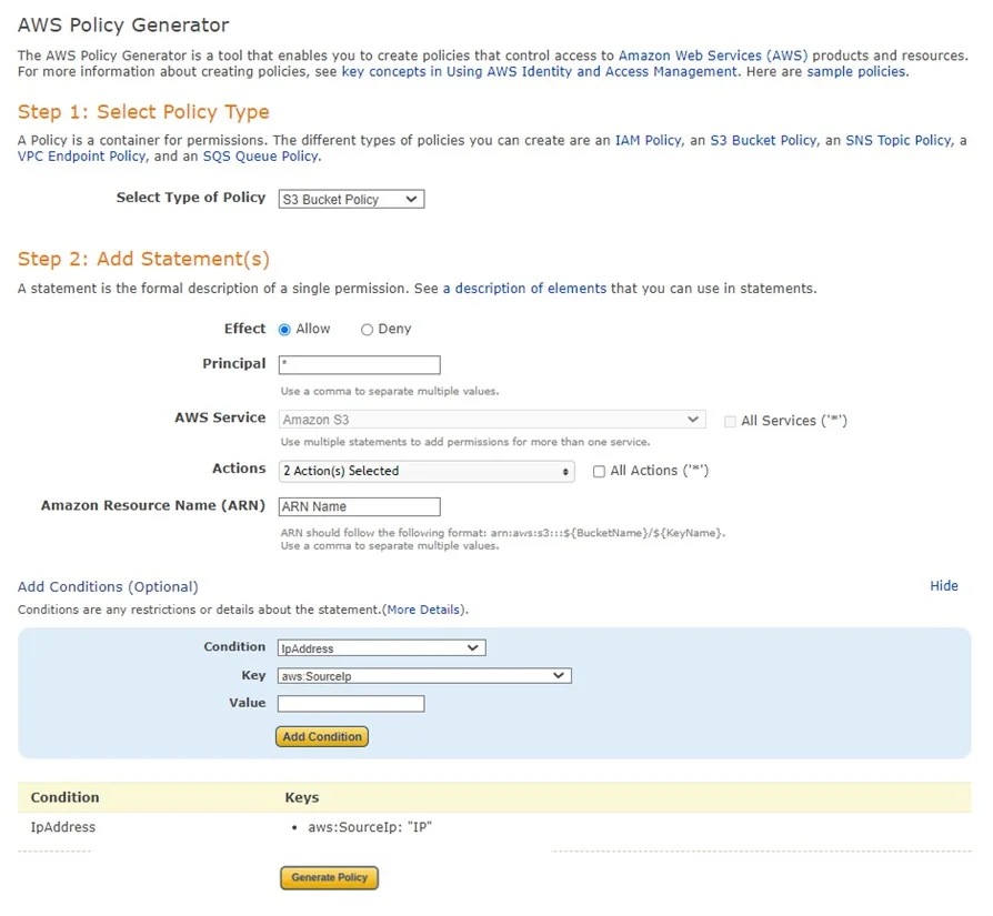

On the AWS Policy Generator, provide the following information:
  • Select Type of Policy – S3 Bucket Policy
  • Effect – select to Allow
  • Principal – add *
  • Actions – select DeleteObject and GetObject
  • Amazon Resource Name (ARN) – add the ARN name
Click Add Conditions and then select from the drop-down lists IpAddress as the Condition, aws:SourceIp as the Key and add the two IPs separated by a comma to the Value field.
Add the Statement, click Generate Policy, and then use the Bucket Policy.
