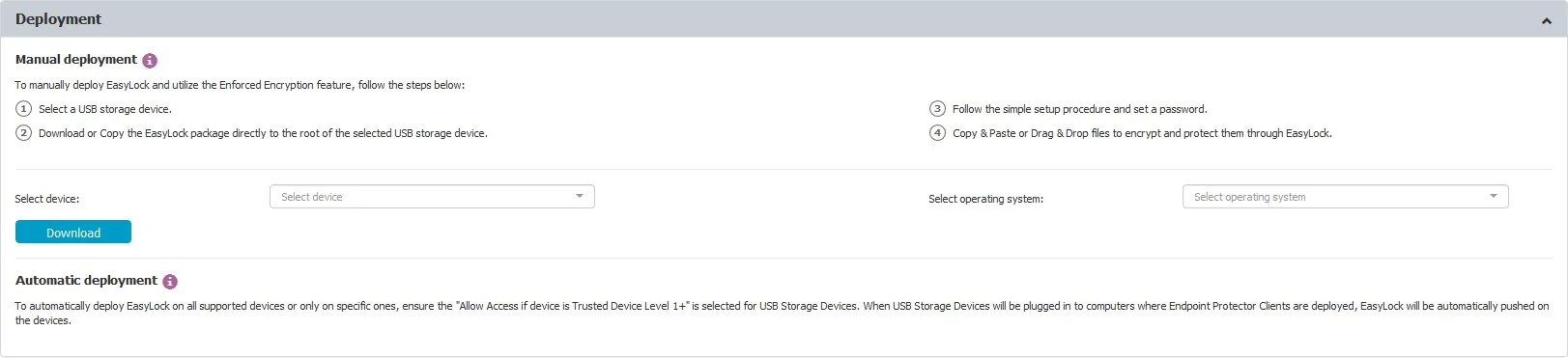

Deployment can be done automatically if Allow Access if Trusted Device™ Level 1+ is selected for the USB Storage Devices. This can be done by going to Device Control, Global Rights section, or using the quick links provided, as per the image above.
Manual deployment is also available. Download links for both Windows and Mac are available in this section. The downloaded Enforced Encryption file must be copied onto the USB storage device and executed from the root of the device. Due to extended security features for manual deployment, Enforced Encryption will have to be redownloaded from the Endpoint Protector interface each time it will be used to encrypt a new USB storage device.
NOTE: Starting with Endpoint Protector 5.2.0.0, manual deployment can also be made by the user if the device is set on Allow Access, by pressing the small USB icon- Encrypt Device with Enforced Encryption.
Both Enforced Encryption deployments are straightforward and require the user only to configure a password.

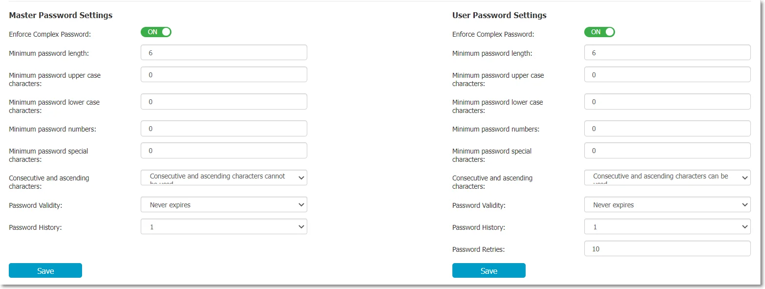

For both the Master Password and the User Password, complex rules can be enforced. If these are enabled, the password lengths, minimum characters, validity, history, and other settings can be set.
 Master Password Settings

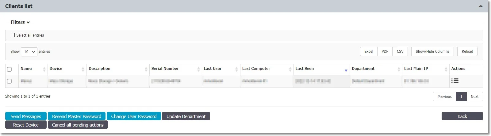

In the Clients list section, all Enforced Encryption enforced devices are listed. By selecting the Manage Client Action a list of Actions History is displayed, as well as the option to manage them by sending a message, changing the user’s password, resetting the device, resending the master password, and more.
