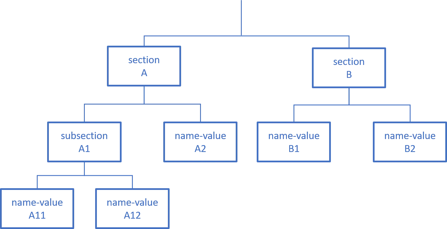

Each set can be seen as a tree-like structure where leaves are a name-value pair: the name of the setting and the value of the setting.
Within a Configuration Set Tree, settings are organized into meaningful sections which can be further organized into subsections, leading to a tree-like structure where sections are nodes. For example, settings involving end-user authentication are gathered in the Authentication section, containing another subsection for every authentication method such as OpenId or OAuth.
This means that every setting value either belongs to the settings root node or to a section, itself belonging to a parent section.

Each setting file is organized into several sections as shown in the Sets, Sections and values diagram. See the Architecture topic for additional information.
Each section's name matches a top level attribute of the file's json
object.
The section content is written as the matching attribute's value which can be broken down into a set of setting attributes and subsection attributes.
Each subsection can then be broken down into more setting attributes and deeper nested subsections.

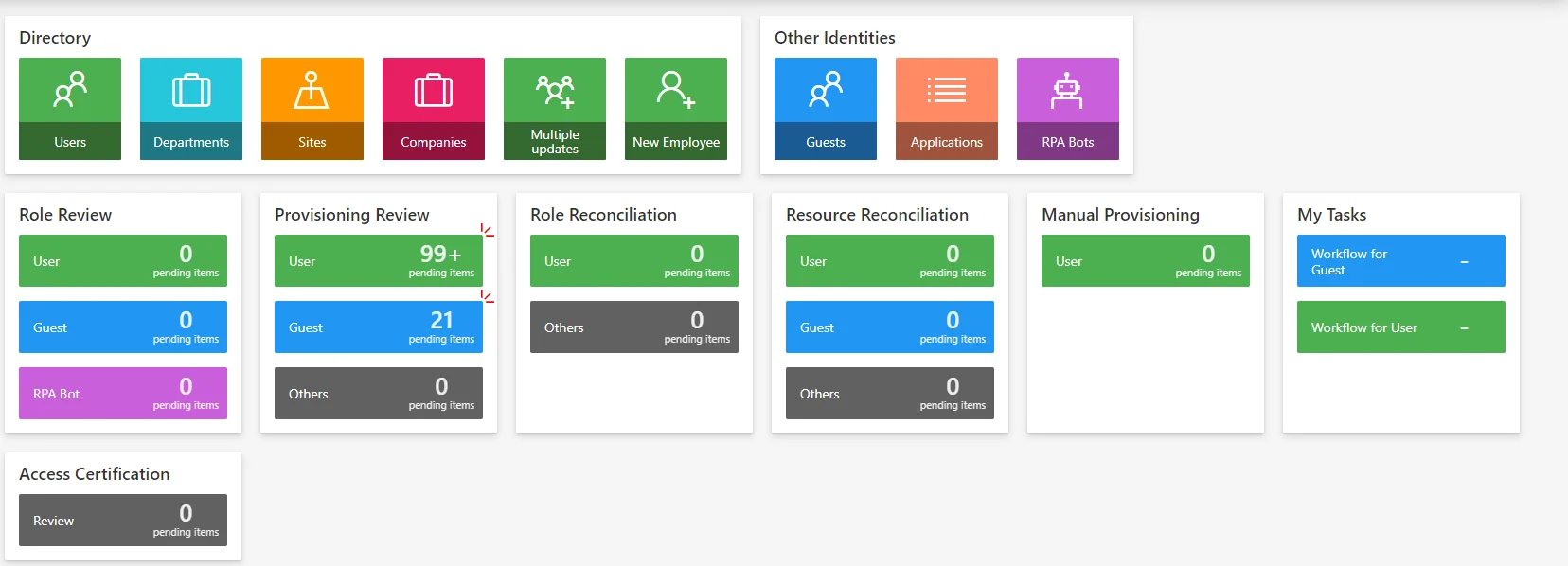

DashboardItemNumber
Some sections on the dashboard contain multiple links. These links are quick links with counters to the review page filtered by entity type. The links are sorted by entity type priority.
By default, 3 links are displayed. If more than 3 entity type links exist, a link "Others" is displayed with the concatenation of remaining counters.
This setting is used to customize the number of links to displayed on each section.
The max number of links to display is 5.
<DashboardItemNumberSetting RoleReviewSection="2" ProvisioningReviewSection="5" RoleReconciliationSection="2" ResourceReconciliationSection="2" MyTasksSection="4" ManualProvisioningSection="2" />
- RoleReviewSection defines the number of links to display in the "Role Review" section.
- ProvisioningReviewSection defines the number of links to display in the "Provisioning Review" section.
- RoleReconciliationSection defines the number of links to display in the "Role Reconciliation" section.
- ResourceReconciliationSection defines the number of links to display in the "Resource Reconciliation" section.
- ManualProvisioningSection defines the number of links to display in the "Manual Provisioning" section.
- MyTasksSection defines the number of links to display in the "My Tasks" section.
