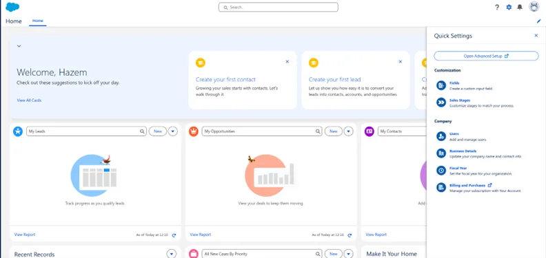

Step 1 – Log into Salesforce using an admin account.
Step 2 – Go to Advanced Setup.

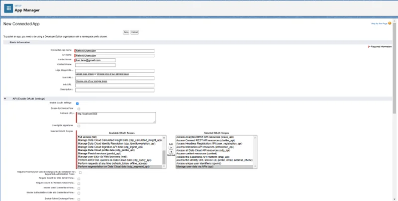

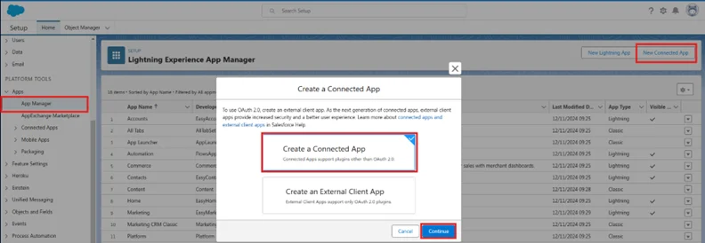

Step 3 – Go to App Manager and Create a Connected App.
Step 4 – Fill in the details of the application: Application Name, API Name, Contact Email, select Enable OAuth Settings, and complete the mandatory information as callback URL and OAuth Scopes.
Step 5 – Save the Application.

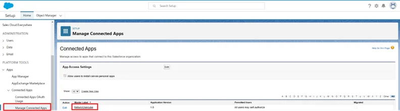

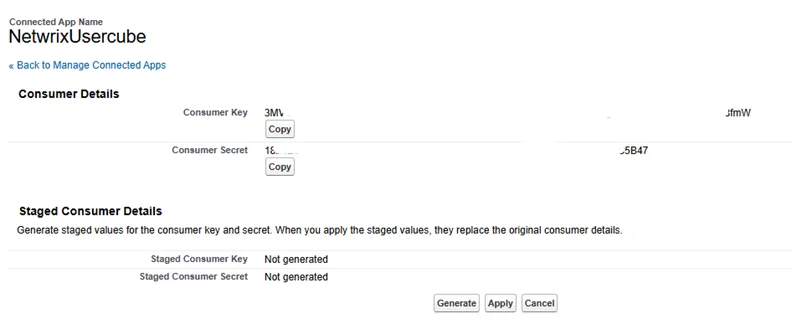

Step 6 – Go to Manage Connected Apps and click on the newly created application.

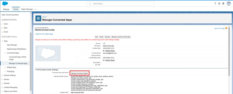

Step 7 – Click on Manage Consumer Details.
Step 8 – Copy the Consumer Key and Consumer Secret in your Keypass.

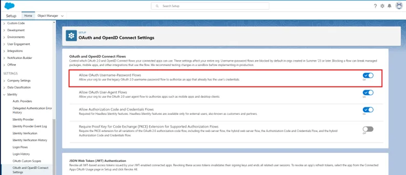

To enable the OAuth authentication do the following:
Step 3 – Go to OAuth and OpenID Connect Settings in the Identity drop-down menu, enable the option to Allow OAuth Username-Password Flows.

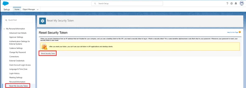

Reset the user token

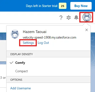

To reset the user token do the following:
Step 2 – Click on Settings under the profile details.
Step 3 – Click on Reset My Security Token.
Step 4 – An email containing the new token will be sent.

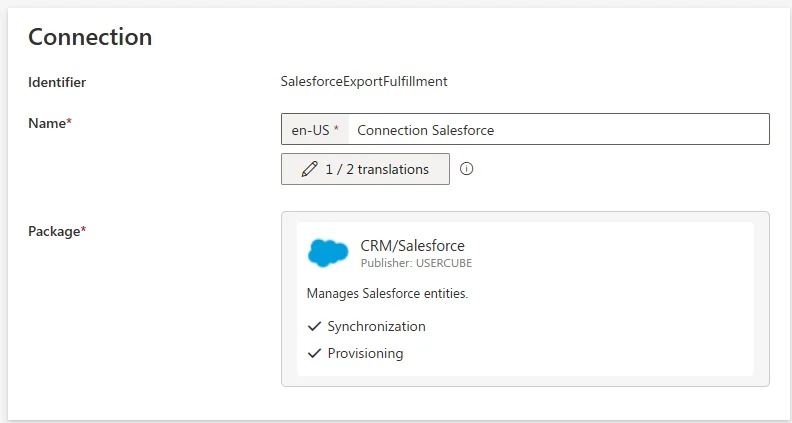

Configure the Salesforce connection
To configure the Salesforce connection do the following:

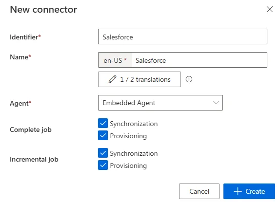

Step 1 – Log into Usercube using an admin account.
Step 2 – Create a new Salesforce connector.

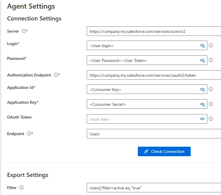

Step 3 – Add a new Salesforce connection.
Step 4 – Fill the fields in the Connection Settings and choose the Filter.
The configuration of the Salesforce connector is completed.

The following example gets information via SCIM on a web application whose URL base is
https://example.for.doc.com
Code attributes enclosed with < >
need to be replaced with a custom value before entering the
script in the command line.
appsettings.agent.json
"Connections": {
"SCIMExport": {
"ApplicationId": "<applicationIdExample>",
"Server": "<https://example.for.doc.com/services/scim>",
"ApplicationKey": "<KEY>",
"Login": "<login>",
"Password": "<password>",
"Filter": "<Users|?filter=active eq \"true\>"
Here we use an account's credentials (login and password) with our application's credentials (ApplicationId and ApplicationKey).
The filter ?filter=active eq \"true\"
retrieves active Users from the external system.
