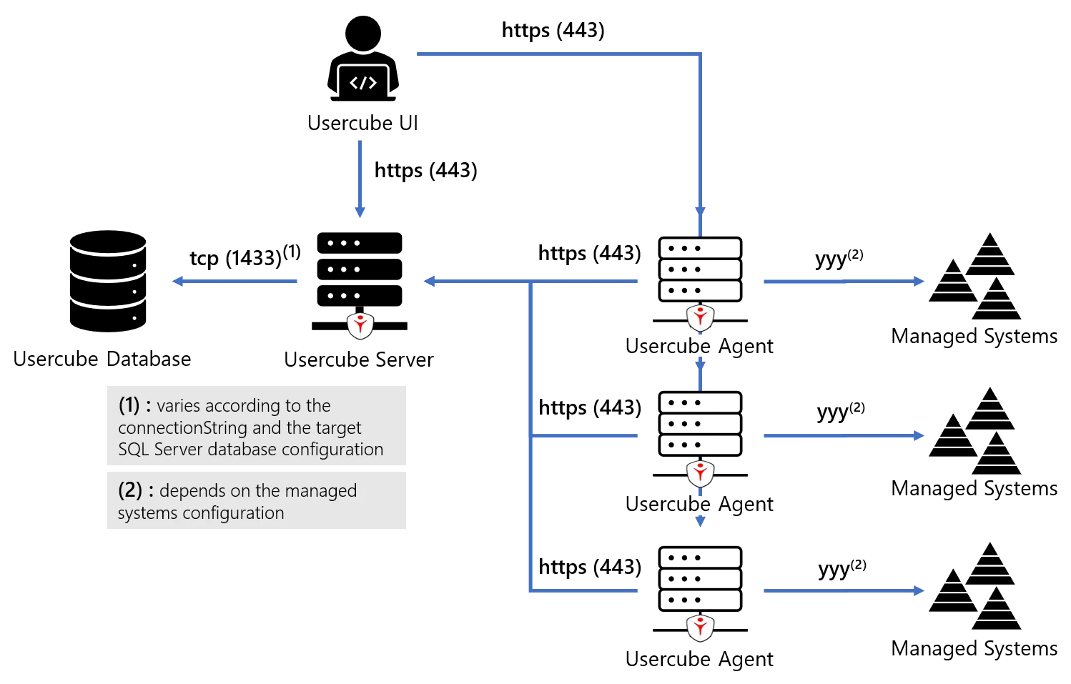

Data flow
Usercube needs the following data flows to be enabled:
  • The Server requires opening connections to the Database.
  • The Agents require opening HTTPS connections to the Server.
  • The Agents require accessing managed systems.
  • All end-users' browsers require opening HTTPS connections to the Server.
  • All end-users' browsers require accessing the authentication providers.
  • Some end-users' browsers require opening HTTPS connections to the Agents.
    These connections are used to launch Jobs or use the Reset Password capabilities of some connectors. This requirement only applies to a few specific administrator type profiles.
  • The Server and the Agent both need to access an SMTP server to send email notifications.

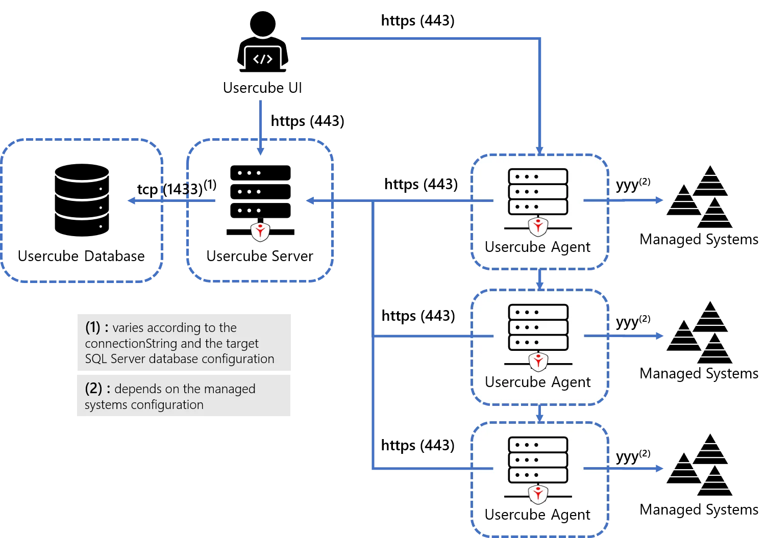

Server & agents
The Usercube Server and Agents can be spread between several workstations. Two scenarios unfold:
1. The server and agents are installed on separate workstations
This approach is useful when managed systems need to run on separate and isolated networks.

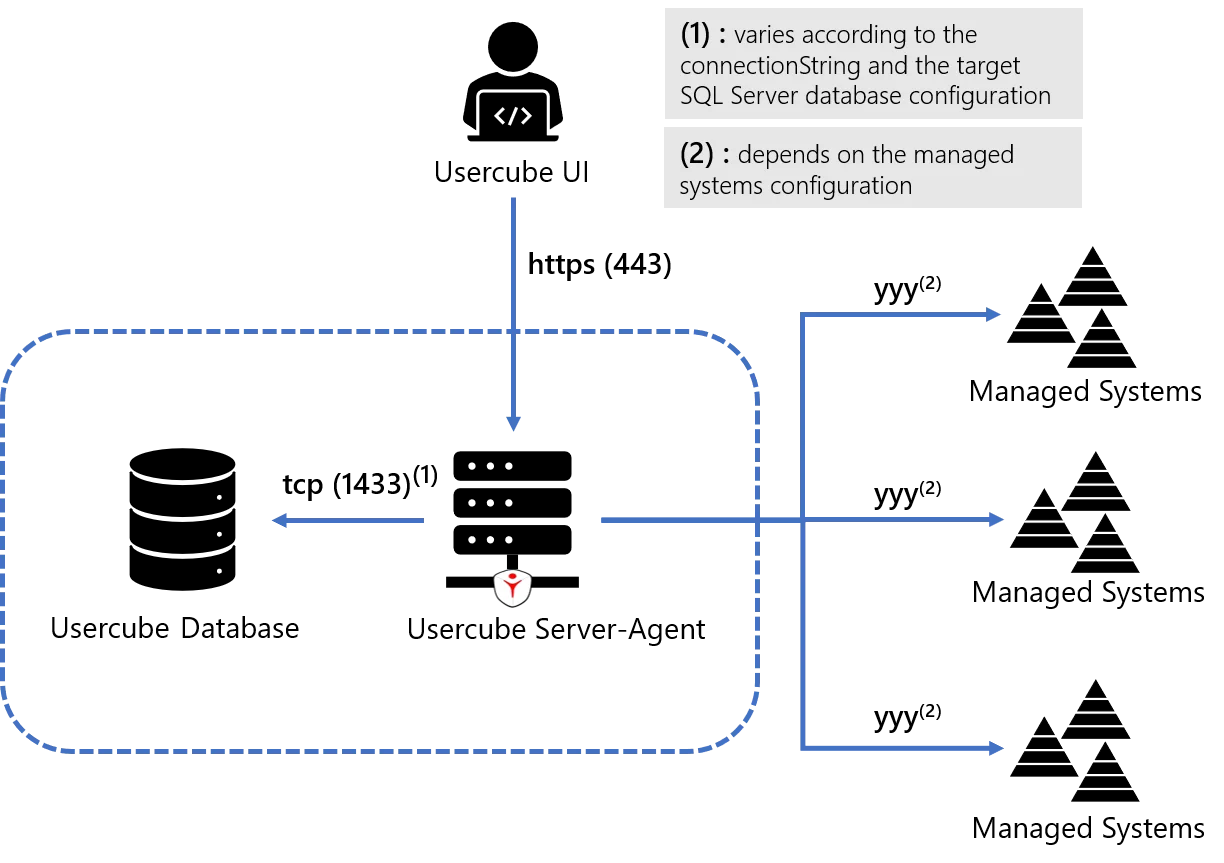

Server & Agents isolated
2. The Server and one Agent are installed on the same workstation
In that case, the Usercube Agent can run directly within the Usercube Server process. The hosting workstation would only host a Usercube Server process (with the integrated agent) and no separate agent needs to be installed. The database could be installed on the same workstation or on a separate one.
Server & Agent together
