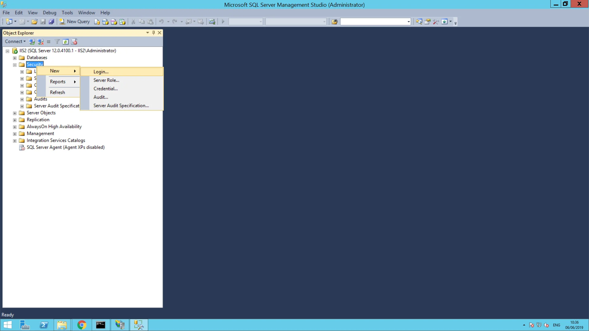

This guide will show you how to perform these operations using SQL Server Management Studio.
Open SQL Server Management Studio (SSMS).
Log in to access the server on which runs the Usercube Database with an account member of the sysadmin or securityadmin server-level role.
Expand the Security node.
Expand the Login node.
Look for the Usercube service account in the list.
If you cannot find the service account:
From the Login node, right-click and select New > Login.
On the General page, enter the service account login name in the down-level logon format, such as
CONTOSO/identitymanagerContosoServer
. If you're not sure about the correct spelling of your service account or domain, you can search for it using the search window. From the Login node, right-click and select New login > Login name > Search. -
Then, choose eitherWindows authentication if you chose to connect the server to the database with a Windows service account (Integrated Security=SSPI in the connection string) or a SQL Server authentication for a SQL Server account (if you set up the connection string with a login/password). In the SQL case, fill in the same password in the form as in the connection string. You should now see the newly created login in the Login list.

The service account used by the Server to access the Database is either:
- A Windows account if the connection string was set up using
. - A SQL Server account if the connection string was set up with a login/password.
appsettings.json
"ConnectionString": "data source=.;Database=UsercubeContoso;Integrated Security=SSPI;Min Pool Size=10;encrypt=false;"
The second example sets a connection string using the SQL Server authentication.
has been set as the Usercube Server IIS website identity.
appsettings.json
"ConnectionString": "data source=.;Database=Usercube;User Id=CONTOSO/identitymanagerContosoServer;Password=myPassword;Min Pool Size=10;encrypt=false;"
SQL Server authentication stores plain text credentials in the configuration file. This is strongly discouraged. To avoid storing plain text credentials, you should always strive to use Windows authentication or encrypt sensitive setting values such as the connection string.
