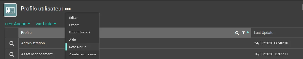

| ExportSettingsOptions optional | Type List Description List of entities to retrieve from the EasyVista instance. Note: for any customized entity to be exported, this argument must contain its REST API URL. Get REST API URLs Access the relevant view in EasyVista and click on � > Rest API Url to copy the URL. For example: ![]() |
