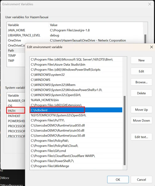

Step 2 – Unzip the “hdbclient.zip” archive to C: drive and add the path to the Path environment variables.

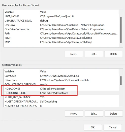

Step 3 – Create environment variables: HDBADOTNET=C:\hdbclient\ado.net and
HDBADOTNETCORE=C:\hdbclient\dotnetcore.

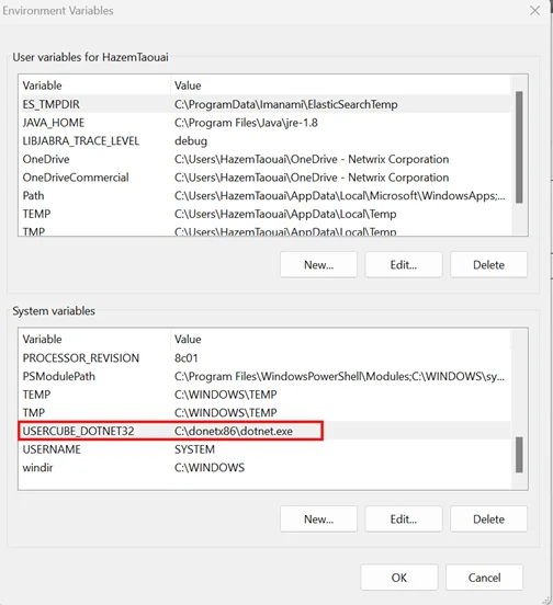

Step 1 – Copy the provided DLL sapnwrfc.dl into the Runtime of Usercube.
Step 2 – Unzip the dotnet86.zip archive to C:\dotnetx86.
Step 3 – Copy the DLLs icudt50.dll, icuin50.dll and icuuc50.dll into the Runtime of Usercube.

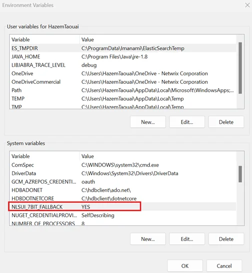

Step 4 – Disable DLLs search by adding the environment variable NLSUI_7BIT_FALLBACK=YES.
Step 5 – Add new environment variable USERCUBE_DOTNET32 containing the path to dotnetx86
(e.g.: C: \donetx86\dotnet.exe).
