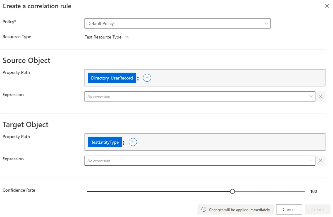

  1. On the relevant resource type's page, click on Correlation Rules and + New.
    New Correlation Rule
    Correlation rules can also be created through the Access Rules screen (accessible from the home page, in the Configuration section), clicking on the Correlations tab and the addition button at the top right corner.
    Home - Access Rules
    Addition Icon
  2. Fill in the fields.
    New Correlation Rule Fields
    • Source Object: at least one property from the source system that is going to be linked to a given target object. Can be defined by a property path and/or an expression.
    • Target Object: one property from the managed system that is going to be linked to a given source object. Can be defined by a property path and/or an expression.
    • Confidence Rate: rate expressing the rule's reliability, and its priority order. See the detailed explanation.

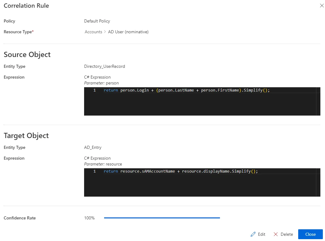

      In this example, a person via their login and name, is the owner of a nominative AD account via its sAMAccountName attribute and display name:
      Correlation Rule Example

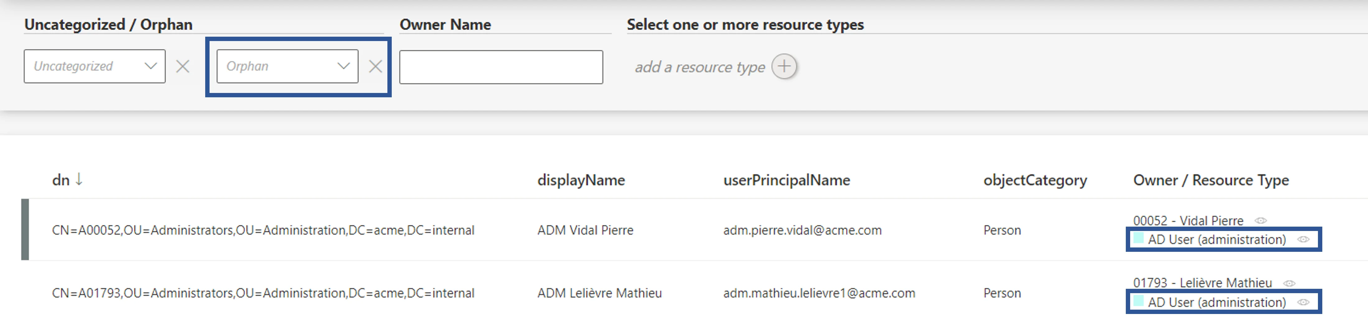

In order to verify the process, check the list of orphaned accounts and analyze them to look for patterns revealing correlation issues. To do so, click on the target entity type(s) affected by your rule(s) in the left menu of the home page.
Test Entity Type
The entity type's page can be configured via XML to customize all displayed columns and available filters, especially the Orphan filter that spots resources without an owner, and the Owner / Resource Type column that shows the owner assigned to each resource.
Owner / Resource Type Column
A knowledgeable person must analyze a few samples to ensure that resources' owners can all be justified, meaning that orphaned accounts are supposed to be so, and that correlated resources are matched with the right owner.

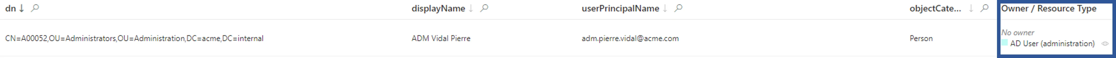

Troubleshooting​
If a resource is not correlated (or not correctly), then�​
Uncorrelated Resource
  • Check the validity of correlation rules.
  • Check the resource's data quality.
