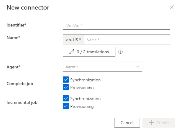

  2. Click on the addition icon and fill in the information fields.
    Addition Icon
    Connector creation
    • Identifier: must be unique among connectors, without any whitespace, start with a letter, and contain only letters, numbers, . and/or -.
    • Name: will be displayed in the UI to identify the connector.
    • Agent: agent that the connector is supposed to use.
      NETWRIX recommends choosing the provided SaaS agent.
    • Complete Job: job scheduled to perform a set of tasks, including completesynchronization and/or provisioning for all the connectors, for which you selected the corresponding checkbox.
    • Incremental Job: job scheduled to perform frequently a set of tasks, including incrementalsynchronization and/or provisioning for all the connectors, for which you selected the corresponding checkbox.
  3. Click on + Create to get on the connector's overview page:
