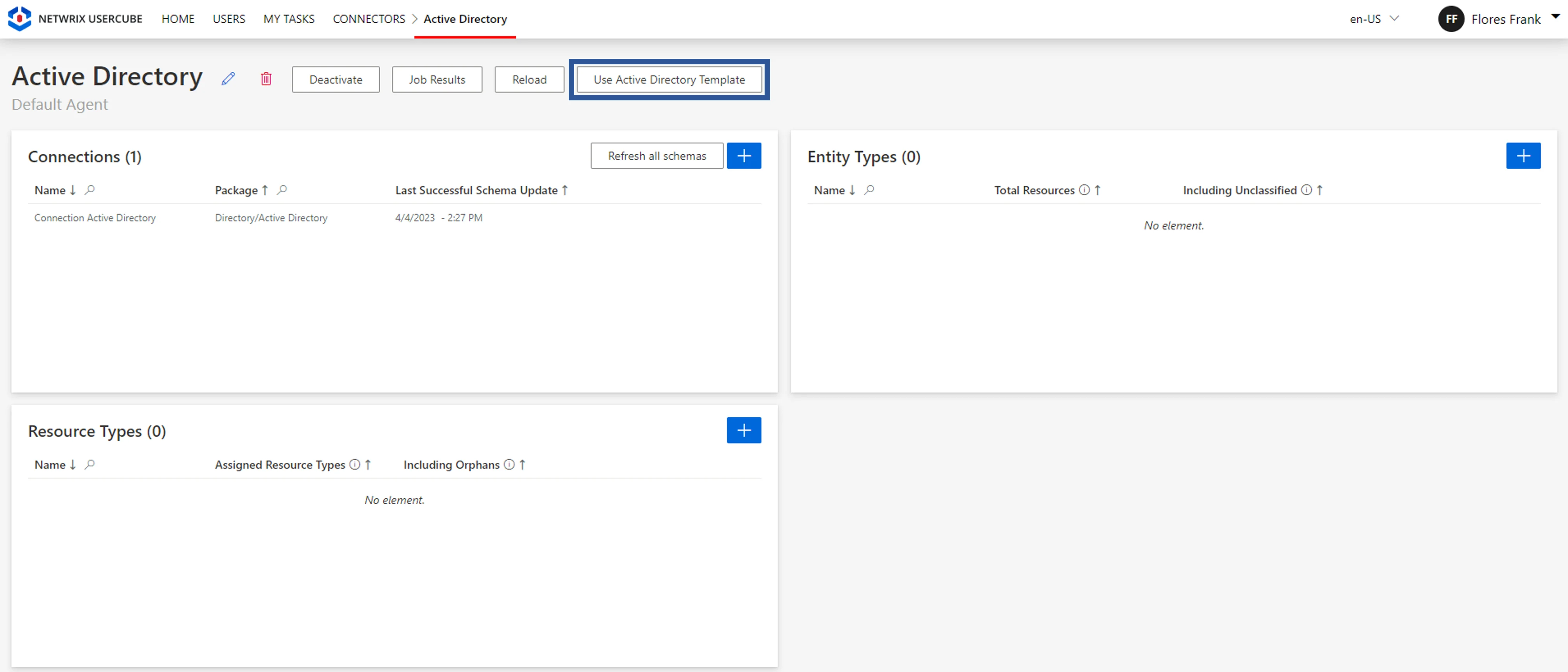

For some connectors, Usercube provides a template to automatically create a basic configuration. See below this note.
For example, the Active Directory template automatically creates an AD entity type and two resource types for a standard AD connector. The template is available for a connector with an AD connection but no entity types.
Entity Type - AD Template
