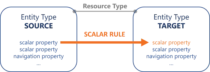

A scalar property's value can be computed by a scalar rule, based on at least one scalar property from the source entity type, possibly writing a C# expression.
Schema - Scalar Rule

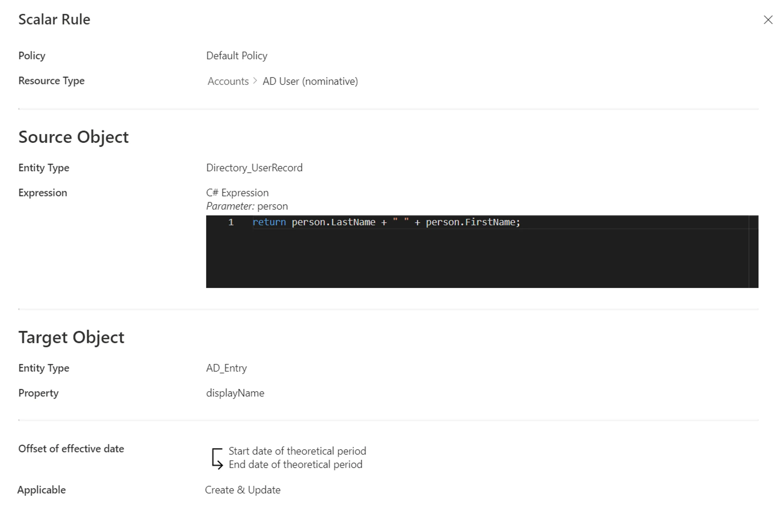

A scalar rule could define the scalar property displayName of nominative AD accounts based on its owner's name with the expression:
return person.LastName + " " + person.FirstName;

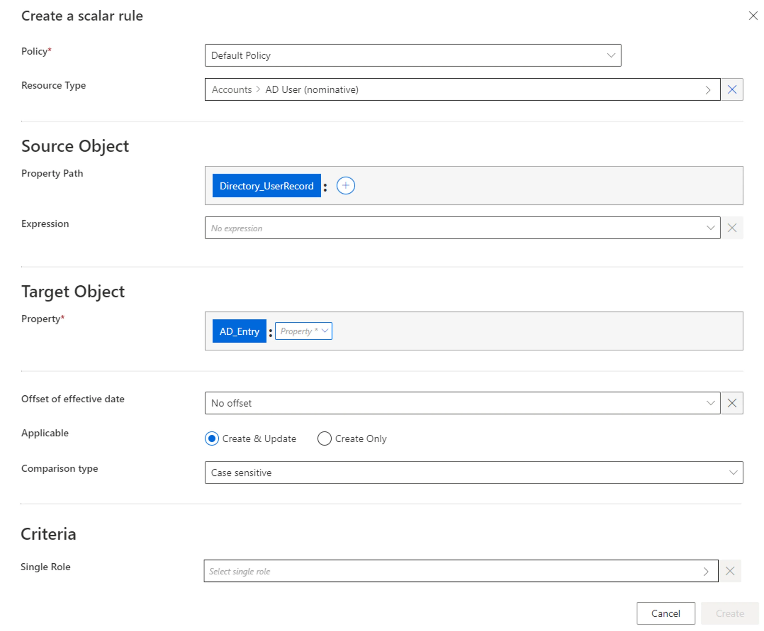

  4. Fill in the fields.
    Create Scalar Rule
    Once the Resource Type is provided, more fields appear.
    Scalar Rule Fields
    • Source Object: scalar property (or expression of scalar properties) from the source entity type, which constitutes the input for the computation of the target object. Can be defined by a property path and/or an expression.
    • Target Object: scalar property from the target entity type, whose value is to be impacted.
    • Offset of effective date: time period that defines the actual effective date for property computation according to the value's start and/or end date.
      For example, account activation and deactivation can be managed according to the start and/or end dates.
    • Applicable: Create & Update to use this computation to both provision the managed system and synchronize the property back to Usercube; Create Only to use this computation to only provision the managed system and ignore this property during synchronization, this way the property can never be displayed as non-conforming.
      CreateOnly is usually set to adapt the configuration to the constraints of the managed system, when Usercube does not retrieve and/or update the property value.
      For example, consider a system, that we want to connect to Usercube (let's call it SYST) using a title property. Consider also that SYST needs to be provisioned with the value of title, but does not allow any other system to retrieve said value.
      In this case, we use CreateOnly so that Usercube sends the adequate provisioning order when needed, and then is able to change the provisioning state to Verified without synchronization.
    • Comparison type: comparison type between the value of the target object computed by the rule and its value from the managed system. Non-conforming values are displayed on the Provisioning Review screen.
    • Criteria: conditions that, if met, trigger the rule application.
      Our example would look like:
      Scalar Rule Example
