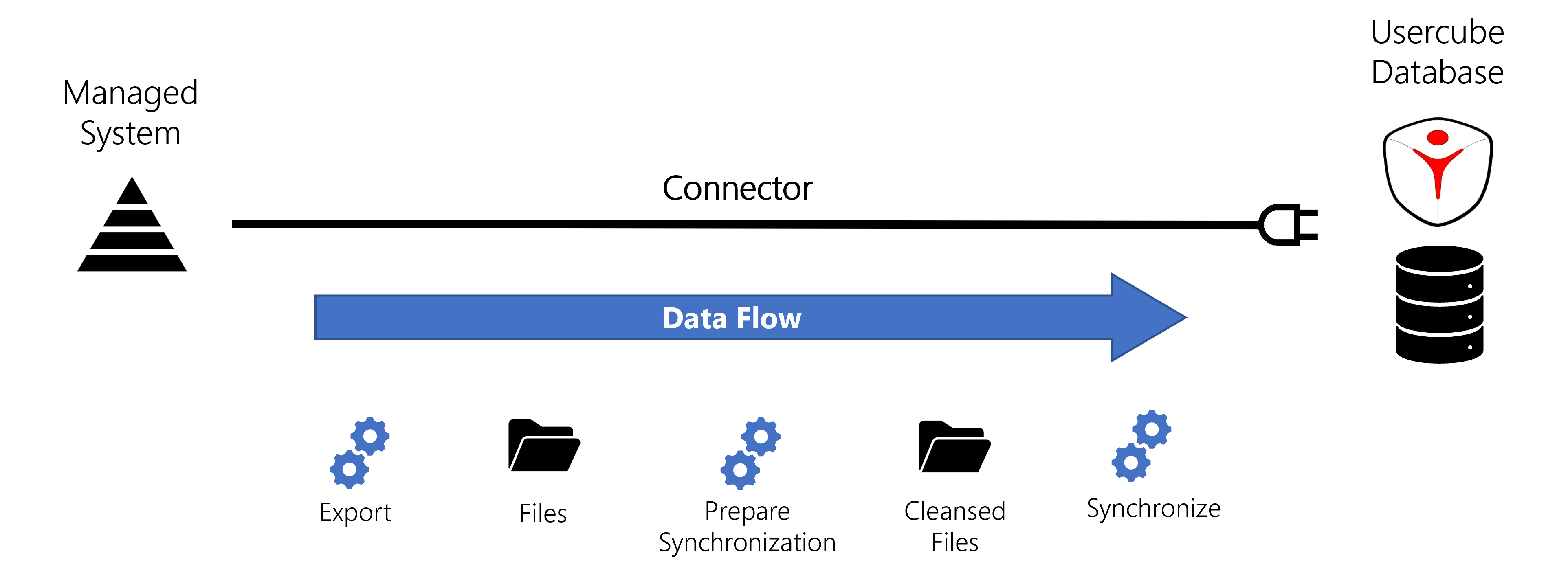

A connector's main purpose is to read and export the data previously mapped with entity types in order to synchronize it with Usercube. Connectors provide tools to perform a basic extraction of the system's data in the form of CSV/XLSX files. These files are cleansed and loaded into Usercube. Synchronization is a three-step ETL process going through export, synchronization preparation and the synchronization itself.

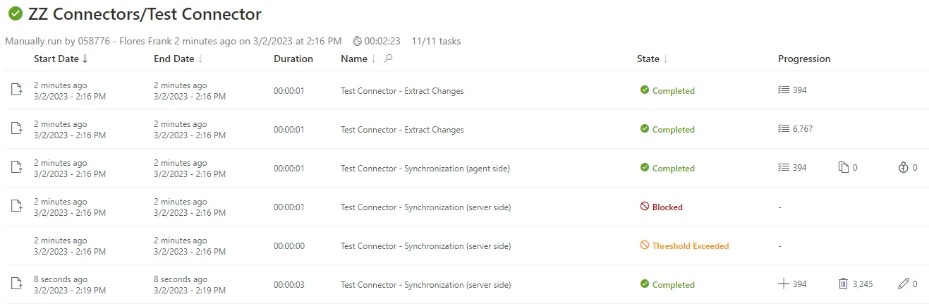

  2. Access the connector's logs (from Job Results on the connector's dashboard) to ensure that synchronization completed successfully.

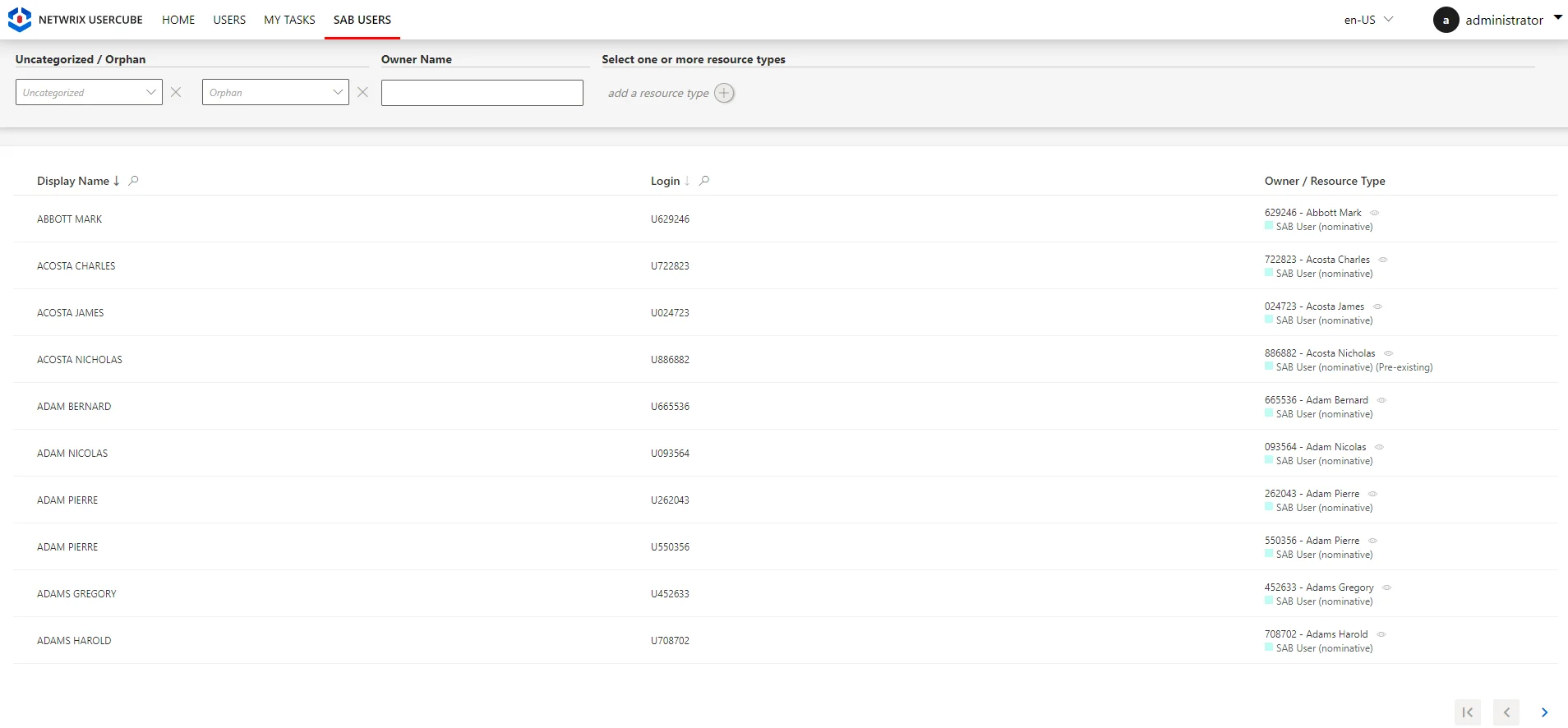

    Clicking on SAB - Users displays the list of all synchronized resources.
    SAB Example - Data List

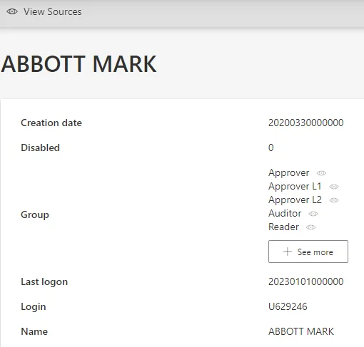

    Clicking on any resource displays its detailed attributes, for example Abbott Mark:
    SAB Example - Resource Attributes
    Clicking on any eye icon displays the corresponding resource. SAB was created here with a simple user-group schema that links n users to n groups. So here, we can check these links by navigating from a given user to one of their groups, to one of said group's users, to one of said user's groups, etc.

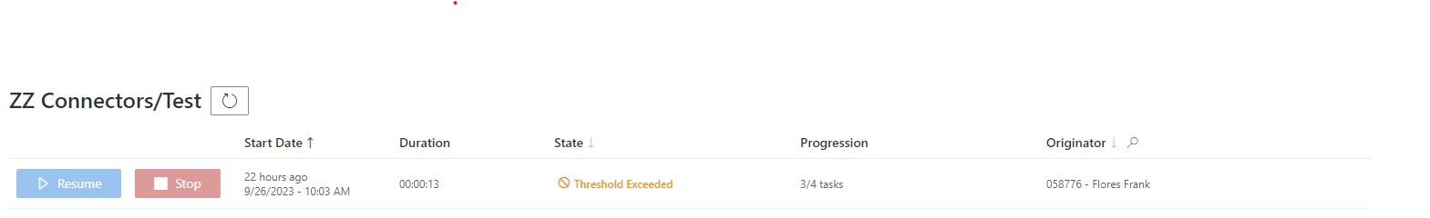

If a synchronization is blocked by an exceeded threshold, then�​
Threshold warning

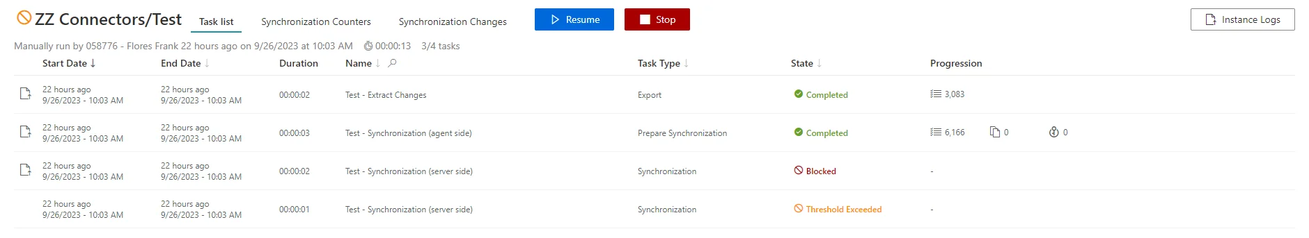

Find out the reasons to decide whether or not to bypass the threshold. Proceed as follows:
  1. On the logs page (accessible from the Job Results button), click on the line of a task instance to see its logs.
  2. Study synchronization counters and the list of all synchronization changes. These tools help you make a decision about whether to bypass synchronization thresholds.
    Job progress
    In most cases, the first synchronization exceeds thresholds because no data exists in Usercube yet. Thus, a high quantity of modifications is expected and the synchronization is to be resumed.

  3. If, after verifying, all changes are legitimate, click on the Resume button at the top of the job progress page. This will restart the job and allow the changes to be synchronized.
    Be cautious, check twice for mistakes before resuming.

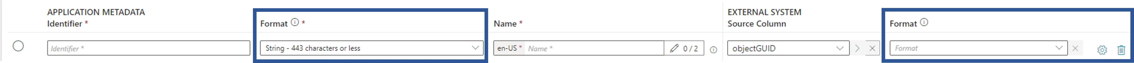

If a given property from users' data is displayed in an unexpected way, then�​
Check the format of both the application metadata and the external system.
Property Format
For example, if you find that a given date doesn't comply with what you set, then maybe the format in the External System section wasn't correctly selected, thus inducing a conversion error during the export computation.
