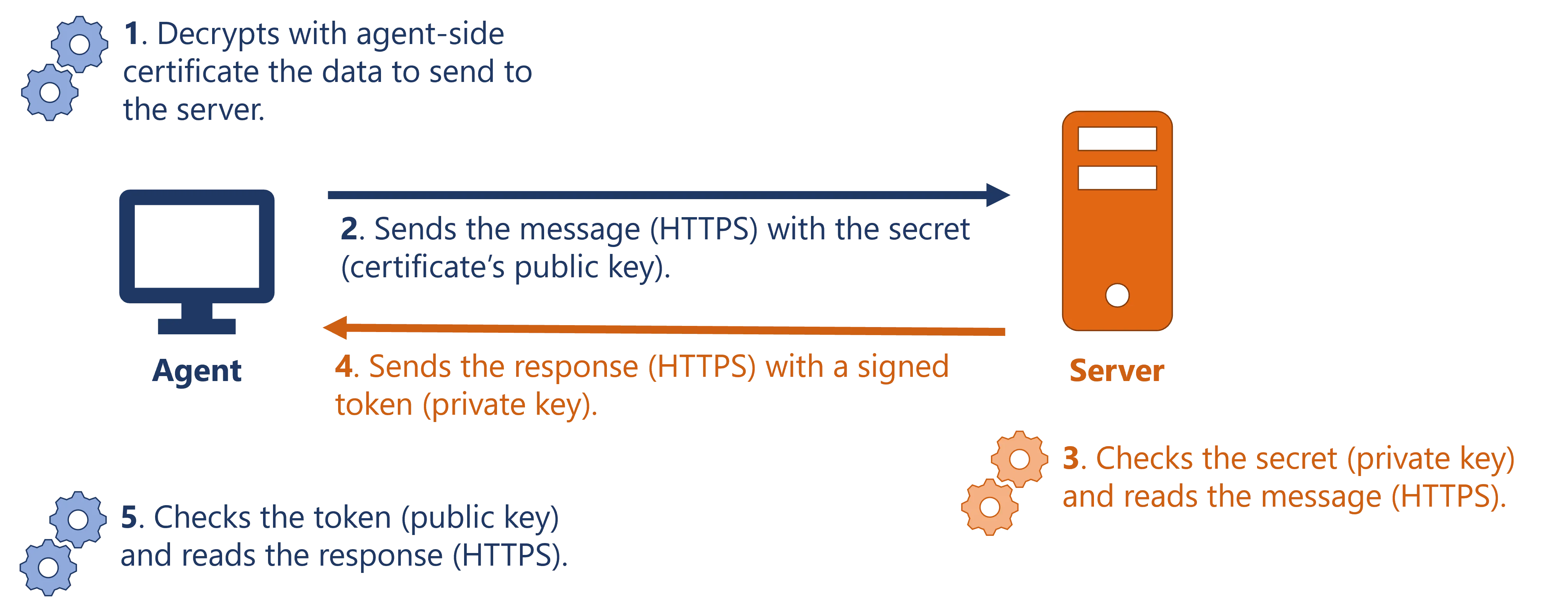

The idea, when sending data from the agent to the server, is the following:
- the agent decrypts its own data which was encrypted with the agent-side certificate;
- the agent calls the server, and sends its HTTPS-encrypted message;
- the server receives and decrypts the message, before encrypting it again with its own encryption certificate configured by Identity Manager.
