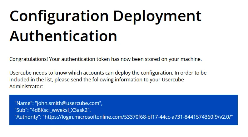

Log in to the IDP to be redirected back to this screen:
Once authenticated, an identification token is stored on your local machine for the authentication to Identity Manager's deployment and export processes.
Copy the entire text within the blue square and send it to your Identity Manager administrator.
The administrator will add the identity information to the configuration of your Identity Manager instance, to allow the configuration deployment/export.
