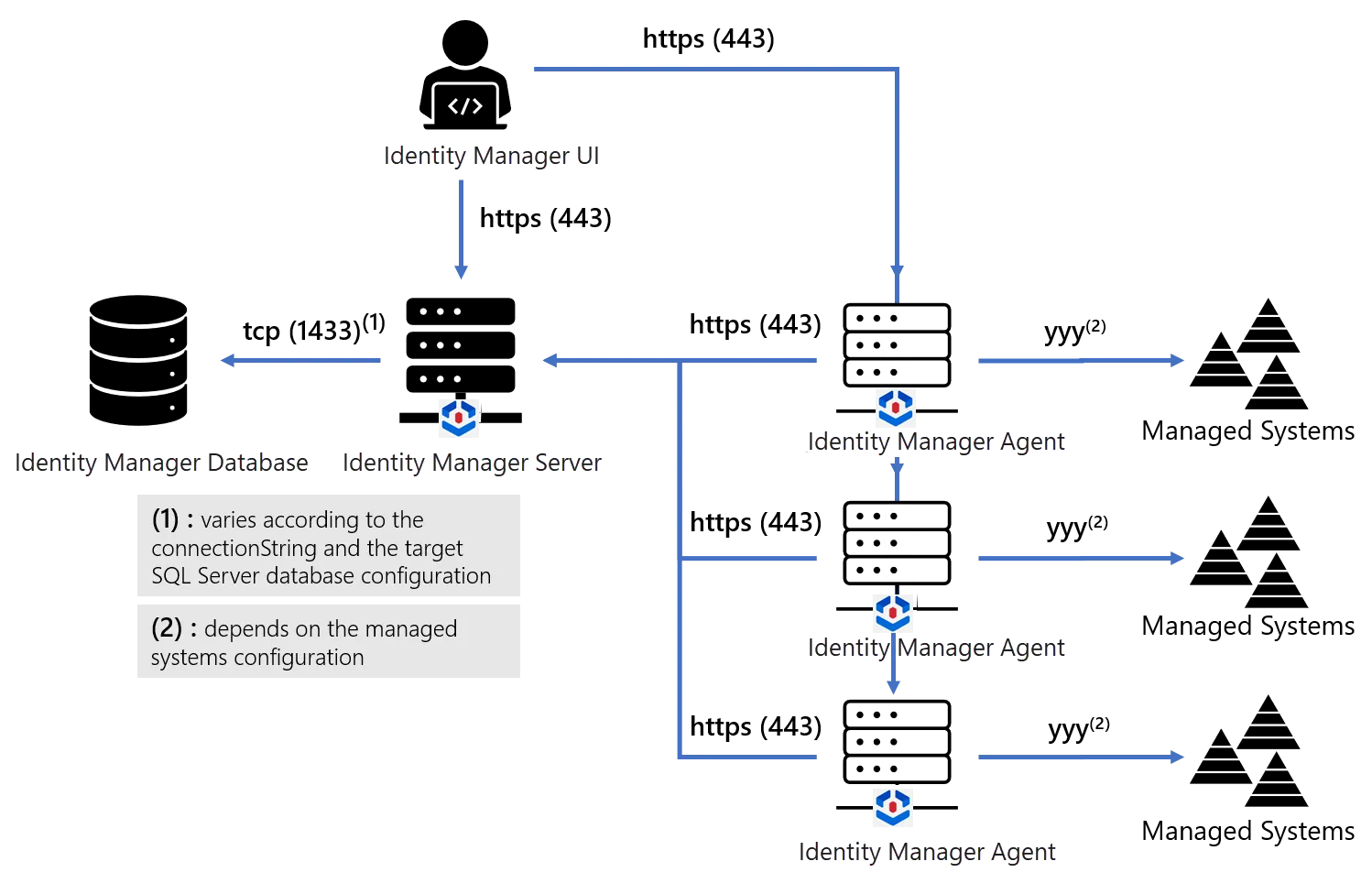

Identity Manager needs the following data flows to be enabled:
  • The Server requires opening connections to the Database.
  • The Agents require opening HTTPS connections to the Server.
  • The Agents require accessing managed systems.
  • All end-users' browsers require opening HTTPS connections to the Server.
  • All end-users' browsers require accessing the authentication providers. See the Install the Server topic for additional information.
  • Some end-users' browsers require opening HTTPS connections to the Agents.
    These connections are used to launch Jobs or use the Reset Password capabilities of some connectors. This requirement only applies to a few specific administrator type profiles.
  • The Server and the Agent both need to access an SMTP server to Send Notifications .

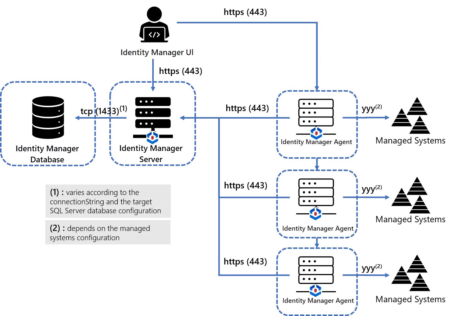

1. The server and agents are installed on separate workstations
This approach is useful when managed systems need to run on separate and isolated networks.
Server & Agents isolated

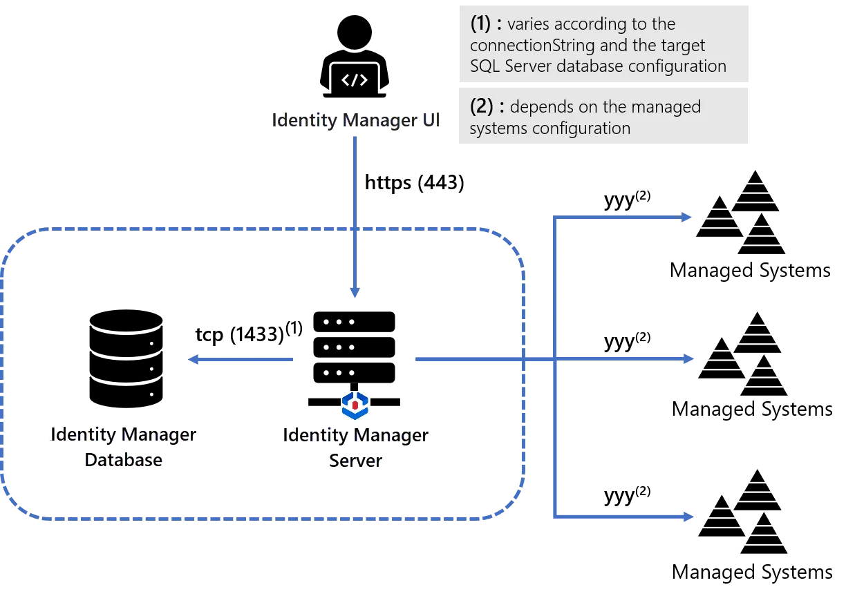

2. The Server and one Agent are installed on the same workstation
In that case, the Identity Manager Agent can run directly within the Identity Manager Server process. The hosting workstation would only host a Identity Manager Server process (with the integrated agent) and no separate agent needs to be installed. The database could be installed on the same workstation or on a separate one.
Server & Agent together

Isolation Principle
Identity Manager server has no direct access to the information system of the organization. It can be installed on an isolated network (typically in the cloud). Only the agent can read or write the information system. All exchanges between agent and server are operated through the HTTP protocol (HTTPS recommended in production).
Unidirectional Command Flow
All reading or writing actions in the information system are initiated by the agent. Identity Manager server will never call the agent. The Agent periodically polls the server to gather the actions to process.
Tasks can run on the Server side or on the Agent side.
Tasks that run on the Server side are still executed by an Agent. This is the application of the one-way data flow principle. Agents can send commands to the Server to execute a Task through an HTTP request but the Server cannot command an Agent, hence isolating the sensitive Agents from the exposed Server.
As a result, each set of planned Tasks is assigned to a specific Agent, depending on the managed systems its Tasks relate to.
Agents also receive HTTP/HTTPS requests from the browser to allow authenticated end-users to launch jobs from the UI.
