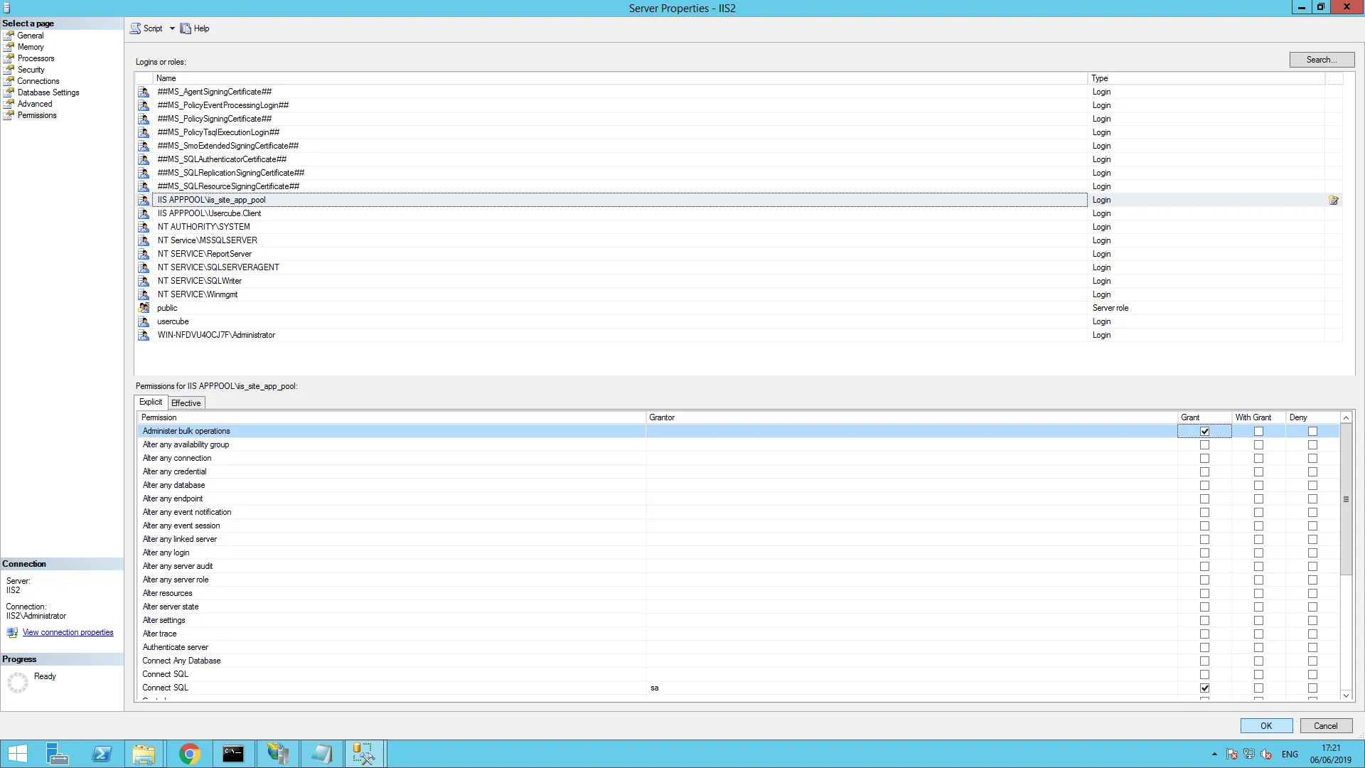

Bulk
Step 7 – Right-click the Server root node and select Properties, and in the Permissions tab, select the service account or group name.
Step 8 – Grant the Administer bulk operations permission. and confirm with OK.
Identity Manager Server now has the required permissions to access the database.

The second example sets a connection string using the SQL Server authentication. CONTOSO/identitymanagerContosoServer has been set as the Identity Manager Server IIS website identity.
Code attributes enclosed with <> need to be replaced with a custom value before entering the script in the command line.
appsettings.json
"ConnectionString": "data source=.;Database=Usercube;User Id=CONTOSO/identitymanagerContosoServer;Password=myPassword;Min Pool Size=10;encrypt=false;"
RECOMMENDED: SQL Server authentication stores plain text credentials in the configuration file. This is strongly discouraged. To avoid storing plain text credentials, you should always strive to use Windows authentication or encrypt sensitive setting values such as the connection string.
