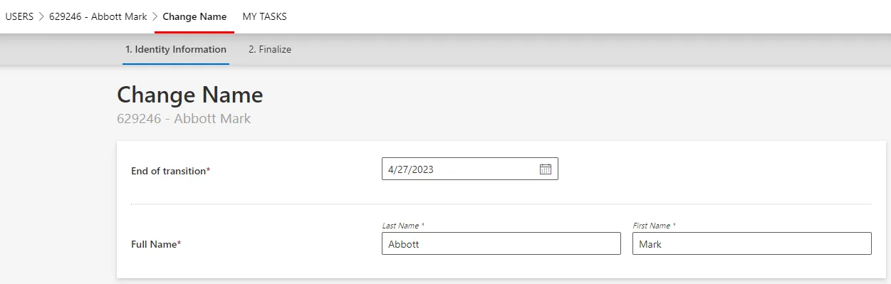

Examples
<WorkflowPerformerNotification Workflow="Directory_User_ChangeName"/>
Properties
PropertyDetails
Workflow optionalType String Description Identifier of the workflow involved in the scaffolding.
Generated XML
Our example generates the following configuration:
<NotificationAspect Identifier="PerformerNotification_Directory_User_ChangeName" ExpressionBinding="Workflow_Directory_User:Directory_User" RazorFile_L1="<div> <div style="font-family:'Segoe UI','-apple-system','BlinkMacSystemFont','Roboto','Arial',sans-serif; color:#212121; font-size:14px; background:#f8f8f8"> <table border="0" cellpadding="0" cellspacing="0" width="100%"> <tbody> <tr> <td class="x_mobile-hide" style="background-color:white; border-bottom:solid #eaeaea 1px"> </td> <td class="x_content" width="640" style="padding:0px; max-width:640px; background-color:white; border-bottom:solid #eaeaea 1px"> <table border="0" cellpadding="0" cellspacing="0" width="100%"> <tbody> <tr> <td style="padding:20px 24px 25px 24px; background:white"> <table border="0" cellpadding="0" cellspacing="0" width="100%" class="x_responsive-table"> <tbody> <tr> <td> <table border="0" cellpadding="0" cellspacing="0" class="x_logo" width="100%"> <tbody> <tr> <td valign="middle" style="vertical-align:middle"> <img data-imagetype="External" src="@(new System.Uri(Html.Context.ApplicationUri, "logo.webp").AbsoluteUri)" height="34" width="133"> </td> </tr> </tbody> </table> </td> </tr> </tbody> </table> </td> </tr> <tr> <td class="x_hero" style="padding:0px 24px"> <table border="0" cellpadding="0" cellspacing="0" width="100%" class="x_responsive-table" style="max-width:592px"> <tbody> <tr> <td> <table width="100%" border="0" cellspacing="0" cellpadding="0"> <tbody> <tr> <td> <!-- HEADER START --> <table> <tbody> <tr> <td class="x_title" style="padding:0 0 24px 0; color:#212121; font-size:28px; font-weight:bold; letter-spacing:-0.04em; line-height:40px; word-break:break-word"> @(Html.Context.MessageSubject ?? "Request summary")

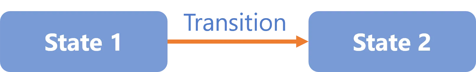

This section describes the activities that constitute and model a Workflow . Each activity is assigned a template, made of states and transitions.
Overview
Going through an activity means going through states and transitions.
Activity Template - Example

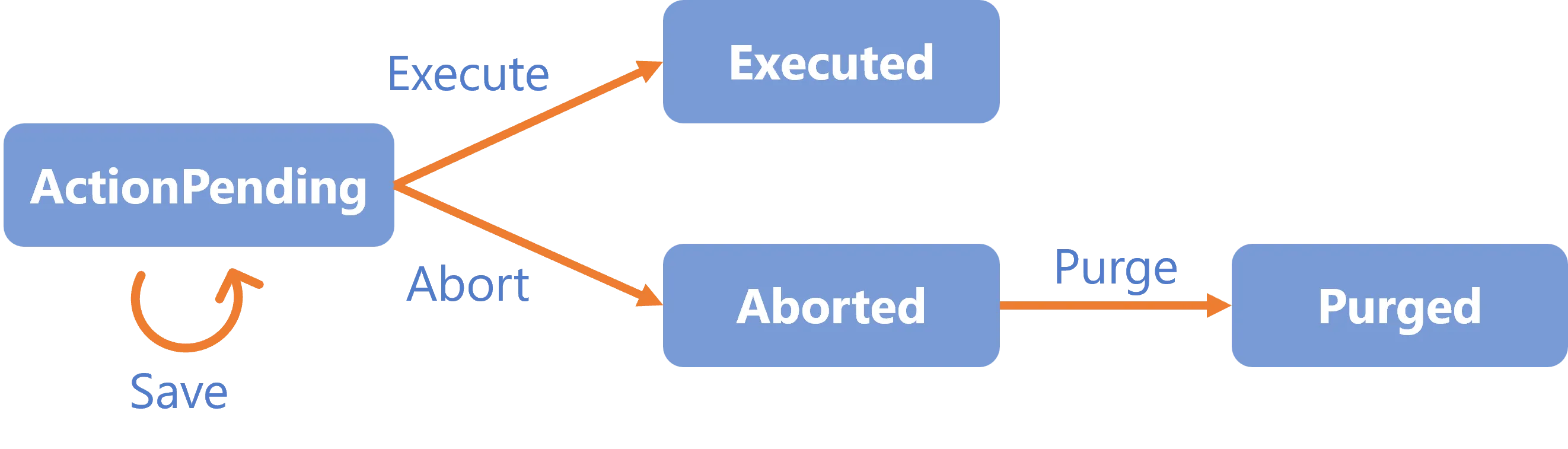

Action
Awaits user modifications without another user's intervention.
Activity Template - Action

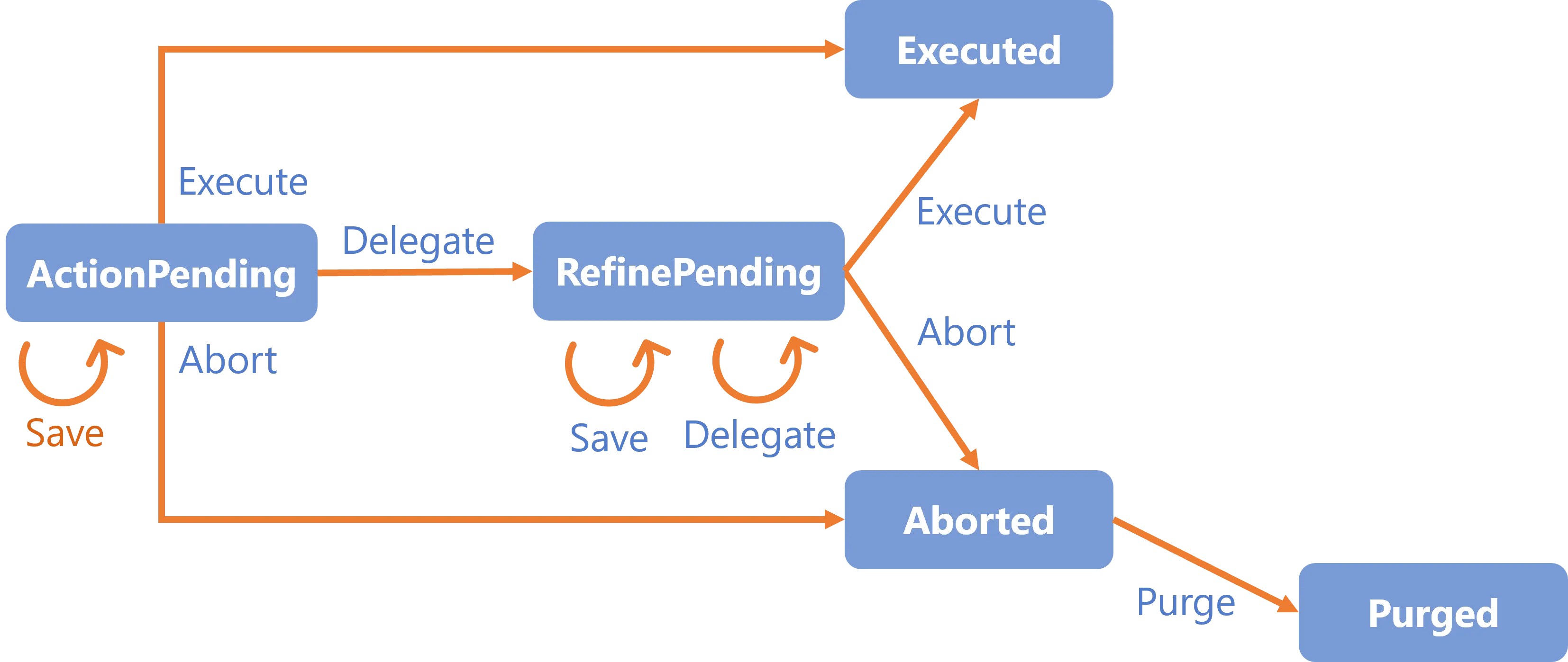

ActionWithRefine
Awaits user modifications with the possibility to delegate the action to another user.
Activity Template - ActionWithRefine

States
By default, Identity Manager's workflow engine implements the following state templates:
  • Action-ActionPending
  • Action-Executed
  • Action-Aborted
  • Action-Purged
  • ActionWithRefine-ActionPending
  • ActionWithRefine-Executed
  • ActionWithRefine-RefinePending
  • ActionWithRefine-Aborted
  • ActionWithRefine-Purged

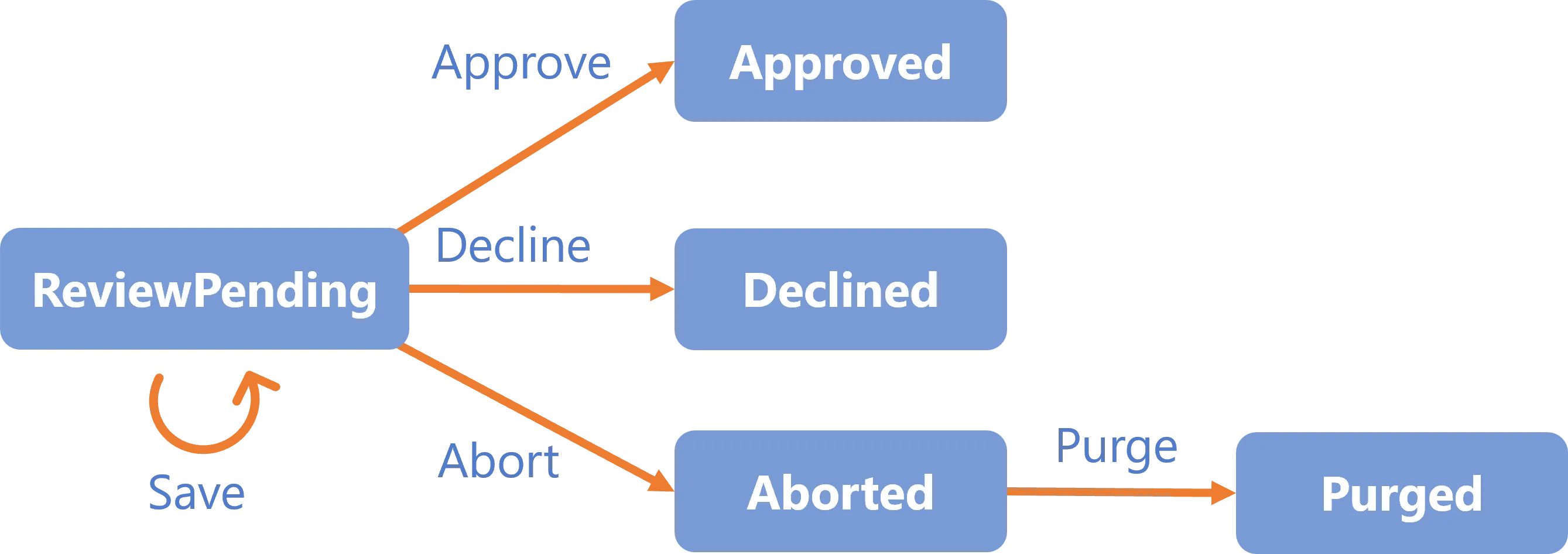

  • Review-ReviewPending
  • Review-Declined
  • Review-Approved
  • Review-Aborted
  • Review-Purged

  • ActionWithRefine-ActionPending-Save
  • ActionWithRefine-ActionPending-Execute
  • ActionWithRefine-ActionPending-Delegate
  • ActionWithRefine-ActionPending-Abort
  • ActionWithRefine-RefinePending-Save
  • ActionWithRefine-RefinePending-Delegate
  • ActionWithRefine-RefinePending-Execute
  • ActionWithRefine-RefinePending-Abort
  • ActionWithRefine-Aborted-Purge
  • Review-ReviewPending-Save
  • Review-ReviewPending-Approve
  • Review-ReviewPending-Decline
  • Review-ReviewPending-Abort
  • Review-Aborted-Purge

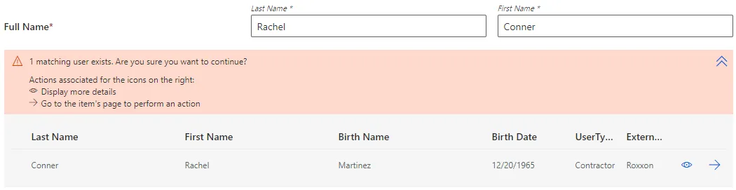

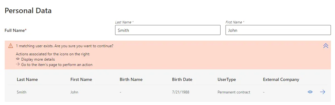

Configure a Homonym Detection
In this section we configure the homonym search that checks if a resource already exists in the system, preventing duplicates.
Process
  1. Create a homonym entity link, either with a default filter or customized filters
  2. Create a display table to display the homonym result (optional)
  3. Define the part of the workflow form where homonyms must be checked
A Homonym Entity Link defines a new homonym search to be performed in a workflow form. It can be defined in different ways.
With a default filter
<HomonymEntityLink FormEntityType="Directory_UserRecord" Identifier="Directory_UserRecord_Homonym" />
When no filter is defined for the homonym entity link, the search for homonyms is performed according to the homonym control form. See the Configure a Homonym Detection topic for additional information.
With customized filters
Homonym Entity Link filters allow to define customized filters for a homonym search.
Simple filter
<HomonymEntityLink FormEntityType="Directory_UserRecord" Identifier="Directory_UserRecord_Homonym"> <Filter
Property1="LastName"
Property2="FirstName"
/></HomonymEntityLink>
Here, since the default operator is Equal, the search for homonyms is performed by comparing the values of the LastName and FirstName properties with an exact spelling.
NB: This example matches the default filter that would be computed based on the homonym control example in the section below.

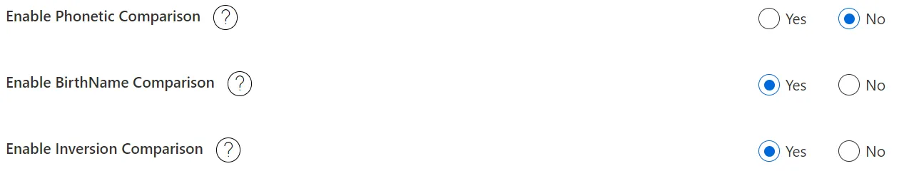

Flexible filter
A filter can be defined to compare the values in an approximate way.
  • A flexible operator must be used, such as FlexibleEqual, FlexibleStartWith, etc.
  • A flexible expression must be defined on the comparison property.
  1. When the input search value is retrieved directly from the property value

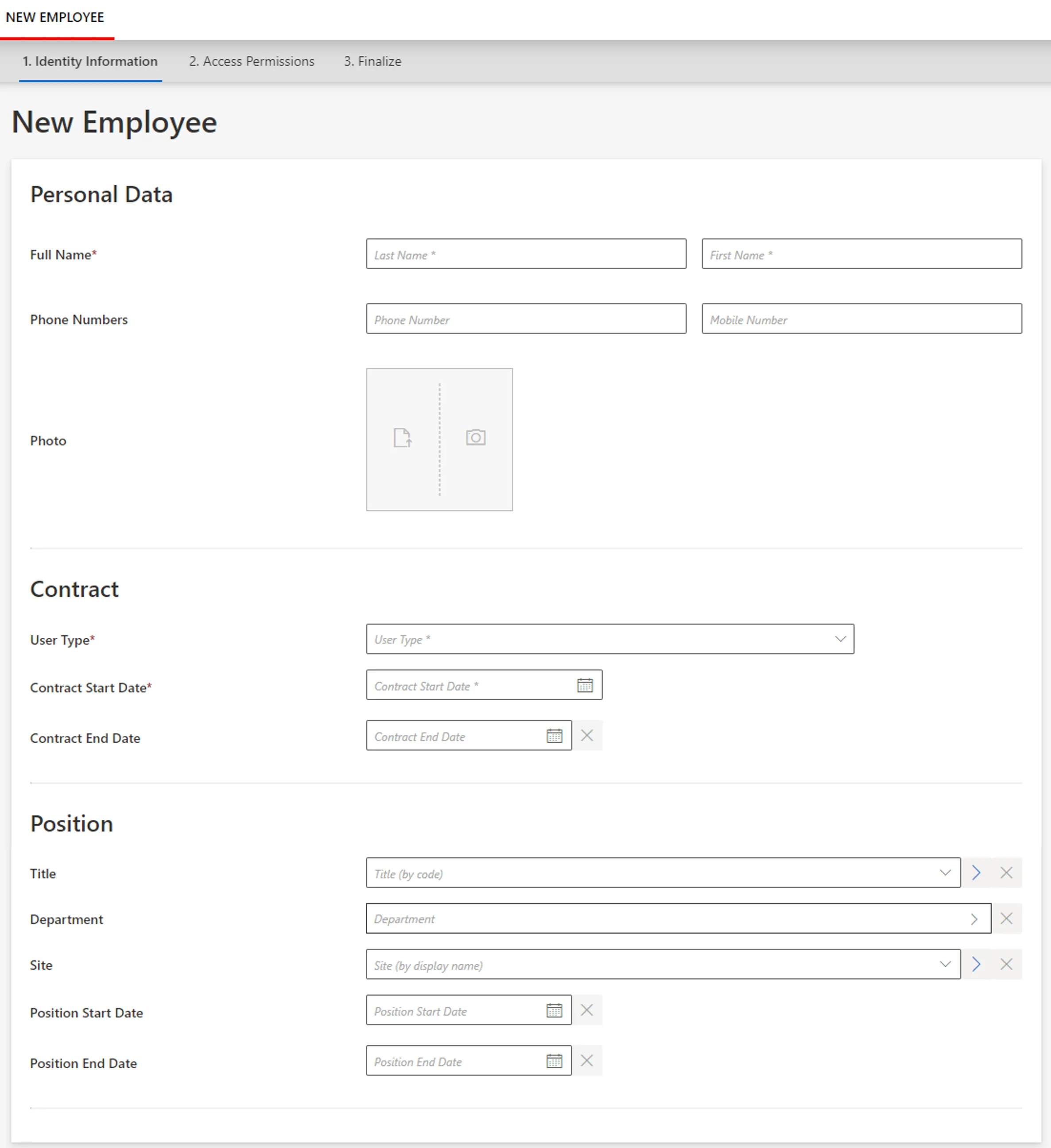

UI Form

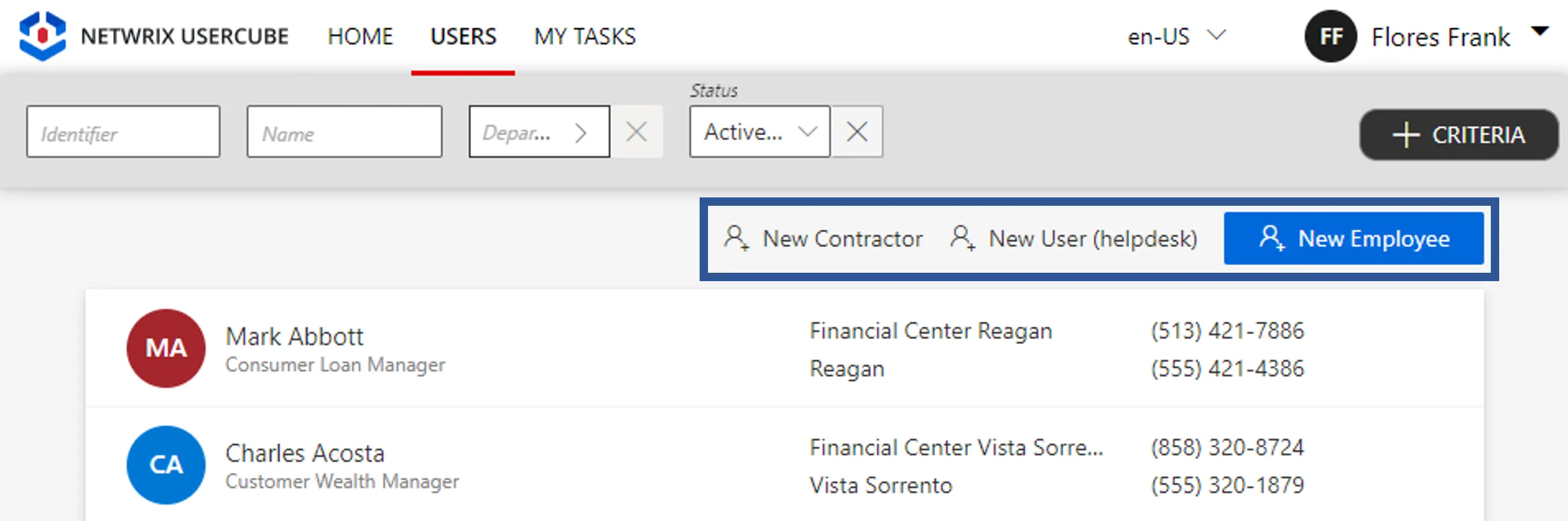

Create Menu Items in the UI
Menu Item must be defined to make the workflow accessible in the UI.
Creating a new resource, an interesting location for this workflow could be the users list page.
Workflow Menu Items - Users List
To create a menu item here for the new workflow, you can add the following XML configuration to the existing menu items list:
<MenuItem Identifier="Menu_Search_Directory_User" DisplayName_L1="Menu"> ...
<MenuItem Identifier="Menu_Search_Directory_User_NewInternal" DisplayName_L1="New Employee" IconCode="AddFriend" Workflow="Directory_User_NewInternal" /></MenuItem Identifier="Menu_Search_Directory_User" DisplayName_L1="Menu">

Homonym Detection (Optional)
To perform a homonymy check on a workflow and thus prevent user duplicates see the Configure a Homonym Detection topic for additional information.
When using records, the homonym detection displays the list of records and not just the list of users.
Below is an example where a homonym entity link, based on the user's name, is called in the workflow form:
Homonym detection:
<HomonymEntityLink Identifier="Homonym_Directory_UserRecord" FormEntityType="Directory_UserRecord">
<Filter
Property1="FirstName"
Property2="LastName"
/> <Filter
Property1="FirstName" ComparisonProperty1="LastName"
Property2="LastName" ComparisonProperty2="FirstName"
/> <Filter
Property2="LastName" ComparisonProperty2="BirthName"
Partial form for user data:
<Control DisplayName_L1="Personal Data" DisplayName_L2="Informations personnelles" OutputType="LayoutFieldset" HomonymEntityLink="Homonym_Directory_UserRecord"> <Control DisplayName_L1="Full Name" DisplayName_L2="Nom complet" OutputType="LayoutRowset"> <Control Binding="LastName" IsRequired="true" /> <Control Binding="FirstName" IsRequired="true" /> </Control></Control>...
UI Homonym Detection

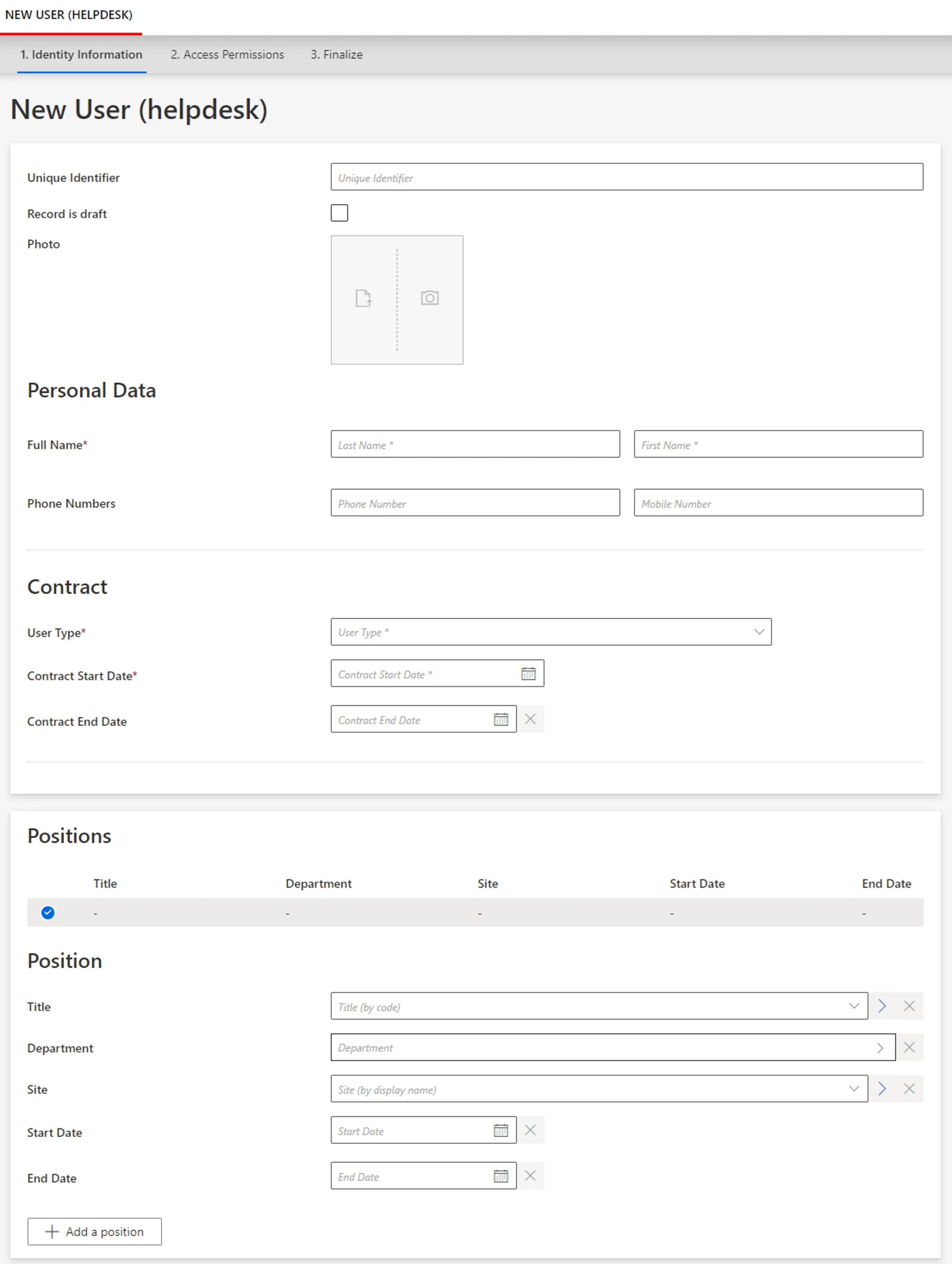

UI Form

Homonym detection:
<Filter
/> <Filter
/> <Filter

Create Forms
The XML configuration below represents the creation of a Form that defines the elements to display in the workflow.
Here we just have the full name field to update the corresponding attributes for a given user:
<Form Identifier="Workflow_Directory_User_ChangeName_Base" EntityType="Workflow_Directory_User"> <Control DisplayName_L1="Full Name" OutputType="LayoutRowset" EntityType="Directory_UserRecord"> <Control Binding="LastName" /> <Control Binding="FirstName" /> </Control></Form>
After creating a workflow with given activities, it is necessary to create the form to be displayed when launching the workflow. It has the type corresponding to a (unique) record's replacement, i.e. WorkflowAddAndEndRecordEntityForm and it must specify the workflow's context (the entity type of the involved resources, the main property, the activity when the form is called, etc):
<WorkflowAddAndEndRecordEntityForm Identifier="Workflow_Directory_User_ChangeName" EntityType="Workflow_Directory_User" MainProperty="Workflow_Directory_User:Directory_User" RecordProperty="Directory_User:Records" WorkflowRequestType="Self" Activity="Directory_User_ChangeName:Request" HideRoles="true" FormTitle_L1="Change Name"></WorkflowAddAndEndRecordEntityForm>

UI Form
End of transition sets the date for the change of records scheduled by this form.

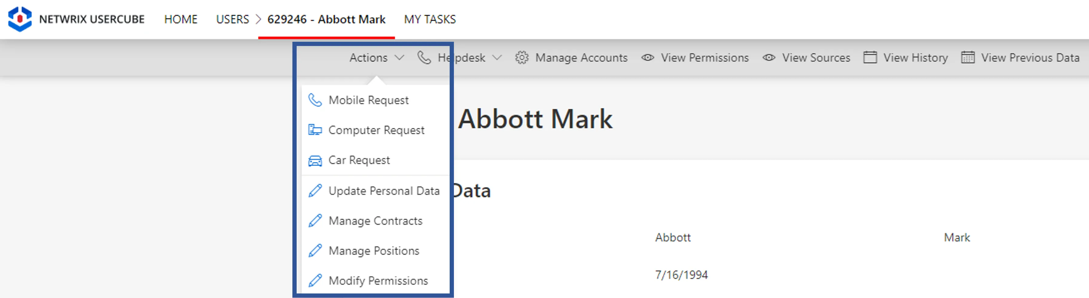

Updating an existing resource, this workflow manages one given resource at a time. Hence an interesting location for this workflow could be the individual view page of users.
Workflow Menu Items - User&#39;s Page
<MenuItem Identifier="Menu_Directory_User" DisplayName_L1="Menu"> <MenuItem Identifier="Menu_Directory_User_Changes" DisplayName_L1="Actions"> <MenuItem Identifier="Menu_Directory_User_Changes_Update" DisplayName_L1="Section"> ...
<MenuItem Identifier="Menu_Directory_User_Changes_ChangeName" DisplayName_L1="Update Name" IconCode="Edit" Workflow="Directory_User_ChangeName" />
</MenuItem> </MenuItem></MenuItem>
To perform a homonymy check on a workflow and thus prevent user duplicates, see the Configure a Homonym Detection topic for additional information.

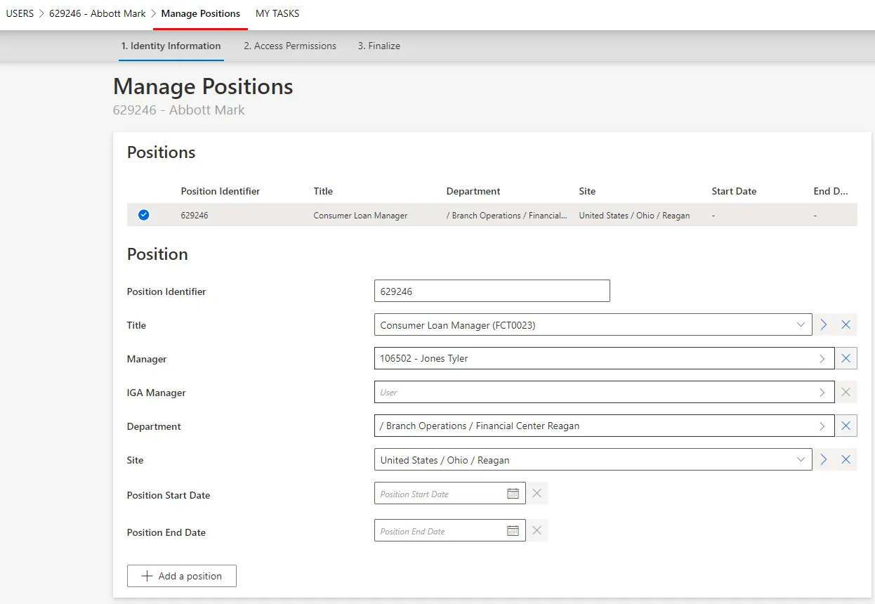

UI Form

Permissions
For each workflow, some permissions must be assigned to specific Profile so that said profiles are entitled to realize the workflow's actions.
While assigning the specific permissions of a workflow, it is necessary to assign the involved profiles a few essential rights via the Workflow Access Control Rules scaffolding.
A workflow needs a permission for each of all its activity states involving user interaction. This means that, for example, the activities following the templates Persist and Persist Only Resources do not require any permission. This also means that, in the example of the Action template, a workflow would need permissions for the states ActionPending, Aborted and Purged (because deletion requires an authorization), but not for the state Executed that does not involve user interaction or special authorization. See the Activity Templates topic for additional information.
All these permissions can be shared and distributed among several profiles, according to the purpose of the workflow.
Identity Manager's permissions are assigned through Access Control Rule and follow the naming rule: /Custom/workflows/{workflow_identifier}/{activity_identifier}/{activityTemplateState_shortIdentifier}.
For example: Permission="/Custom/Workflows/Directory_User_StartInternal/Request/ActionPending" gives the right to act from the state ActionPending (so save, execute, etc.), inside a previously created activity Request, inside the workflow Directory_User_StartInternal.
A permission specifying the activity without the activity state gives the permissions for all activity states in this activity.
For example: Permission="/Custom/Workflows/Directory_User_StartInternal/Request" Caution: this way of writing permissions is unsafe in case of a modification in the activity. So use it only for a "super admin" kind of profile if you are certain you want to give all rights.
Menu Item make workflows accessible from the UI.
Identity Manager's UI is configured so that workflows are accesible from:
  • the list of users accessible from the Directory section on the home page; Workflow Menu Items - Users List
  • the view page of a given user. In this case, the workflows manipulate the selected user. Workflow Menu Items - User&#39;s Page

Homonym Detection
User creation often benefits from a homonym detection that checks if the resource already exists in the system, preventing duplicates.
Identity Manager provides a homonym detection, whose parameters can be adjusted.
See the Workflows topic for additional information.

  3. Configure the homonym detection.
    Workflows Homonym Detection
    Netwrix Identity Manager (formerly Usercube) recommends enabling the birth name comparison to detect user duplicates due to name changes, when the GDPR supports it.
    The other parameters for homonym detection should be enabled/disabled according to your needs.

  1. Access the user directory from the home page.
    Home Page - Directory User
  2. Execute the workflows for a new employee and a new contractor.
  3. Make sure that the homonym detection works in accordance with the specified options.
    For example, if the inversion comparison is enabled between the first and last names:
