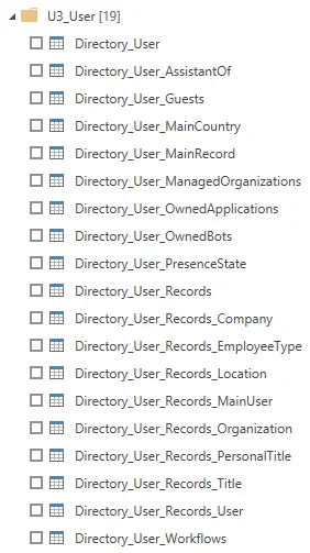

The following example generates a universe U8_Users based on the entity type Directory_User, like our U1 but without the Guests property:
<Universe Identifier="U8_Users" DisplayName_L1="U8 - Users" ColumnNamesMode="Identifier" />
<UniverseDataModel Universe="U8_Users" EntityType="Directory_User" >
<ExcludedProperty Property="Guests"/>
</UniverseDataModel>
When getting Identity Manager data in Power BI, we see the following: Universe (ExcludedProperty)

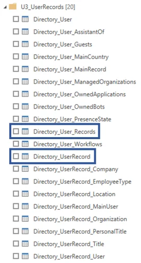

RootInstance for several scaffoldings together​
info
A universe can be made of several scaffoldings which need to be grouped together a specific way. One universe made of two scaffoldings will generate the two entity instances corresponding to the two specified entity types, with the entity and association instances corresponding to their navigation properties. To avoid data duplication in the universe model, we use RootInstance to rename one of the entity instances and follow the existing naming rule explained in the introduction.
&lt;Universe Identifier="U3_UserRecords" DisplayName_L1="U3 - User Records" ColumnNamesMode="Identifier" /&gt;
&lt;UniverseDataModel Universe="U3_UserRecords" EntityType="Directory_User" /&gt;
&lt;UniverseDataModel Universe="U3_UserRecords" EntityType="Directory_UserRecord" /&gt;
Universe Schema (Several Scaffoldings with Data Duplication)
When getting Identity Manager data in Power BI, we see the following: Universe (Several Scaffoldings with Data Duplication) We see that Directory_User_Records and Directory_UserRecords represent the same entity instances.
The following example generates a better version of the universe U3_UserRecords based on the entity types Directory_User and Directory_UserRecord, renaming Directory_UserRecord as Directory_User_Records to follow the naming rule, thus building the universe model with Directory_User as the core entity instance:
&lt;UniverseDataModel Universe="U3_UserRecords" EntityType="Directory_UserRecord" &gt;
<b>&lt;RootInstance Instance="Directory_User_Records" /&gt;</b>
&lt;/UniverseDataModel&gt;
Universe (Several Scaffoldings without Data Duplication)
When getting Identity Manager data in Power BI, we see the following: Universe (Several Scaffoldings without Data Duplication) Thus we removed the duplicated data, and we understand easily the navigations of the model.

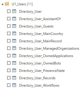

Default Template​
When no template is specified, the scaffolding generates:
  • an entity instance based on a given entity type;
  • an association instance and an entity instance for each navigation property of the entity type.

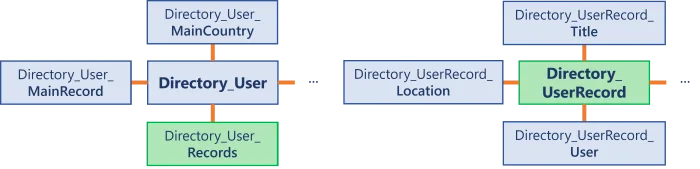

The following example generates a universe U1_Users based on the entity type Directory_User:
<Universe Identifier="U1_Users" DisplayName_L1="U1 - Users" ColumnNamesMode="Identifier" />
<UniverseDataModel Universe="U1_Users" EntityType="Directory_User" />
It generates:
<Universe Identifier="U1_Users" DisplayName_L1="U1 - Users" ColumnNamesMode="Identifier" >
One entity instance for the entity type Directory_User:
<EntityInstance Identifier="Directory_User" DisplayName_L1="User" EntityType="Directory_User" />
One association instance and one entity instance per navigation property:
<AssociationInstance Association="Directory_User_MainCountry" Instance1="Directory_User" Instance2="Directory_User_MainCountry" Direction="From1To2" />
<EntityInstance Identifier="Directory_User_MainCountry" DisplayName_L1="Main Country" EntityType="Directory_Country" />
</Universe>
Universe (No Template)
When getting Identity Manager data in Power BI, we see the following: Universe (No Template)

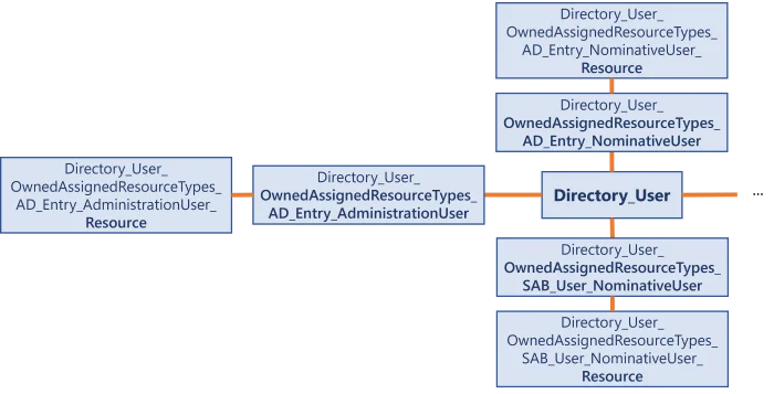

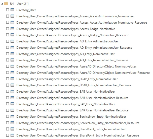

The following example generates a universe U4_User based on the entity type Directory_User and the resources assigned to users:
&lt;Universe Identifier="U4_User" DisplayName_L1="U4 - User" ColumnNamesMode="Identifier"/&gt;
&lt;UniverseDataModel Universe="U4_User" EntityType="Directory_User"&gt;
<b>&lt;UniverseTemplate Template="OwnedResourceTypes"/&gt;</b>
It generates:
&lt;Universe Identifier="U4_User" DisplayName_L1="U4 - User" ColumnNamesMode="Identifier"&gt;
<em>One entity instance for the entity type Directory_User.</em>
&lt;EntityInstance Identifier="Directory_User" DisplayName_L1="User" EntityType="Directory_User" /&gt;
<em>Association instances and entity instances about the AD_Entry_NominativeUser resource type:</em>
&lt;EntityInstance Identifier="Directory_User_OwnedAssignedResourceTypes_AD_Entry_NominativeUser" DisplayName_L1="Assigned AD User (nominative)" EntityType="AssignedResourceType" FilterProperty="RoleId" FilterResourceType="AD_Entry_NominativeUser" /&gt;
&lt;EntityInstance Identifier="Directory_User_OwnedAssignedResourceTypes_AD_Entry_NominativeUser_Resource" DisplayName_L1="AD User (nominative)" EntityType="AD_Entry" /&gt;
&lt;AssociationInstance Association="AssignedResourceType.Resource" Direction="From1To2" Instance1="Directory_User_OwnedAssignedResourceTypes_AD_Entry_NominativeUser" Instance2="Directory_User_OwnedAssignedResourceTypes_AD_Entry_NominativeUser_Resource" /&gt;
&lt;AssociationInstance Association="AssignedResourceType.Owner" Direction="From2To1" Instance1="Directory_User_OwnedAssignedResourceTypes_AD_Entry_NominativeUser" Instance2="Directory_User" /&gt;
<em>Same for all resource types.</em>
&lt;/Universe&gt;
Universe (Template Schema: Owned Resource Types)
When getting Identity Manager data in Power BI, we see the following: Universe (Template: Owned Resource Types)

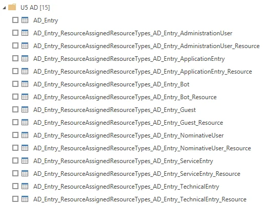

ResourceResourceTypes​

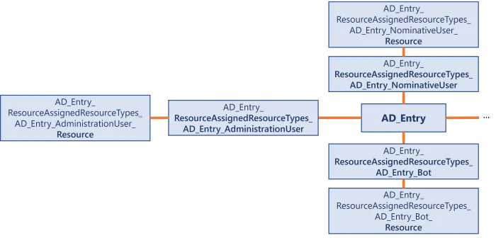

The following example generates a universe U5_AD based on the entity type AD_Entry and the owners of AD resources:
&lt;Universe Identifier="U5_AD" DisplayName_L1="U5 AD" ColumnNamesMode="Identifier"/&gt;
&lt;UniverseDataModel Universe="U5_AD" EntityType="AD_Entry"&gt;
<b>&lt;UniverseTemplate Template="ResourceResourceTypes"/&gt;</b>
The configuration generated by this snippet is similar to the one for OwnedResourceTypes.
Universe (Template Schema: Resource Resource Types)
When getting Identity Manager data in Power BI, we see the following: Universe (Template: Resource Resource Types)
