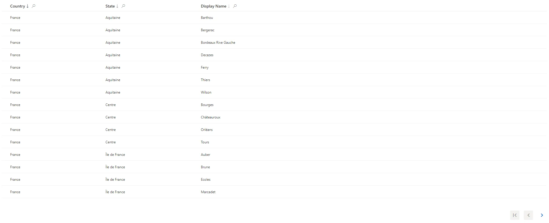

The following example displays sites as a table.
<DisplayTable Identifier="Directory_Site" EntityType="Directory_Site" DisplayTableDesignElement="table" IsEntityTypeDefault="true">
<Column DefaultSortPriority="1" DisplayBinding="Region.Country.DisplayName" IsDisplayInSummaryView="true" IsResizable="true" IsSortable="true" CanBeFiltered="true" ColumnSize="2" DisplayName_L1="Country" />
<Column DefaultSortPriority="2" DisplayBinding="Region.DisplayName" IsDisplayInSummaryView="true" IsResizable="true" IsSortable="true" CanBeFiltered="true" ColumnSize="2" DisplayName_L1="State" />
<Column DefaultSortPriority="3" DisplayBinding="DisplayName" IsDisplayInSummaryView="true" IsResizable="true" IsSortable="true" CanBeFiltered="true" ColumnSize="8" />
</DisplayTable>
Example - DisplayTableDesignElement Set to Table
