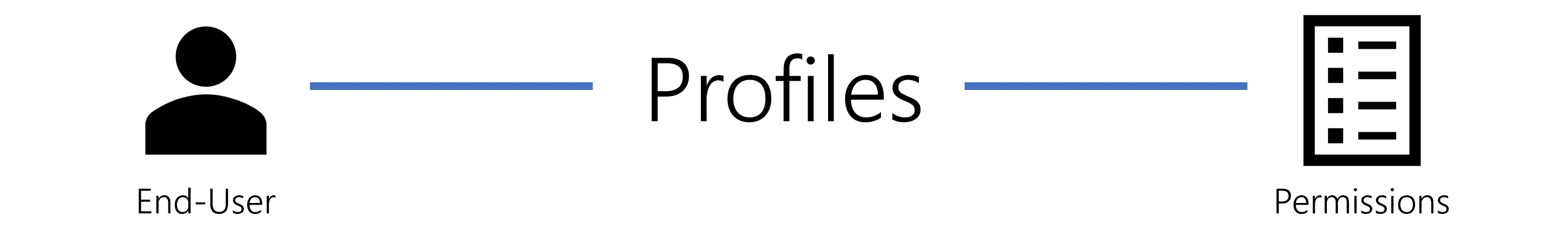

All the permissions to access items in Identity Manager, and to perform given actions, are managed by assigning profiles to users and permissions to profiles. See the Assigned Profile and References: Permissions topics for additional information.
Schema - Profile Assignment
For example, the access to the list of users with their personal data is usually restricted to HR people, and the possibility to modify personal data restricted to HR managers.
We define here a permission as an entitlement within Identity Manager. See the Configure a User Profile topic for additional information.
Users are assigned profiles according to the permissions they need to work, at least one profile per user. A user without a profile cannot access the application. Experience shows that most users have one profile, sometimes two, and rare case have maximum three, or more.
