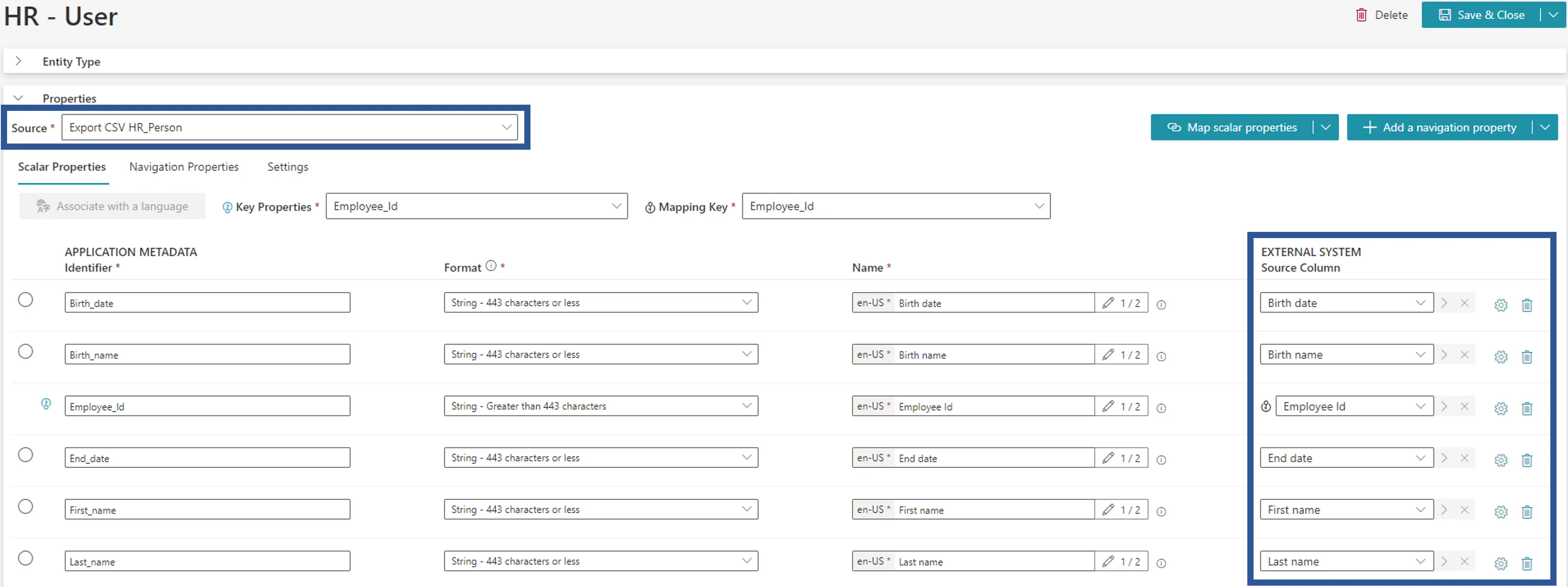

Connection Tables
A Connection Table represents the potential output of the connection's Export Task , when the connection's package allows export. The export process generates CSV files (our connection tables) whose names start with the connection's identifier. The files' suffixes depend on the connector. See the References: Connectors topic for additional information.
The name of these files are used to specify the connection tables of the Entity Type Mapping and Entity Association Mapping in order to link the connectors' properties to the source files and columns from the managed systems.
A connection table is used in the definition of an entity type as Source
, while the available
columns of the selected table are used for the mapping as Source Columns

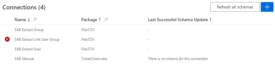

Refresh Schema
A schema is a snapshot of the data structure (metadata) retrieved by a connection. It needs to be refreshed to enable the configuration of entity types and resource types.
Identity Manager refreshes a connection's schema:
after the connection creation;
when clicking on Refresh Schema on the connection's page: only the schema of the current connection is refreshed;
when clicking on Refresh all schemas on the connector's page: all schemas of the connector are refreshed.
In the Connections frame, either the last successful schema update is indicated or an icon is shown if the refresh schema failed.
Some packages don't generate a schema. For these packages, the Refresh Schema button isn't displayed on the connection's page. On the connector's page, a connection without schema is indicated by the sentence "There is no schema for this connection".
The connections' schemas must be refreshed before editing the connector's entity types via the UI,
whether the connections were created via the UI or XML configuration. Otherwise, there will be no
connection table available in the Source
dropdown, so you will not be able to save anything.

Refresh Schemas

Troubleshooting
If the Failed icon appears, then:
Ensure that the schema of the connection is refreshed.
If the schema couldn't be recovered, then:
Ensure that the managed system is properly connected.
Check the connection's settings.
Example: For a CSV connection, ensure that the file paths are written correctly in full, such as
C:/identitymanagerDemo/Sources/Directory.xlsx
You may have a schema that could not be recovered if you work with a system without a direct access to the agent. In this case, schema refreshment will fail but that does not mean that there necessarily is a problem.
Try again from a system that can access the agent.
