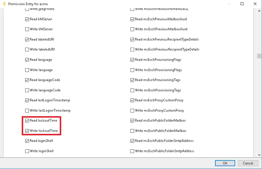

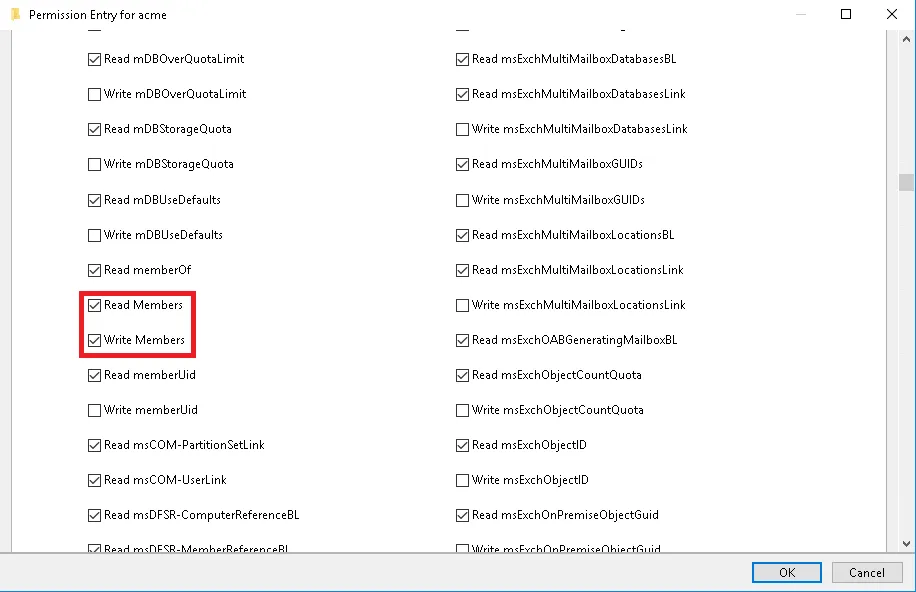

Enable Active Directory Permissions

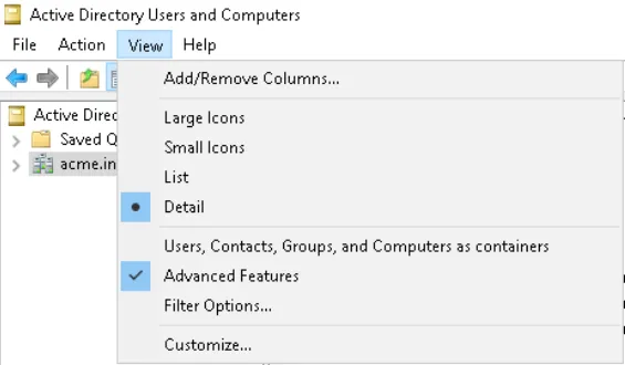

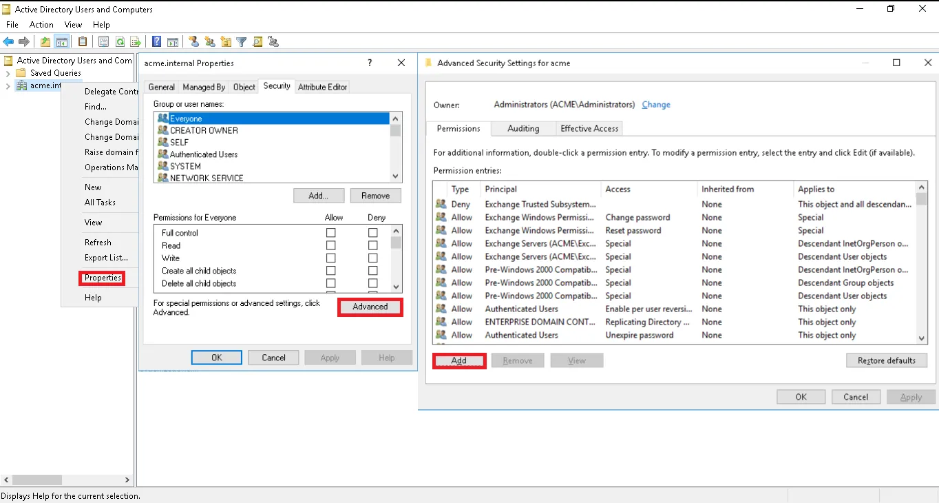

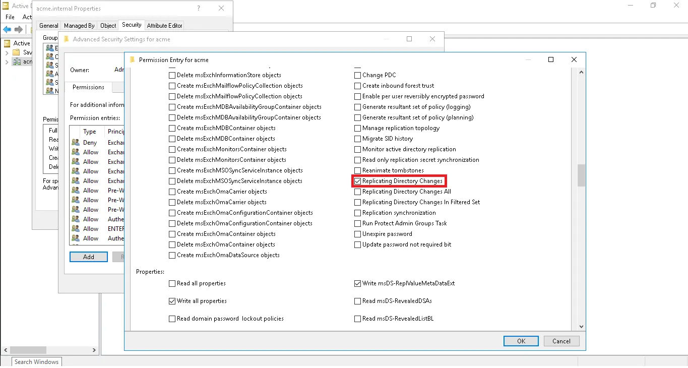

To enable permissions, the Active Directory administrator must do the following:
Step 1 – Check the View details in the Active Directory and Computers.
Step 2 – Open the Advanced Security Settings dialog box for the domain root.
Step 3 – Select the Replicating Directory Changes check box from the list.
Step 4 – To change groups' membership, in the Applies field, select Descendent Group object and select the Read Members and Write Members check boxes from the list.
Step 5 – To Reset Password capabilities, in the Applies field, select Descendent User object and select the Read lockoutTime and Write lockoutTime check boxes from the list.
Administrator rights must not be granted to the service account. Doing otherwise would create a security breach. Administrator rights must only be granted to the target perimeter.
