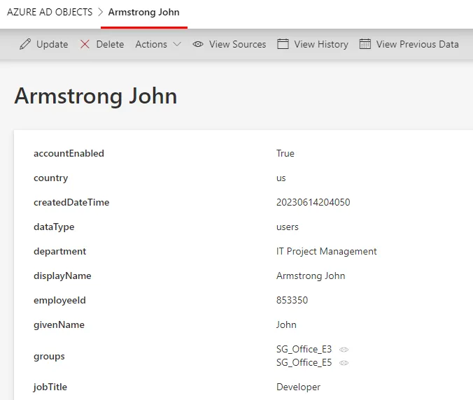

Display the Connector in the UI
This is how the connectors are displayed on the UI.

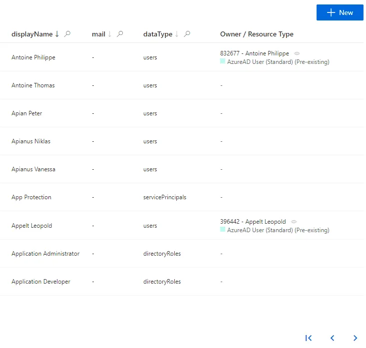

Navigation Properties - Azure AD Connector
Microsoft Entra ID's resources are listed in a table.
For example:
Code attributes enclosed with <> need to be replaced with a custom value before entering the script in the command line.
Conf/MicrosoftEntraID/MicrosoftEntraID UI.xml
<DisplayTable Identifier="MicrosoftEntraID_DirectoryObject" EntityType="MicrosoftEntraID_DirectoryObject" DisplayTableDesignElement="resourcetable" IsEntityTypeDefault="true">
    <Column DefaultSortPriority="1" DisplayBinding="displayName" IsDisplayInSummaryView="true" IsResizable="true" IsSortable="true" CanBeFiltered="true" ColumnSize="4" />
    <Column DisplayBinding="mail" IsDisplayInSummaryView="true" IsResizable="true" IsSortable="true" CanBeFiltered="true" ColumnSize="2" />
    <Column DisplayBinding="dataType" IsDisplayInSummaryView="true" IsResizable="true" IsSortable="true" CanBeFiltered="true" ColumnSize="2" />
</DisplayTable>
Display Table - Azure AD Connector
This is how the resources are displayed on the UI.
