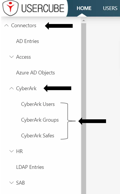

A Menu Item can be added to include a link to the resources list in the left menu in the UI home screen.
Parent menu item
It strongly recommended to gather synchronized resources menu items under parent menu items. This is usually declared in the configuration root folder Nav.xml file.
Example
Conf/Nav.xml
<MenuItem Identifier="Nav_Connectors" DisplayName_L1="Connectors" DisplayName_L2="Connecteurs" ParentMenuItem="Nav" />...
Child menu item
It is strongly recommended to use a new CyberArk Nav.xml file in the SCIMCyberArk connector's folder in order to add the CyberArk SCIM objects menu item.
Example
Conf/SCIMCyberArk/CyberArk Nav.xml
<MenuItem Identifier="Nav_Connectors_CyberArk" DisplayName_L1="CyberArk" DisplayName_L2="CyberArk" ParentMenuItem="Nav_Connectors"> <MenuItem Identifier="Nav_Connectors_CyberArk_User" DisplayName_L1="CyberArk Users" DisplayName_L2="Comptes CyberArk" EntityType="CyberArk_User" /> <MenuItem Identifier="Nav_Connectors_CyberArk_Group" DisplayName_L1="CyberArk Groups" DisplayName_L2="Groupes CyberArk" EntityType="CyberArk_Group" /> <MenuItem Identifier="Nav_Connectors_CyberArk_Container" DisplayName_L1="CyberArk Safes" DisplayName_L2="Safes CyberArk" EntityType="CyberArk_Container" /></MenuItem>...
Adds a new menu item under the Nav_Connectors menu item declared in the root Nav.xml file. This new menu item gives access to the list of synchronized CyberArk SCIM objects.
SCIM CyberArk Menu Items

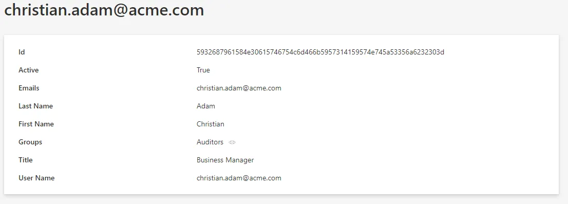

Display entity type
The Display Entity Type describes how a single resource should be displayed.
Example
Conf/SCIMCyberArk/CyberArk UI.xml
... <DisplayEntityType Identifier="CyberArk_User">
<Property OutputType="BasicCollection" Identifier="groups" />
<Property OutputType="BasicCollection" Identifier="containers" /></DisplayEntityType>...
This configuration configures that display for christian.adam@acme.com:
SCIM CyberArk Display Entity Type

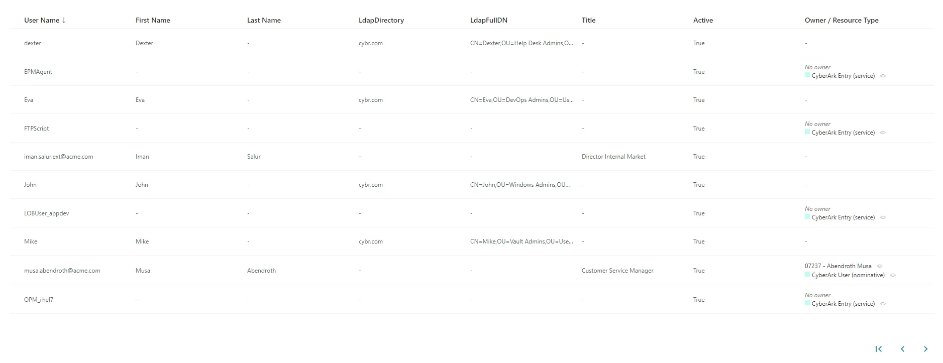

<DisplayTable Identifier="CyberArk_User" EntityType="CyberArk_User" DisplayTableDesignElement="resourcetable" IsEntityTypeDefault="true"> <Column DefaultSortPriority="1" DisplayBinding="userName" IsDisplayInSummaryView="true" IsResizable="true" IsSortable="true" CanBeFiltered="true" ColumnSize="2" /> <Column DisplayBinding="givenName" IsDisplayInSummaryView="true" IsResizable="true" IsSortable="true" CanBeFiltered="true" ColumnSize="2" /> <Column DisplayBinding="familyName" IsDisplayInSummaryView="true" IsResizable="true" IsSortable="true" CanBeFiltered="true" ColumnSize="2" /> <Column DisplayBinding="ldapDirectory" IsDisplayInSummaryView="true" IsResizable="true" IsSortable="true" CanBeFiltered="true" ColumnSize="2" /> <Column DisplayBinding="ldapFullDN" IsDisplayInSummaryView="true" IsResizable="true" IsSortable="true" CanBeFiltered="true" ColumnSize="2" /> <Column DisplayBinding="title" IsDisplayInSummaryView="true" IsResizable="true" IsSortable="true" CanBeFiltered="true" ColumnSize="2" /> <Column DisplayBinding="active" IsDisplayInSummaryView="true" IsResizable="true" IsSortable="true" CanBeFiltered="true" ColumnSize="2" /></DisplayTable>...
configures the following list display:
SCIM CyberArk Display Table
