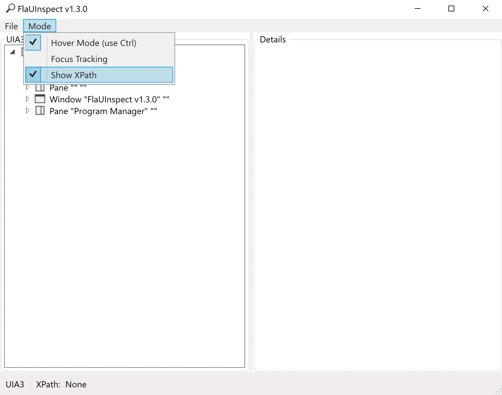

The FlaUI inspection tool shows each window that is open on the computer. To find the element the script is supposed to interact with, it is possible to manually search through the windows, and through the elements. However, the easiest way is to use the Hover Mode, which is accessible in the tool bar by clicking on Mode > Hover Mode (use Ctrl). To see the XPath, click on Mode > Show XPath.
Show XPath

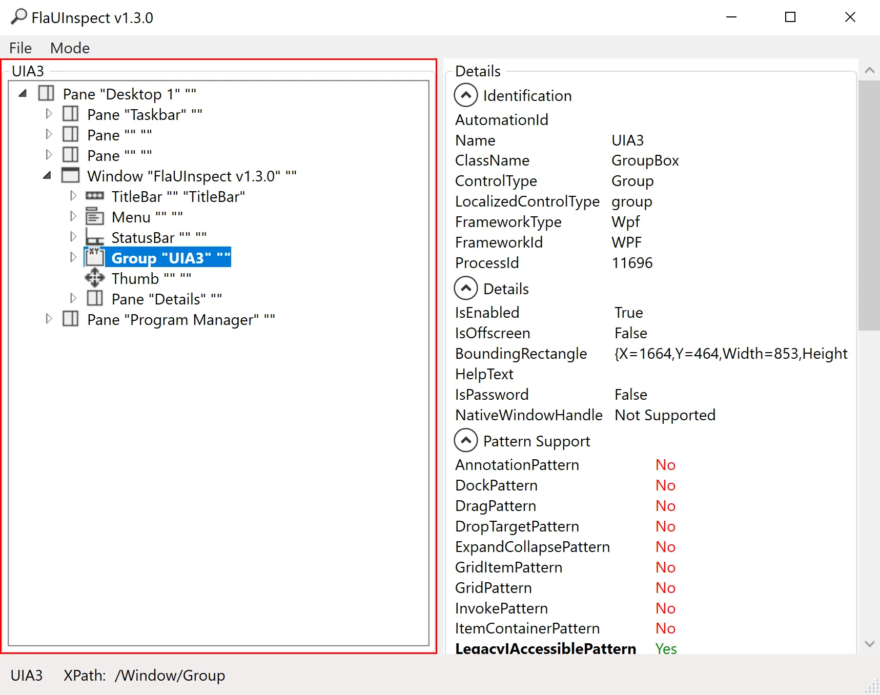

To see the XPath of an element, hover over the element, and press control. A red box should appear around the element, and the FlaUI inspection tool should show the element's information. The XPath should be at the bottom left of the FlaUI element.
Highlight Element
As an example, imagine an application showing a list of files and folders. Targeting a specific file would produce an XPath in the shape of /Window/Pane[3]/Pane/Pane[2]/List/Group[1]/ListItem[1]. The important parts of this path are the beginning and the end. The beginning of the XPath specifies the window. The middle part of the XPath, in most cases, is irrelevant.
The last part of the XPath however, /Group[1]/ListItem[1], is what should be modified to find the right file. Group[1] means the element is in the first file group. ListItem[1] means the element is the first file of the group. Depending on the file explorer view mode, the XPath may end with Edit[1], which means the targeted element is the name section of the file.
As the Window's number may change, it should be specified by name. For the Downloads folder, Window[@Name='Downloads'] specifies the window. The file may not always be at the same position, so it should also be specified. If the file is FlaUInspect.exe, it can be specified with ListItem[@Name='FlaUInspect.exe']. The Group may also change. It is not easy to find the right group, so the best method is to remove the groups, by right clicking, then selecting Group by > (None).
