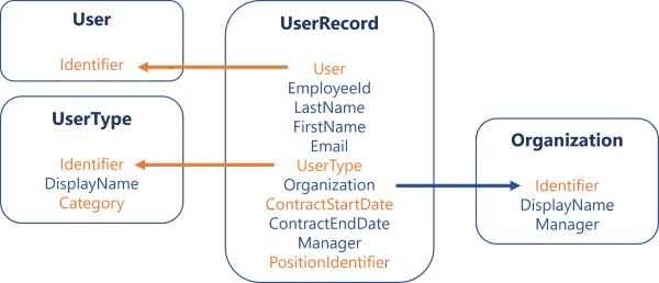

The identity repository is supposed to contain the list of all kinds of identities in the company. Each identity will be represented by a set of properties that are to be used in the calculations for entitlement assignments.
For example, a user can be represented by an identifier and linked to their position which includes the user's employee id, last name and first name, email, user type, organization, etc.
In Identity Manager, the identity repository can look like the following:
See the Identity Repository topic for additional information..

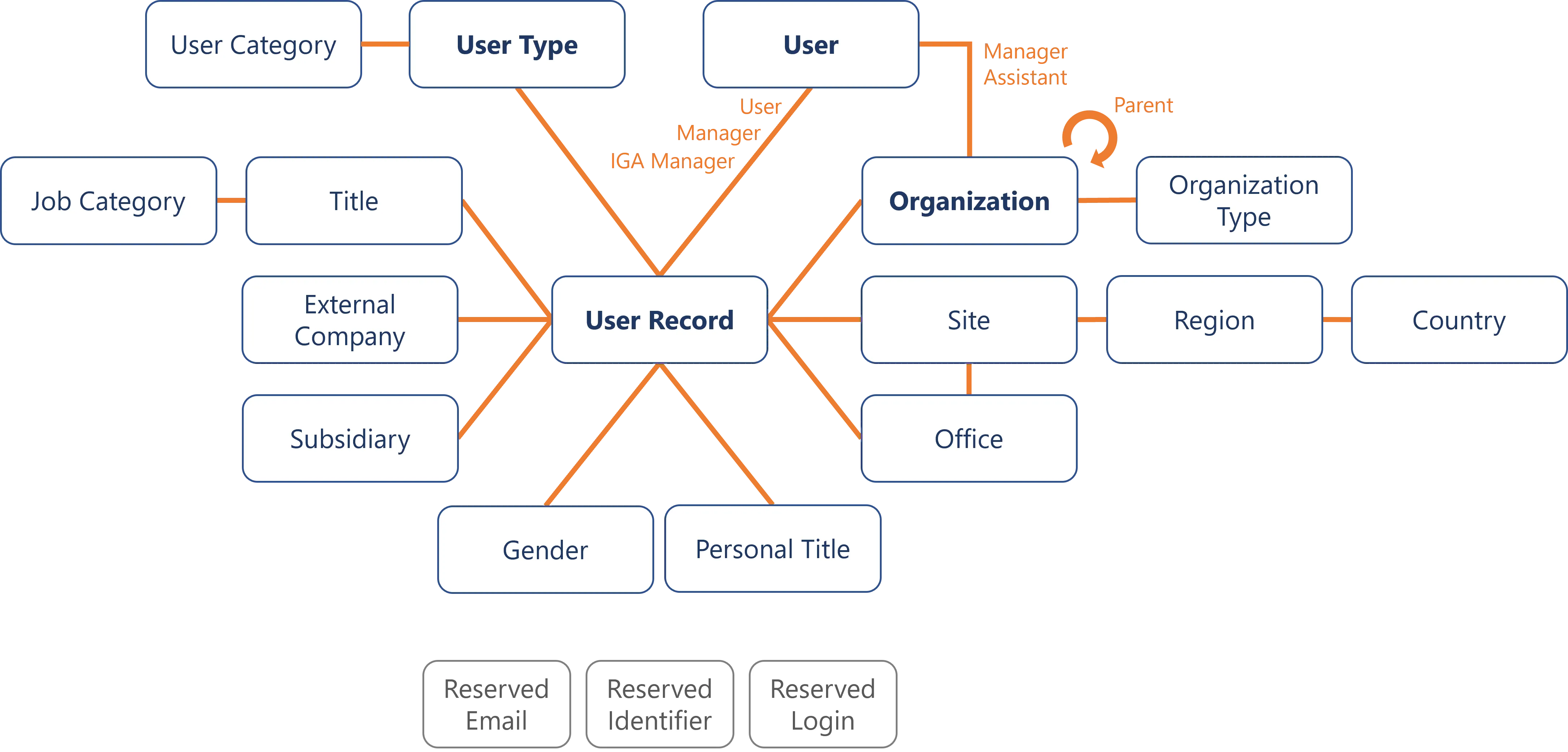

Then, you are going to need a model of the organization's structure where the identities fit in. This model is supposed to provide valuable information for automation and governance features later.
The model is where you are going to identify for example the type of identities you want to manage (such as employees and contractors), the hierarchical relationships between them, the geographical areas they work in, and so on.
Identity Manager has already built a template model for you, in the form of an Excel file. This basic model is customizable and will be adaptable to most organizations. You can customize it simply by writing information from your organization into said Excel file.
Even if you have more specific or exotic needs that aren't met by this model, it is still a good starting point and a good way to quickly start delivering value. We recommend that you start building your project using this model, identify its limits along the way, and enhance it down the road to make it fit your needs more accurately.

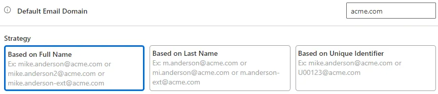

Follow Identity Manager's instructions to configure the generation of a unique email address for all users (who do not have one), based on one of the available options.
Based on Full Name
: replaces all diacritics by the non-accentuated variants; removes all special characters; can add a separator between the first name and the last name if needed (such as.
most often); in case of homonyms, appends a sequence number to the full name. -
Based on Last Name
: uses the first letter of the first name; in case of homonyms, uses more letters of the first name up to the whole first name; in case of homonyms still, appends a sequence number to the full name. -
Based on Unique Identifier
: uses a combination of the unique identifier (defined on the same page) and the email domain.No matter the strategy:
- the default email domain is used when no specific domain is specified on the user's subsidiary;
- emails are generated in a way that lets users keep their email address, even if they move from contractors to employees, or change to another subsidiary.

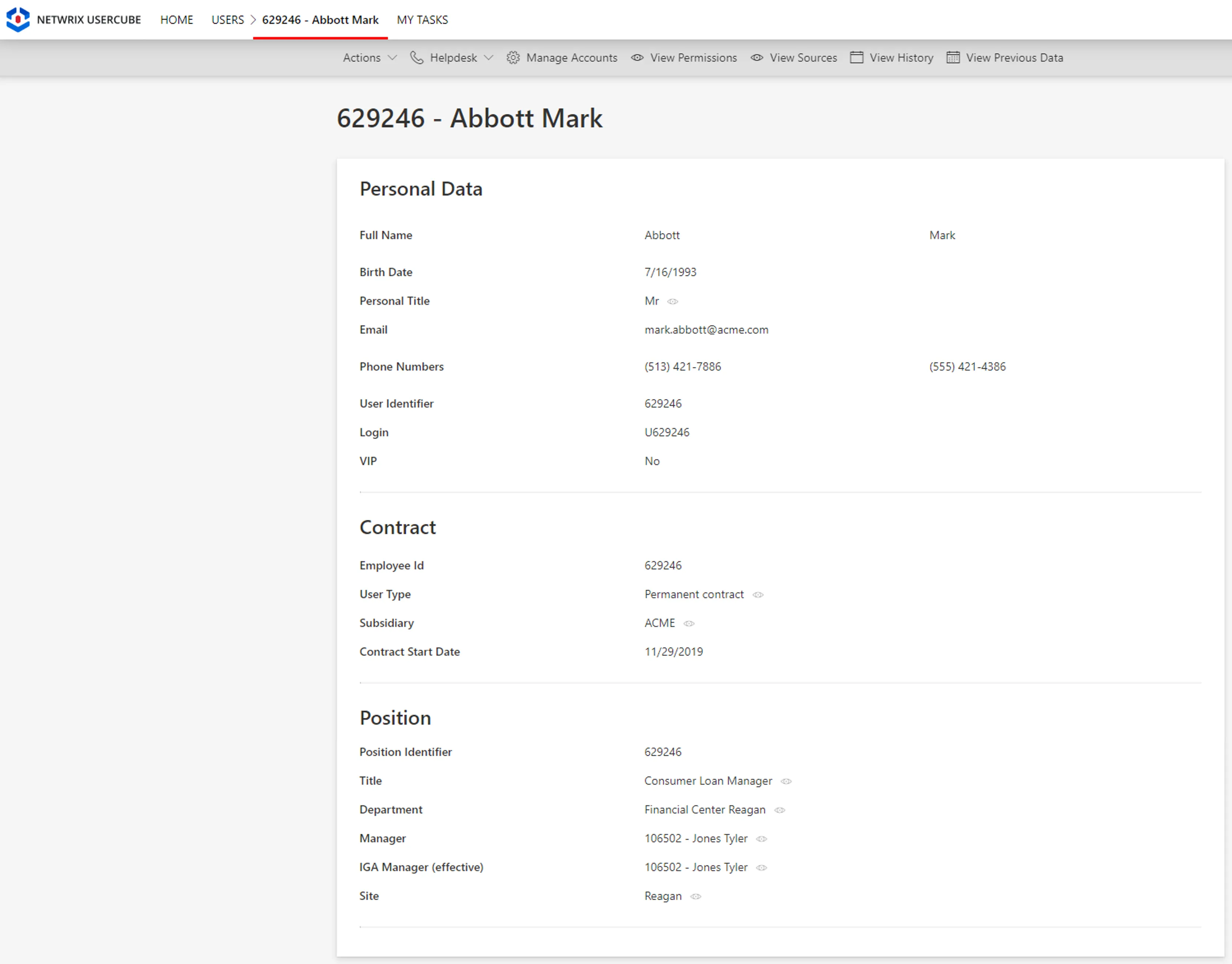

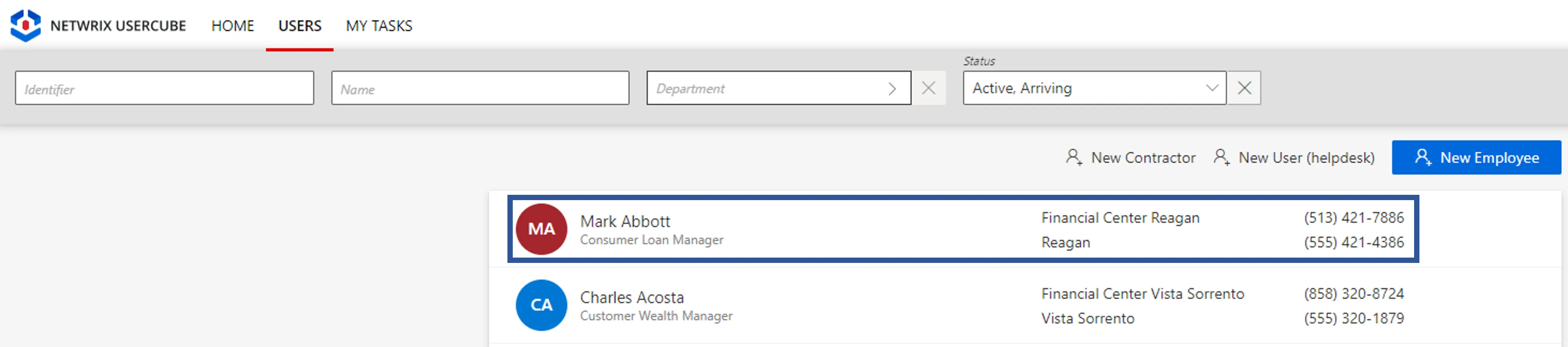

In order to verify the process, add a fictitious employee through the workflows from the UI.
Verify in the directory that the employee's sheet displays the expected values for the configured unique properties.

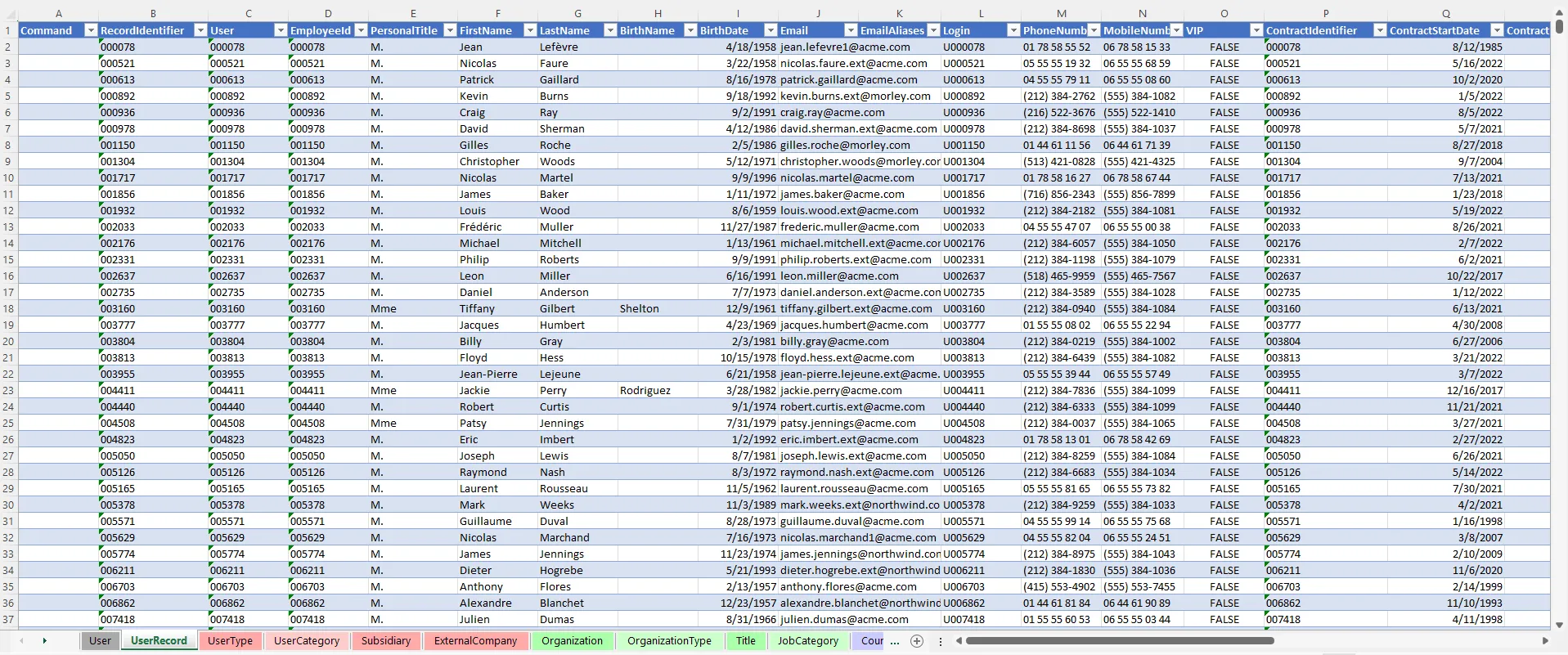

Identity Manager contains a template model, downloadable as an Excel file. Below is an example of a
part of the UserRecord
tab, used in Identity Manager's demo:

On the Workforce > Data Upload page, download the empty Excel template.
Collect identity and organizational data.
If you don't know where to start, identities most often include long-term employees, temporary employees (such as interns and temps) and external contractors. The template contains a
UserType
tab that lists all the types of workers that you want to include, i.e. the usual identities listed just before, but also partners, clients, even applications.Workforce should include obviously all current workers, but also incoming workers, and those who left the organization in the past XXX (time period defined by the rules of the security officer). It is interesting to have past workers in order to understand the process and ensure that they are supposed to be orphaned. See the Review Orphaned and Unused Accounts topic for additional information.
Employees
The workers that are directly employed by the organization usually have their data stored in the HR system.
Contractors
Often third-party workers like contractors are not part of the HR system. Then, there are a few possible solutions to get their data:
- through purchasing department if it doesn't imply any personal data security breach;
- manually with knowledgeable people, for example department managers and assistants;
- through a filter on data from available directories, for example on the email address if it
contains a specific string like
.ext@
; - through an Active Directory extraction with a filter on an attribute that works with a specific part, for example on the employee identifier.
Fill said template with the data you collected.
The Excel file contains several tabs which organize data, but not all tabs and columns are mandatory. You can find more details about the Template Description. Below are the minimum recommended attributes (mandatory in orange):
Click here to download a template example.

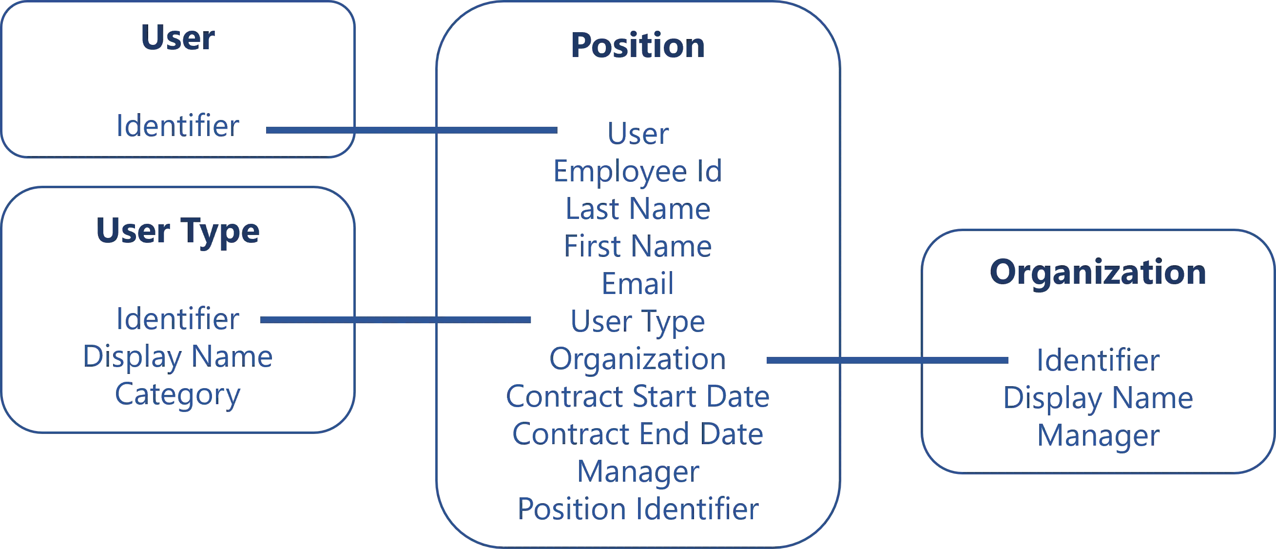

Every object (so every tab) of the directory must have a key, which is an attribute:
- unique, i.e. designed to uniquely identify an object/resource, one key can't be shared;
- immutable, i.e. must not change during the whole lifecycle of the object/resource, even for renaming for example;
- consistent, i.e. identical everywhere the object/resource is specified.
Among other things, a consistent key allows identities to use the same login in all applications. A consistent key is also essential to form the link between identities and the other objects (organizations, titles, etc.).

Now you are able to view users' pages in the directory.
Verify Identities Loading
In order to validate the process:
Check manually a sample in the user directory accessible from the home page. You should verify at least your own sheet and the sheets for your hierarchy.

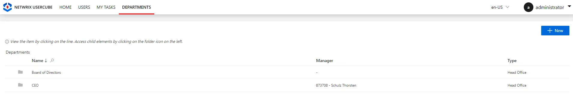

Check that every organization includes a manager. Organizations are accessible from the department directory on the home page.
If the system contains many organizations, then it is also possible to list each organization with its manager through the Query module.
Description of the MS Excel template for the creation of the identities repository.
All tabs contain a column Command
only used at a later stage to modify (massively) identity data.
See the
Update Identities in Bulk
User - Required
An identity is split into two parts, the first one being the parent resource called User
which
represents the user's identity card. It contains the few attributes which shall not change during
the identity's lifecycle. See the
Identity Management topic for
Attribute | Type | Description |
Identifier (required) | String | |
ConsentPhotoUsage (optional) | Boolean | |
IsDraft (optional) | Boolean |
UserRecord - Required
An identity is split into two parts, the second one being the one or several child resources called
UserRecord
which represent the user's positions. Records belong to users and help materialize:
- several positions at once;
- validity periods for positions/assignments unrelated to the user itself;
- position changes.
In other words, records represent the lifecycle of a user inside the company, i.e. multiple contracts, mutation, etc.
Thus, the UserRecord
tab usually holds users' information that might change over time, while the
User
tab groups all records of a given user around its identifier.
RecordIdentifier (recommended) | String | Identifier of the Records. See the Position Change via Records . Note: it can be the same as PositionIdentifier when users can have no more than one contract simultaneously. Note: required when using records. |
User (required) | ForeignKey | Identifier from the User tab. |
EmployeeId (recommended) | String | |
Gender (optional) | ForeignKey | Identifier from the Gender tab. |
PersonalTitle (optional) | ForeignKey | Identifier from the Personal Title tab. |
FirstName (recommended) | String | |
LastName (recommended) | String | |
BirthName (optional) | String | |
BirthDate (optional) | DateTime | |
Email (recommended) | String | |
EmailAliases (optional) | String | Outdated, or any other email address associated with the user. This is used to prevent the re-assignment of a previously used address. |
Login (optional) | String | |
PhoneNumber (optional) | String | |
MobileNumber (optional) | String | |
VIP (optional) | Boolean | True to specify that the user is special/important. |
ContractIdentifier (required) | String | |
ContractStartDate (required) | DateTime | Start date of the user's contract in the company. |
ContractEndDate (recommended for permanent contracts, required for fixed-term contracts) | DateTime | End date of the user's contract in the company. |
AccessesExpirationDate (optional) | DateTime | Date when the user will be deprived of their access rights. |
UserType (required) | ForeignKey | Identifier from the User Type tab. |
Subsidiary (optional) | ForeignKey | Identifier from the Subsidiary tab. |
ExternalCompany (optional) | ForeignKey | Identifier from the External Company tab. |
PositionIdentifier (required) | String | |
PositionStartDate (optional) | DateTime | |
PositionEndDate (optional) | DateTime | |
Organization (recommended) | ForeignKey | Identifier from the Organization tab. |
Manager (recommended) | String | Line manager. Identifier from the User tab. |
IGAManager (optional) | String | Validator of IGA requests. Identifier from the User tab. |
JobTitle (optional) | String | |
Title (optional) | ForeignKey | Identifier from the Title tab. |
Site (optional) | ForeignKey | Identifier from the Site tab. |
Office (optional) | ForeignKey | Identifier from the Office tab. |
OfficeNumber (optional) | String | |
IsMainPosition (optional) | Boolean | |
Suspended (optional) | Boolean | |
StartDate (optional) | DateTime | Start date of the record, used for changes that aren't related to contract and position information, for example a scheduled name change. |
EndDate (optional) | DateTime | End date of the record, used for changes that aren't related to contract and position information, for example a scheduled name change. |
See the Template Description topic for additional information.
Recommendations:
- There is no absolute need for a unique identifier, because Identity Manager can compute one in the next steps.
- Be aware of the difference between a hierarchical manager and an IGA manager who approves entitlement requests. They aren't necessarily the same person.

Organization
A company is divided into organizations, also called departments, such as the board of directors, corporate banking, call center, USA operations, France operations, treasury, etc.

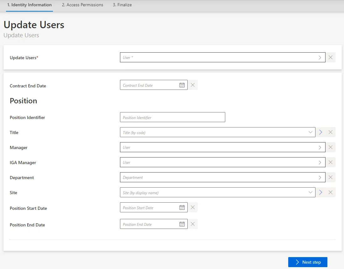

Modify Identity Data
Modify identity data by proceeding as follows, according to the changes to be made:
- either update data individually by using predefined workflows in the UI; See the Update an Individual Identity topic for additional information.
- or perform a same change on several identities simultaneously by using Identity Manager's predefined workflow in the UI; See the Update Identities in Bulk topic for additional information.
- or update data on a massive scale by uploading an external file into Identity Manager, as an incremental version of the identity repository.

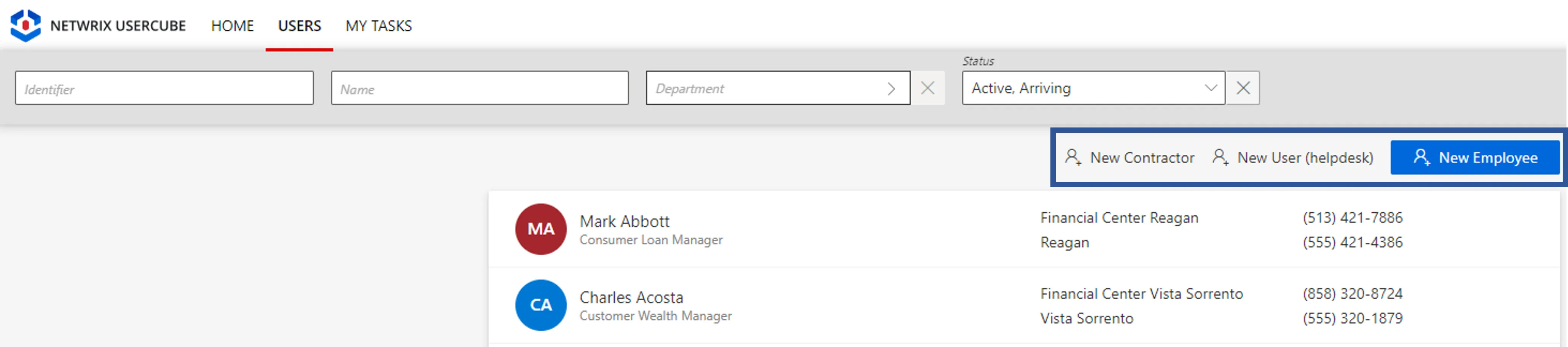

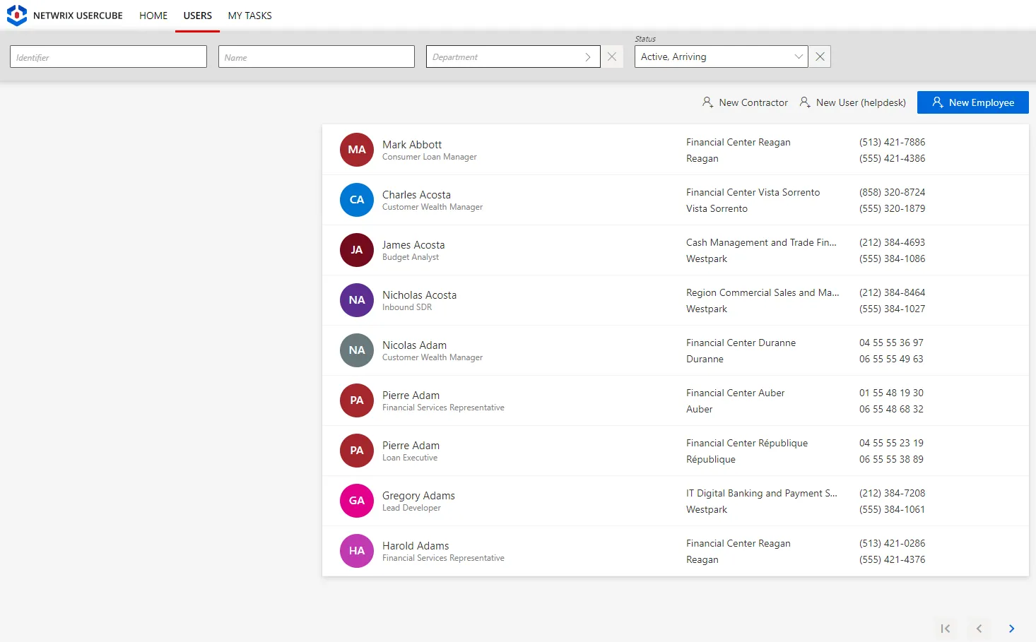

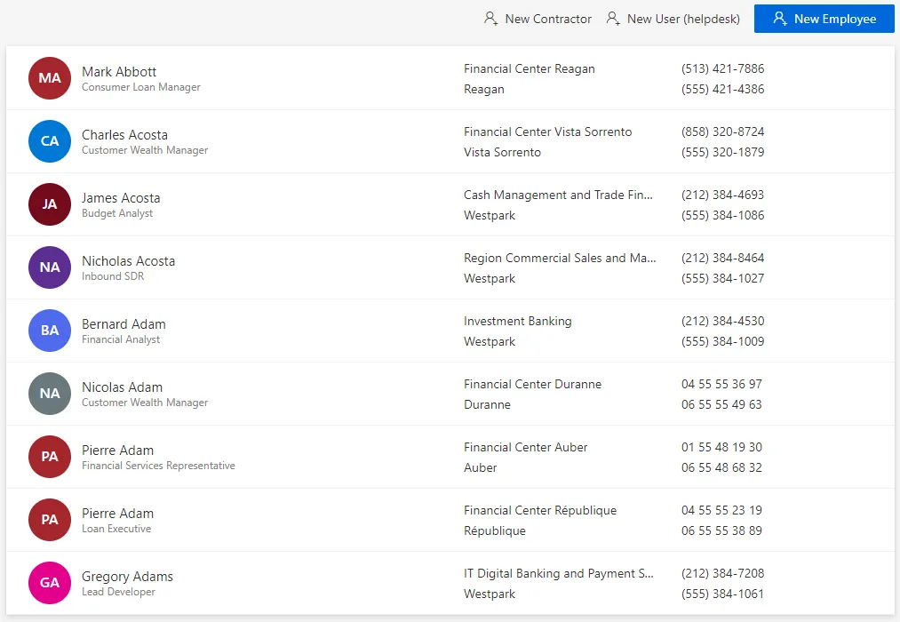

Declare a New Identity
Declare a new worker by proceeding as follows:
Access the user directory from the home page.
According to the type of the user to be declared, click on the corresponding button.
Follow the workflow's instructions to fill the form with the user's data, choose the user's entitlements from your role catalog and send the request. See the Create Roles in the Role Catalog topic for additional information.

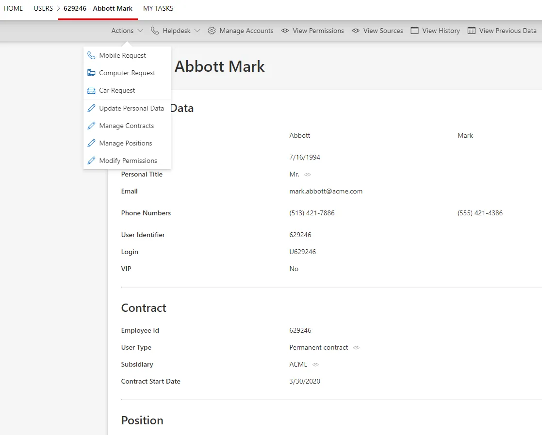

Act on an Existing Identity
Act on an existing identity by proceeding as follows:
Click on the user to be modified.
Click on Actions or Helpdesk to select the action to perform.
Follow the workflow's instructions.
If the workflow has been configured in this way, the update request may require a review. In this case, sending the request triggers the display of said request on the My Tasks screen for the reviewer, while the state of the request is pending. In this case, the requested updates will be displayed in Identity Manager only after the request has been reviewed.
Verify Data Update
In order to verify the process, check that the right data is displayed in the directory for the involved user.

Update Data in Incremental Mode
Mass update identity data (in incremental mode) by proceeding as follows:
Access the directory connector from Connectors on the home page, in the Configuration section.
On the connector's page, choose the connection corresponding to identities.
In the connection's settings, download the empty Excel template.
Fill only the data to be modified, specify the unique identifier for each entry (for correlation purposes), and fill the column
Command
, which can take a few available inputs:-
Add
to incorporate new attributes; -
Modify
to change existing attributes;Attributes can be emptied using the value
NULL_NULL
Delete
to remove attributes from the datamodel;Instead of using
Delete
, you can scan the data model to exclude unused attributes. See the Create the Workforce Repository topic for additional information. -
Merge
to input an identity's data and modify the corresponding attributes if said identity already exists, create a new identity otherwise.For example, if a few users switch working sites, then the modification is performed by filling the file only with said users' identifiers and new sites. Fill the column
Command
withModify
. The rest will not be changed.
Ensure that the field
Path (Incremental mode)
is filled with the path of the source file. -
Click on Upload and choose the file you modified with new data.
Click on Check Connection to verify the path.
Click on Save & Close.
Back on the connector's page, launch synchronization. See the Synchronize Data topic for additional information.
Be cautious about thresholds.
Verify Data Update
In order to verify the process:
User
directory accessible from the home page. You should verify at least your own sheet and the sheets for your hierarchy. -
Check that every organization still has a manager. Organizations are accessible in the
Department
directory accessible from the home page.If the system contains many organizations, then it is also possible to list them with their managers through the Query module.
Create reports with indicators on the workers number per type or per organization for example (through Identity Manager' predefined reports, the Query module or Power BI), in order to ensure that Identity Manager's content sticks to reality. See the Generate Reports topic for additional information.

Update
Perform multiple updates by proceeding as follows:
Click on Multiple Updates, accessible from the directory on the home page.
Follow the workflow's instructions to perform the change, assign new entitlements if needed, and send the request.
