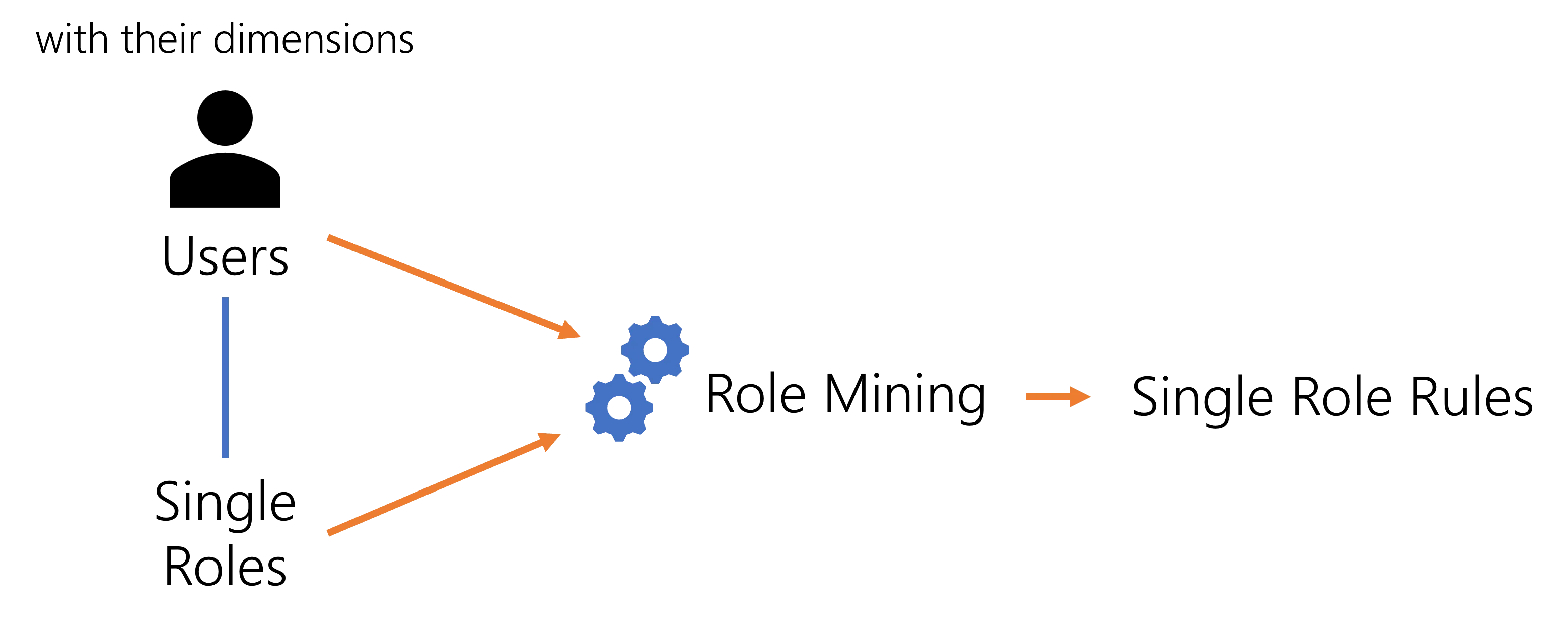

Now that users received their roles, the role mining tool can analyze these assignments and deduce Single Role Rule which will assign single roles to certain users matching given criteria.
Schema - Role Mining

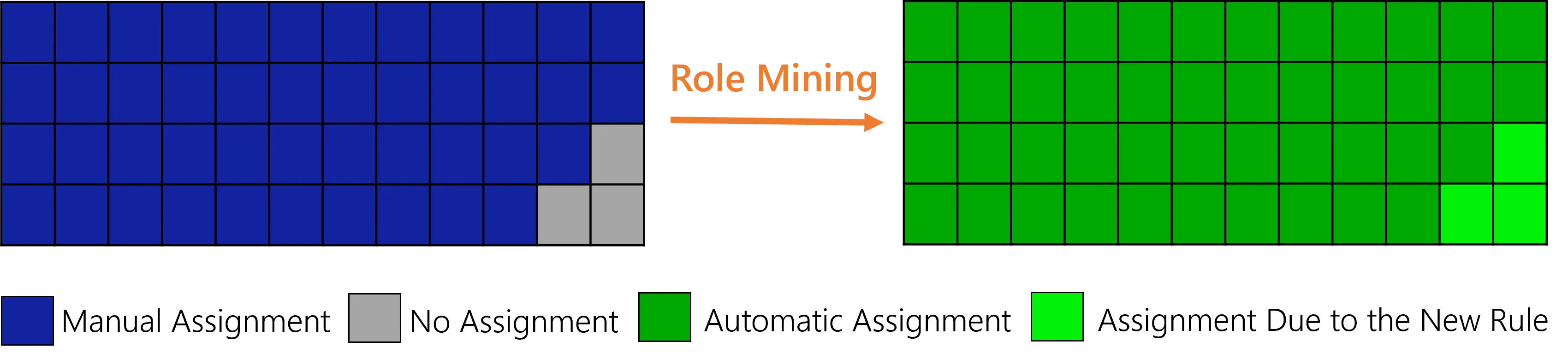

Role mining is a Machine Learning process. It is a statistic tool used to emphasize the dimensions that constitute the key criteria for existing role assignments. See the Conforming Assignments topic for additional information. It detects the most probable links between identities dimensions and their roles in order to suggest the appropriate entitlement assignment rules.
For example, suppose that 80% of Netwrix Identity Manager (formerly Usercube) workers in Marseilles have access to an application "App". Then, role mining is most likely to recognize the working site as a relevant dimension, and suggest to create a rule that gives the "App" access to users whose site is Marseilles.

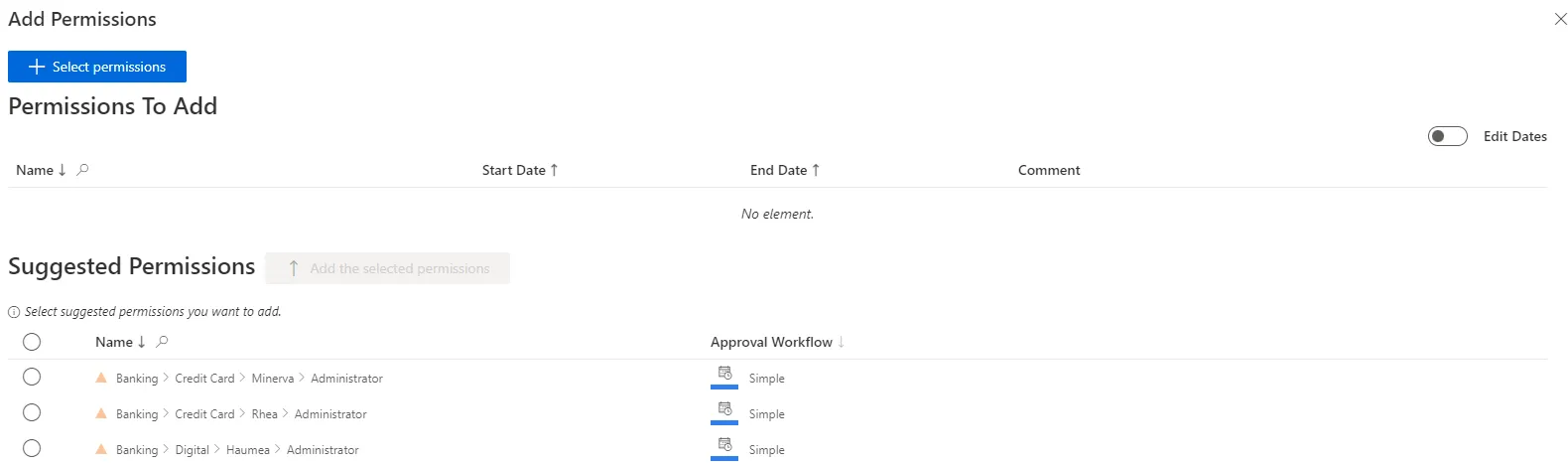

  2. suggested rules, i.e. rules which don't assign roles directly, but suggest them during an entitlement request for a user.
    Suggested
You can generate both automatic and suggested rules for the same role, with different precision levels and different approval workflows.

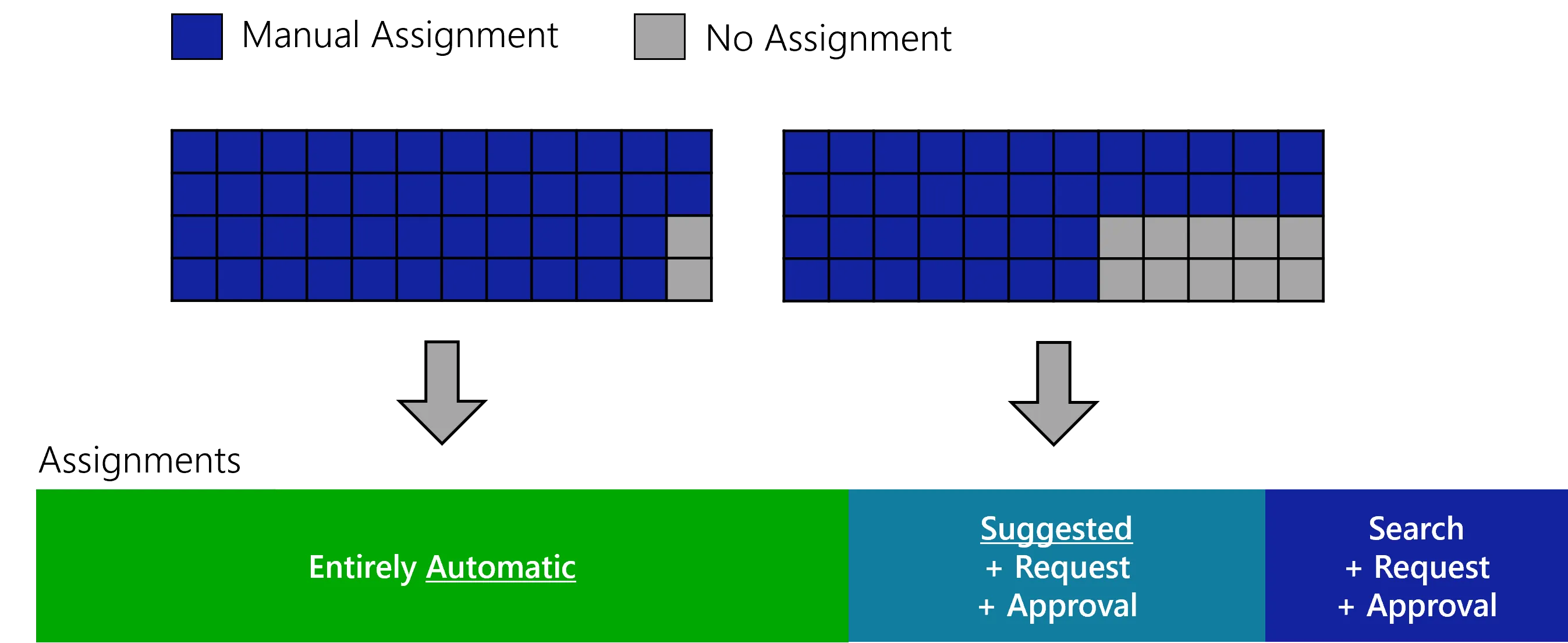

Consider an organization where an unknown ratio of users have a given role. Using the precision settings, we can create a mining rule to generate automatic assignment rules when the ratio is above 95% and a second mining rule to generate suggested assignment rules when the ratio is between 75% and 95%.
Rule Types
You can also differentiate entitlements according to their sensitivity, for example require additional reviews following the request of a sensitive entitlement:
Rule Types - Sensitivity
The automation of entitlement assignments according to sensitivity brings greater confidence in basic entitlements assignment which won't need to be certified anymore. Thus, automation lets certification campaigns focus on more sensitive entitlements.
Role mining should be performed first for automatic rules as they are stricter precision-wise. Thus, automatic rules should always have priority over suggested rules (via the Priority setting).

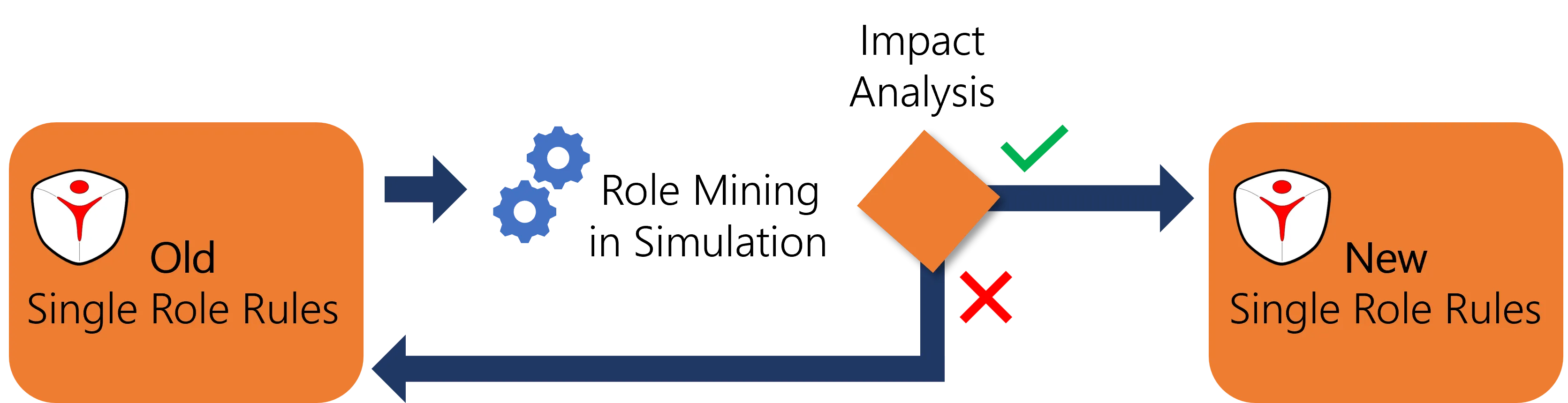

Be aware that you can configure the Get Role Mining Task to generate role assignment rules either directly or in a Simulation.
Simulating the results of role mining allows a knowledgeable user to analyze the impact of role mining on the role model, before applying them.
The simulation tool gives another point of view on the role model as it emphasizes the changes.
Identity Manager recommends simulating role mining before applying the results.

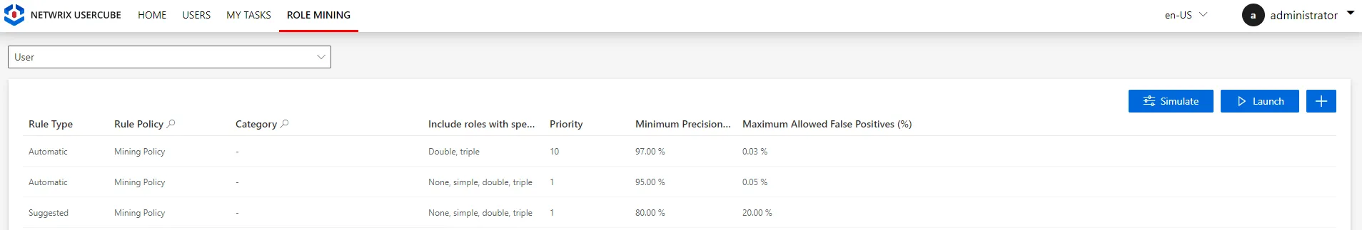

  1. On the home page in the Configuration section, click on the Role Mining button.
    Home page - Connectors
    You will see all existing mining rules.
  2. Click on the addition button at the top right and fill in the fields.
    Addition Icon
    New Mining Rule
    • Policy: Create a Policy in which the mining rule exists.
    • Entity Type: Create an Entity Type on which the mining rule is applied, i.e. the entity type targeted by role mining's entitlement analysis.
    • Category: Create a Category containing the roles targeted by role mining's analysis.
    • Include roles with specific validations: includes in role mining's analysis the roles requiring zero and/or one and/or two and/or three validations.
    • Exclude Role from Mining: ignores the specified roles during the mining process triggered by the next mining rules (in terms of priority).
    • Rule Policy: Create a Policy in which the single role rules will be generated.
      Netwrix Identity Manager (formerly Usercube) recommends using a policy dedicated to role mining in order not to remove existing assignment rules.
    • Rule Type: type of the generated single role rules, which defines the type of role assignment that can be: Suggested so that the resource type is listed among suggested permissions in the permission basket of users matching the criteria during an entitlement request, suggested assignments must be selected manually to be requested; or Automatic so that the resource type is automatically assigned to users matching the criteria; or Automatic but with validation so that the resource type is listed in the permission basket of new workers, these assignments can still be modified.
    • Priority: priority order of the mining rule. Identity Manager applies mining rules one after the other in descending order.
    • Minimum Precision: minimum authorized percentage of correct role assignments, considering both the roles that are assigned to users who should have them, and the roles that are not assigned to users who should not have them.
      NETWRIX recommends around 99.5%, to be lowered when working on a sensitive application and/or a large user population, and vice versa.
    • Maximum Allowed False Positives: maximum authorized percentage of false positive assignments, i.e. roles that are assigned to users who should not have them.
      NETWRIX recommends around 1%, to be lowered when working on a sensitive application and/or a large user population, and vice versa.
    Enlarge the number of managed entitlements by tolerating errors:
    Automation reduces the error rate by avoiding human mistakes. Errors can still occur such as "false positives", i.e. users receiving inappropriate entitlements, and thus creating security issues. However, experience shows that a slight error tolerance in role mining can highly benefit automation.
  3. Click on Create and see a line added on the rules page.
  4. Click on Simulate to perfom role mining in a simulation. See the Perform a Simulation topic for additional information.
