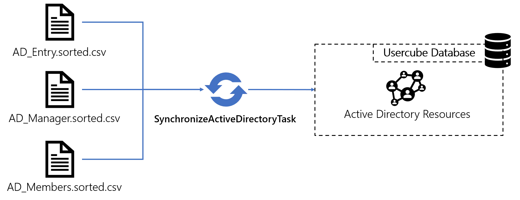

Upward Data Synchronization
Upward Data Synchronization (Sync Up) is the process that copies relevant managed systems data into Identity Manager's resource repository and translates them into resources that match the configured Entity Model. See the Entity Model topic for additional information.
Performing a Sync Up allows the user to:
- integrate the managed systems state with Identity Manager. The copied data serves as the basis for the assignment computation;
- check that previously edited provisioning orders have been accurately executed;
- ascertains differences between the real managed system state and the Assignment Policy theoretical state.
Overview
A scheduled sync up per managed system
Sync Up is performed regularly, at least every day, as a set of Tasks & Jobs .
A Sync Up is planned for every managed system that interact with Identity Manager.
A Sync Up is associated with a Connectors.

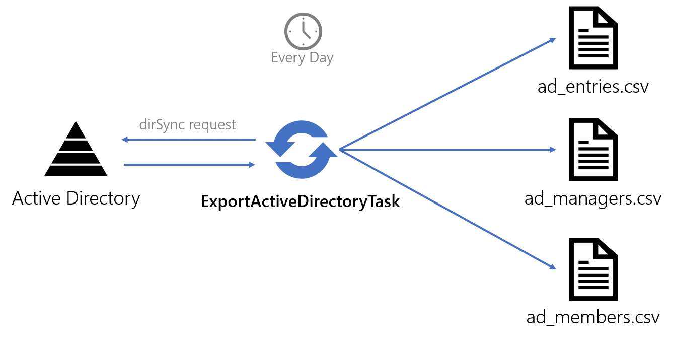

Three sync up mode
Identity Manager provides three distinct synchronization algorithms:
- incremental
- complete
- initial
Complete is most straightforward one. A complete__Sync Up loads the managed systems' data into Identity Manager as-is, replacing entirely the currently held data.
As it involves sending large amounts of data over HTTP between Agent and Server, complete execution time can be quite large.
To improve the Sync Up execution time, Identity Manager provides the incremental mode. This mode only considers changes made to the managed systems since the last Sync Up. Those are applied to the Identity Manager's database. Only changes are sent through the network, instead of whole data files, which allows the Sync Up execution time to be greatly reduced.
Changes are computed either by the managed system itself, given such capabilities are available, or by a Identity Manager's Agent.
However, the incremental mode cannot be 100% reliable for two reasons.
First, it relies on external inputs that are not directly controlled by Identity Manager. Second, it only exports changes based on the managed system state, not on Identity Manager's database state.
External perturbations could cause slight differences between the database's state and the managed systems'. Order can be restored by running a complete Sync Up regularly. A complete Sync Up ensures the database is in a stable state, faithfully reflecting the managed system state, before resuming the incremental Sync Up iterations.
Safeguards are also implemented to avoid accidental overwrites, that would be caused by an empty or incomplete input.
Finally, the initial__Sync Up is designed to be used the first time a managed system connects to Identity Manager. Just as the complete, it loads the data as a whole. But, unlike the complete, it does not overwrites the currently held data and does not provide any safeguard. The initial mode provides a quick way to perform the first Sync Up. The trade-off is security: initial__Sync Up should only be used the first time a managed system connected to Identity Manager and the database is empty, as far as this connector is concerned. Launching the Initial Sync Up twice would actually load the same data twice whereas launching the complete twice would have the same effect as launching the complete once.
