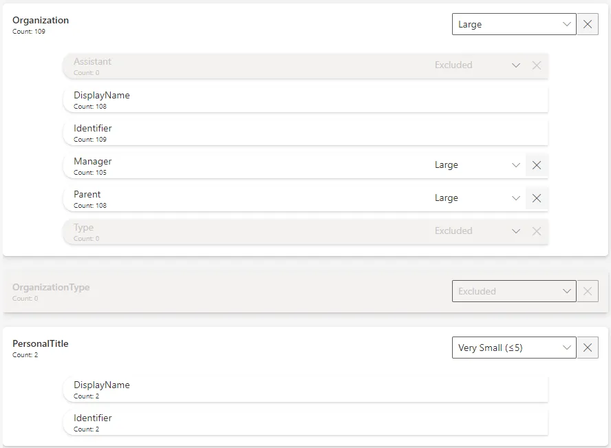

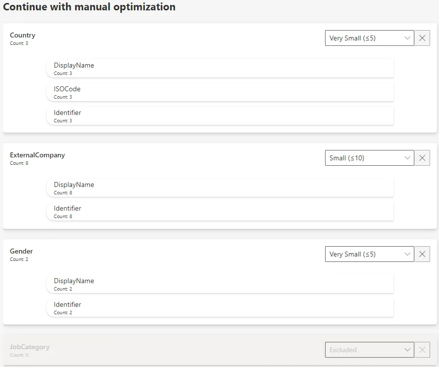

Identity Manager counts the entries for each attribute and suggests a quantification:
- Empty attributes are deactivated as they should be excluded to simplify the data model.
- Non-empty attributes are quantified (e.g. small, large, etc.) to be displayed in the UI's forms optimally (e.g. dropdown list, search tool, etc.).
Observe the result and adjust manually the data model if needed, by clicking on the properties.
While Identity Manager suggests a structure for the data model, the choice is yours to activate/deactivate any property.
For example, empty attributes should be excluded to simplify the data model. However, you can choose to keep an empty property anyway if you know that you want to fill it in later.

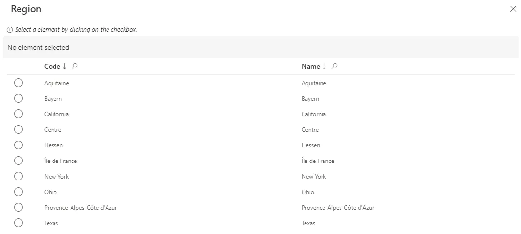

Navigate within Identity Manager to find a workflow using the test field. Observe the displaying mode in the UI.
Our
Statefield must be filled in during the creation of a new site. It can be filled by opening a pop-up and choosing the region in the list.
