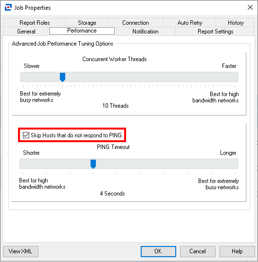

  3. If the server cannot be pinged, clear the Skip Hosts that do not respond to the PING box by following the steps below:
    1. Right-click the newly created DropFSHostData job.
    2. Select Properties.
    3. Click the Performance tab.
    4. Clear the Skip Hosts that do not respond to the PING box.
      Performance tab with Skip Hosts that do not respond to the PING option

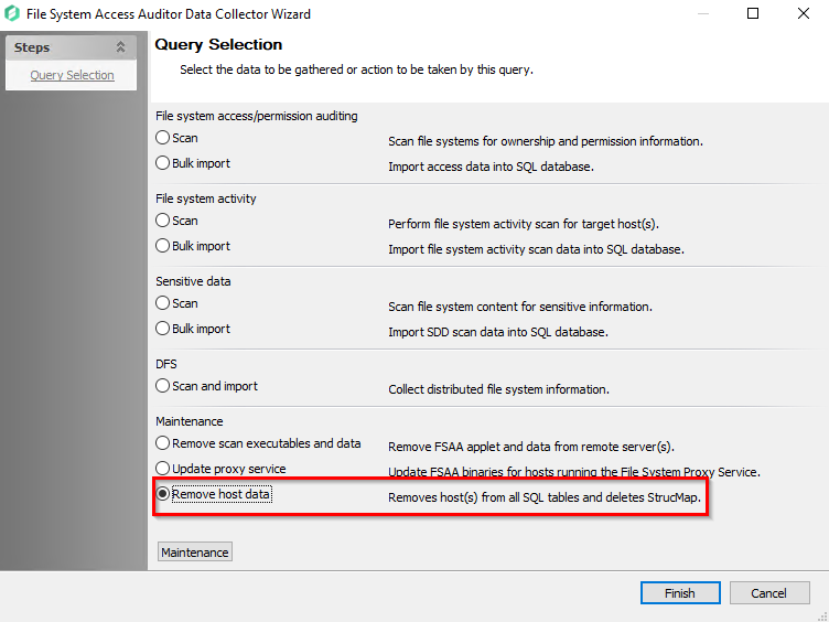

  6. On the Data Source tab, use the dropdown to set the Data Collector to FILESYSTEMACCESS then click Configure.
  7. On the Query Selection page of the File System Access Auditor Data Collector Wizard, select the option for Remove host data under the Maintenance section, and then click Finish.
    Query Selection page with Remove host data option

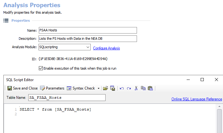

  10. Set the Analysis Module to SQL scripting then click Configure Analysis.
    1. Set the Table Name to SA_FSAA_Hosts.
    2. Use the SQL script:
      SELECT * from [SA_FSAA_Hosts]
      SQL scripting with SA_FSAA_Hosts table
  11. After saving and closing the analysis, right-click the analysis and select Execute Analyses. This will list all the file system hosts in the Access Analyzer database under the Results node of the job.
