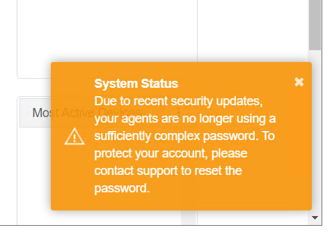

Versions of the Hub from 7.7.4 will warn if any agent is using the default password by displaying the following warning in the bottom right of the screen.

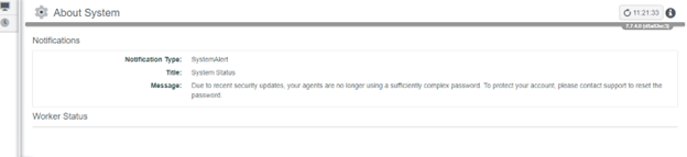

The User Notifications page will also display the warning.
